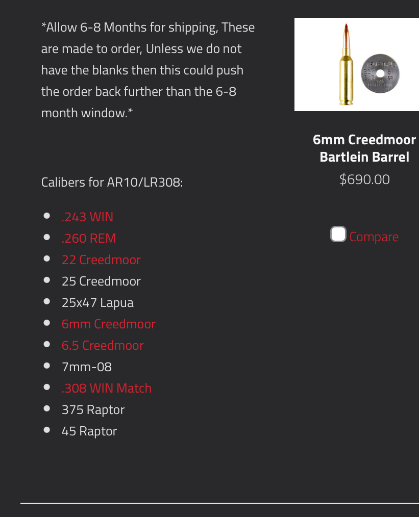

    I’m looking into this but there’s a paucity of AR10 barrels out there unfortunately. Seems McGowen will spin one up though. Carbon 6 uses McGowen blanks apparently. Stand Alone carbon barrels, which I’m not familiar with. You got any other leads?
    Give Craddock Precision a call. I sent them my .308WIN AR10 upper and they sent it back to me with a Bartlein 6mm Creed barrel all setup. And they chamber 25 Creed as well.
    I like that. Headspaced a bolt too I assume?
    I just didn’t see 25 CM on their site. I’ll definitely call.
    They can provide a bolt, but I used a JP high pressure bolt.
    25C is on their list of AR10 chambers
