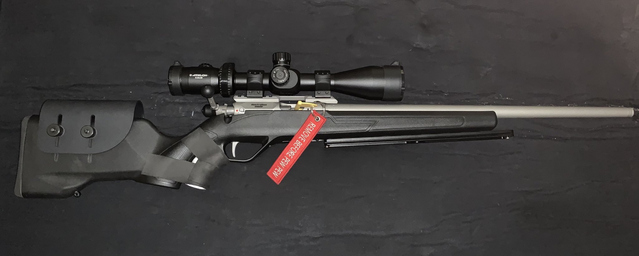

    My daughter has one, it’s a shooter for sure. Very accurate! Not as accurate as our Vudoo, Izhmash or the Anschutz. But better than any Savage or CZ I have had. I have not played with a Tikka.
    The stock trigger does need the spring reduction kit.
    Also to get it to fit my daughter I had to get creative with some add ons, see pic below. The oem plastic stock is a hunter style which she does not shoot well.
    What really needs to happen with this rifle to make it take off is some chassis manufacturer needs to make a chassis for it. If that happened it would really take off. It is a great rifle.
