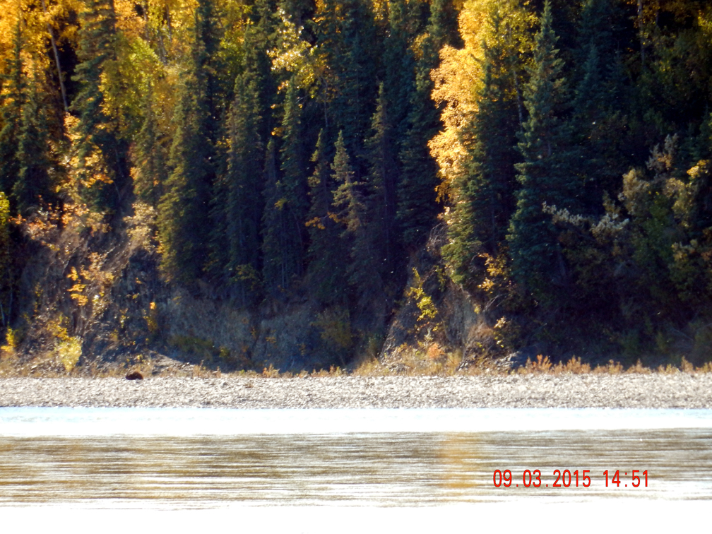

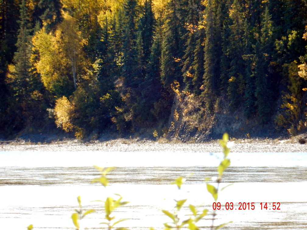

Here's a couple photos using a 30x optical on a Nikon 9700s. Took those just beyond the 1000 yard disc on the Koyukuk from moose camp.
  • 9700S at 30x optical (ED lens) over 1050 yards downrvier against the sun.jpg
Reactions: pewpewfever
