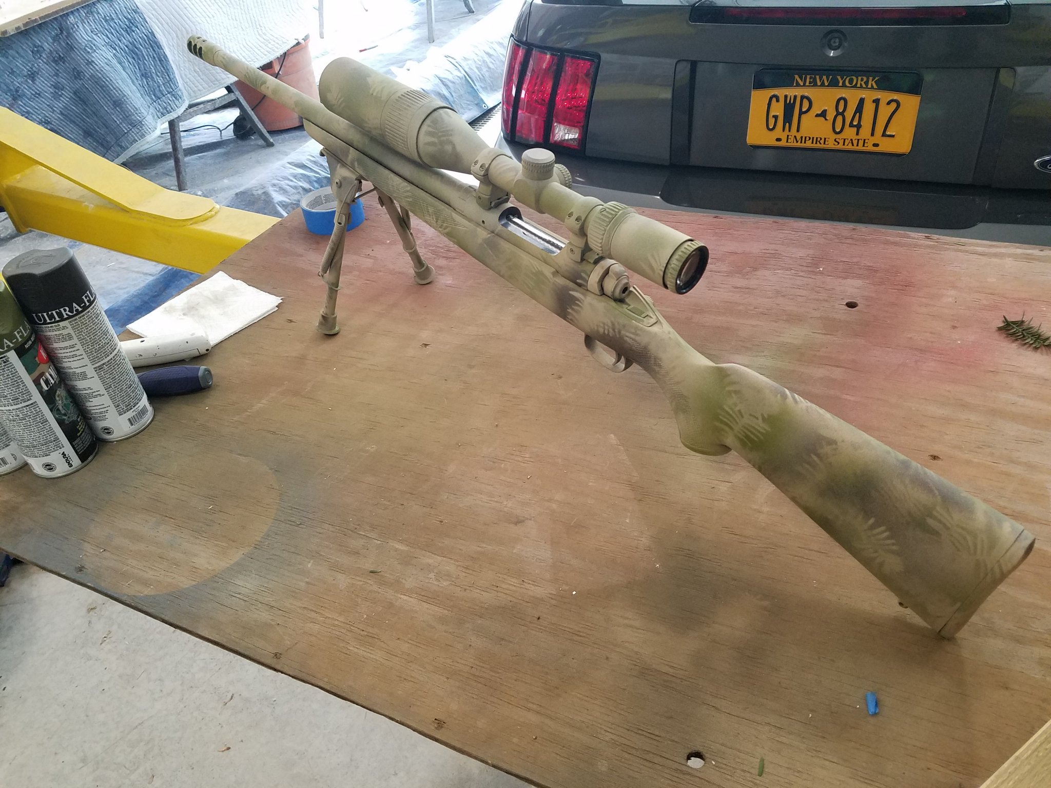

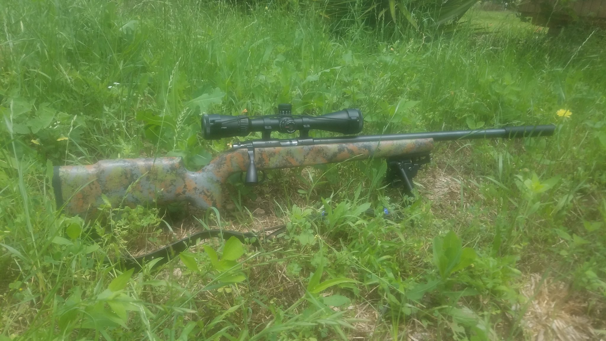

What I did to paint my guns is lay down a base coat, sprinkle broom straw, add contrast, and repeat. Then if you want to break it up even more dip a paint sponge in something and LIGHTLY dab it on there.

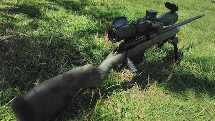

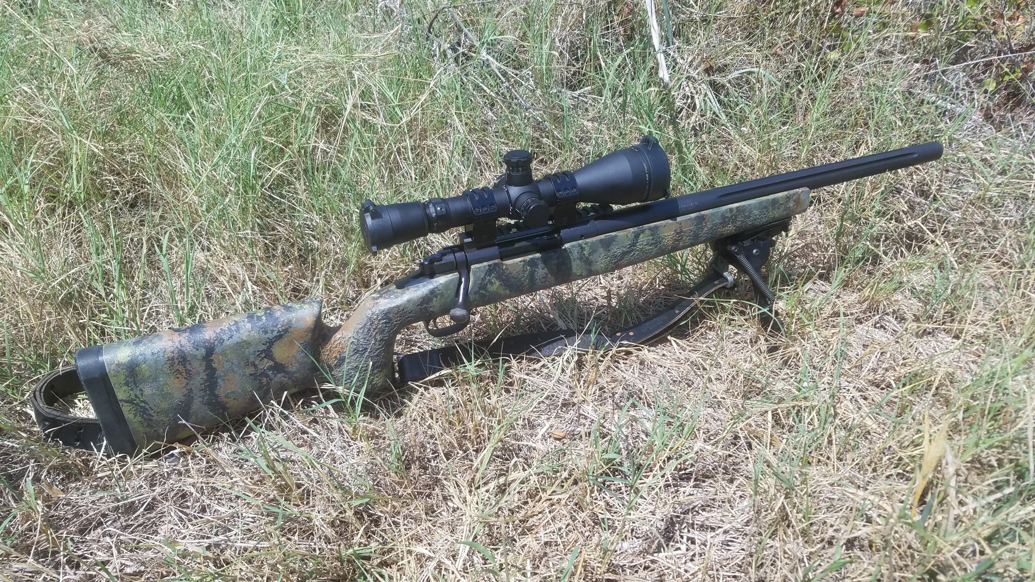

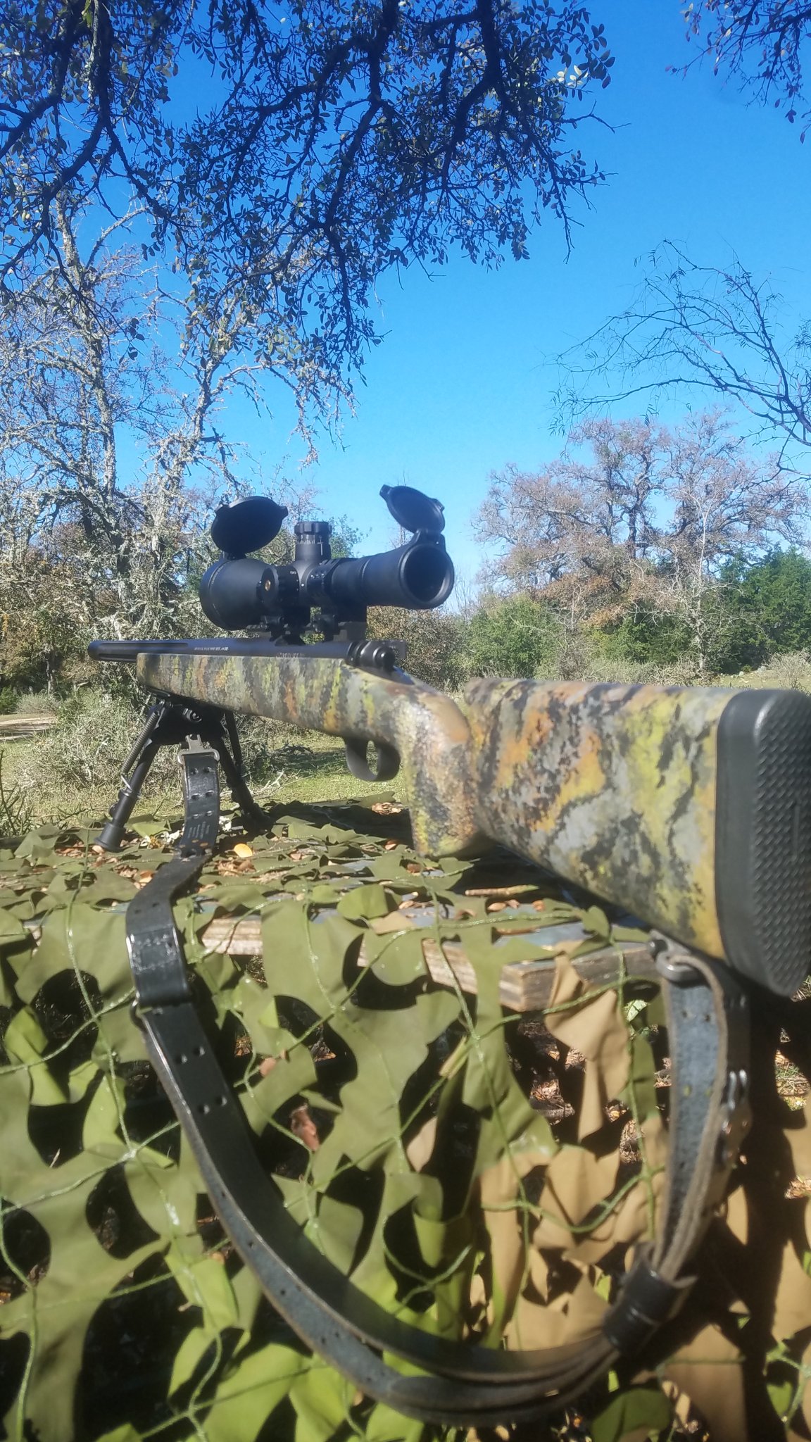

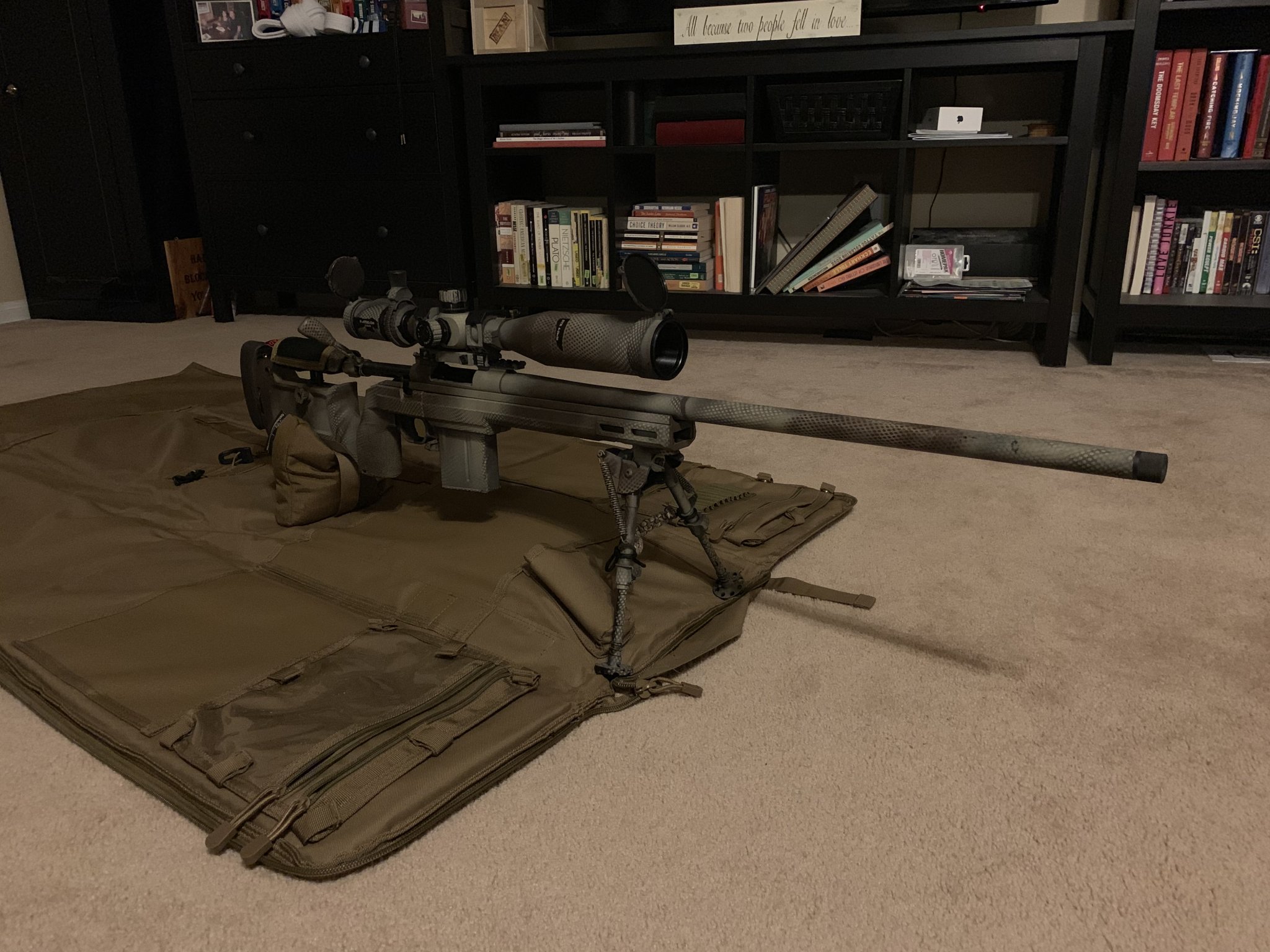

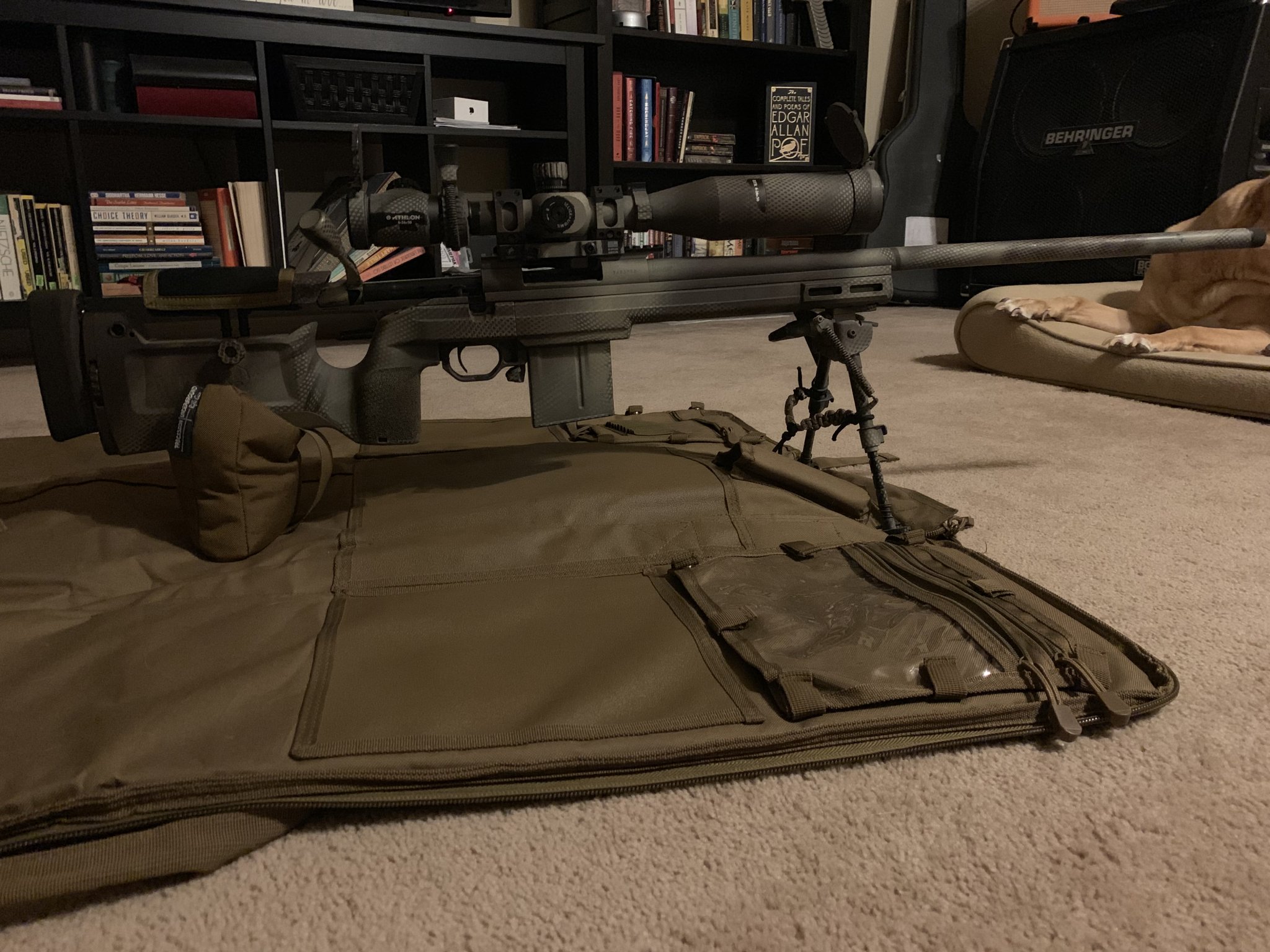

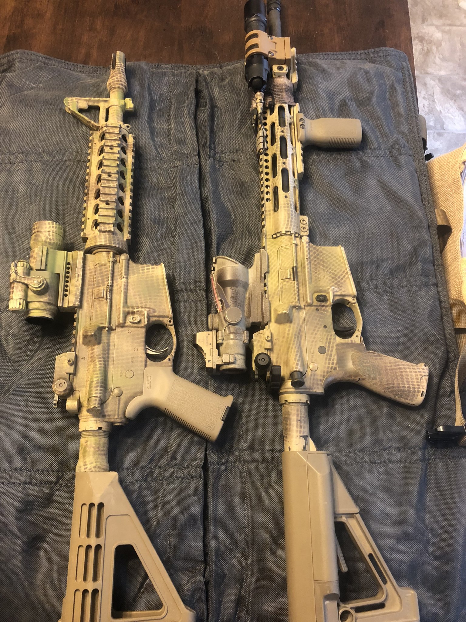

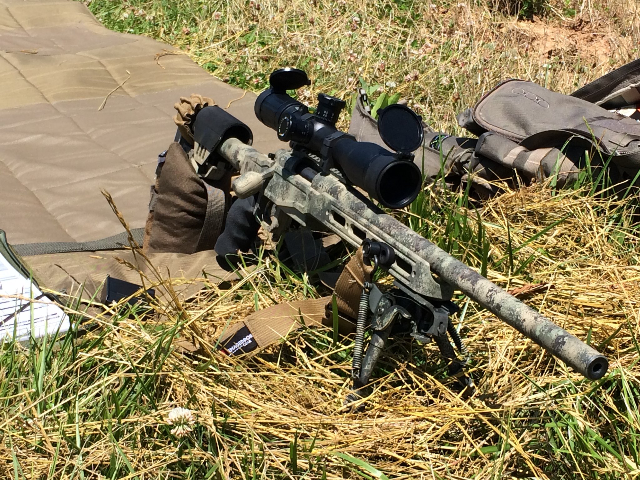

I like to do a light base color, and then do a combo of what some others have suggested. I use whatever leaves/grass/foliage i find in the nearby area, and then also use some extra netting and add in the darker colors (greens and browns). I like the way it turns out most of the time.

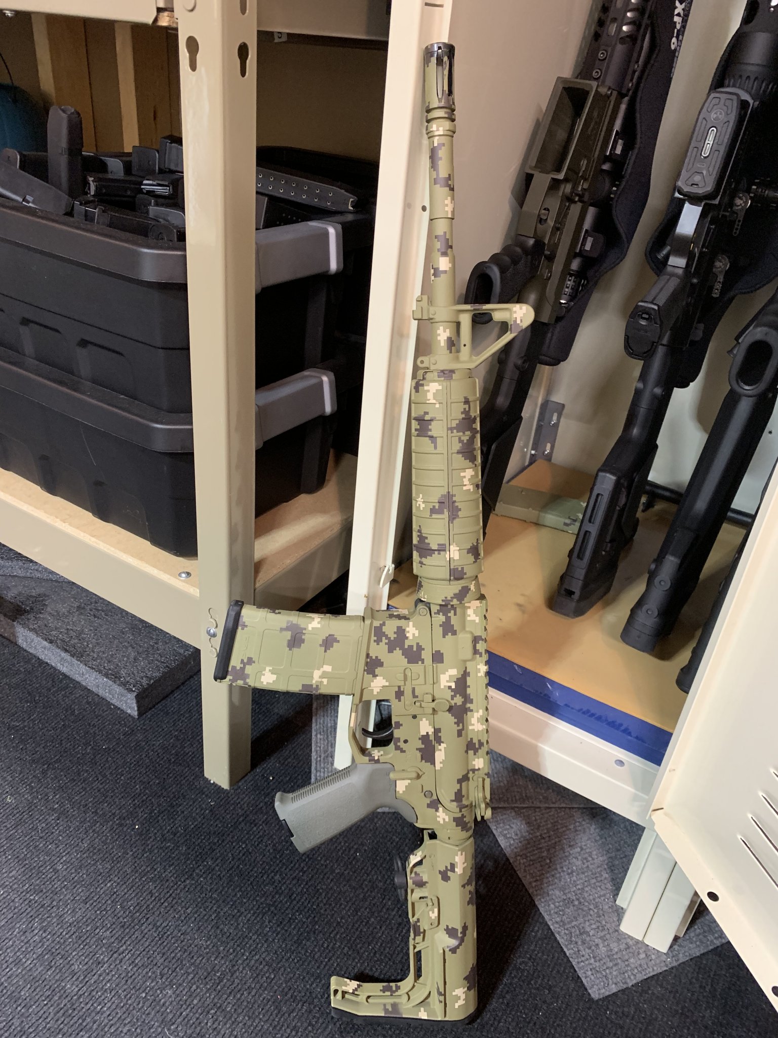

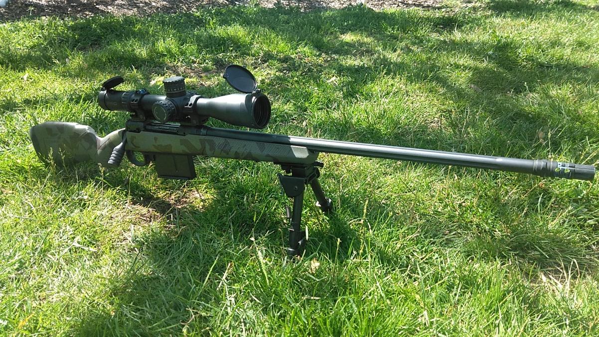

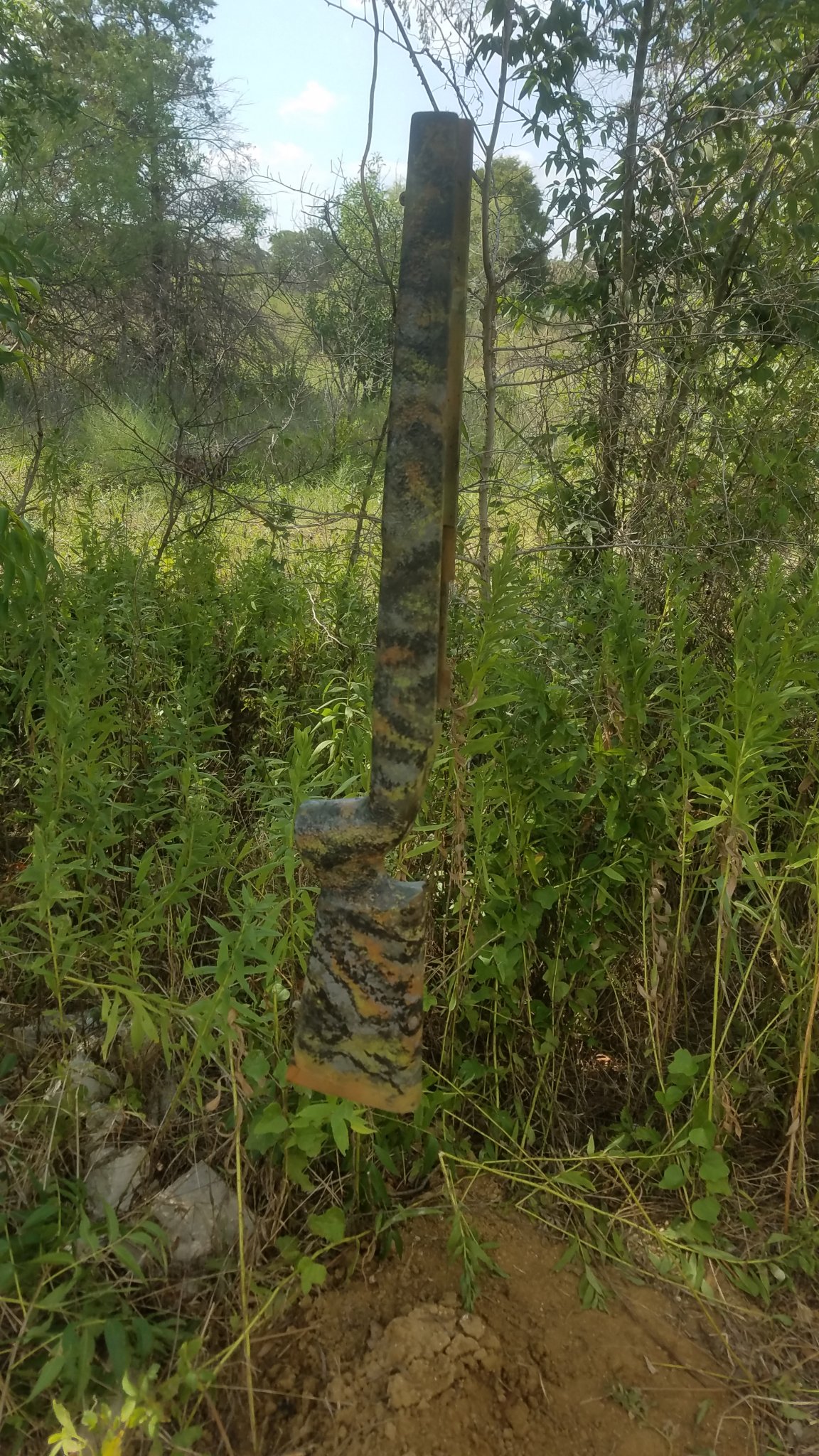

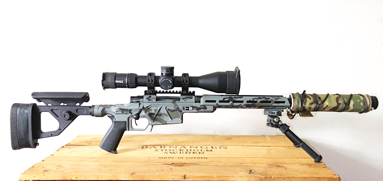

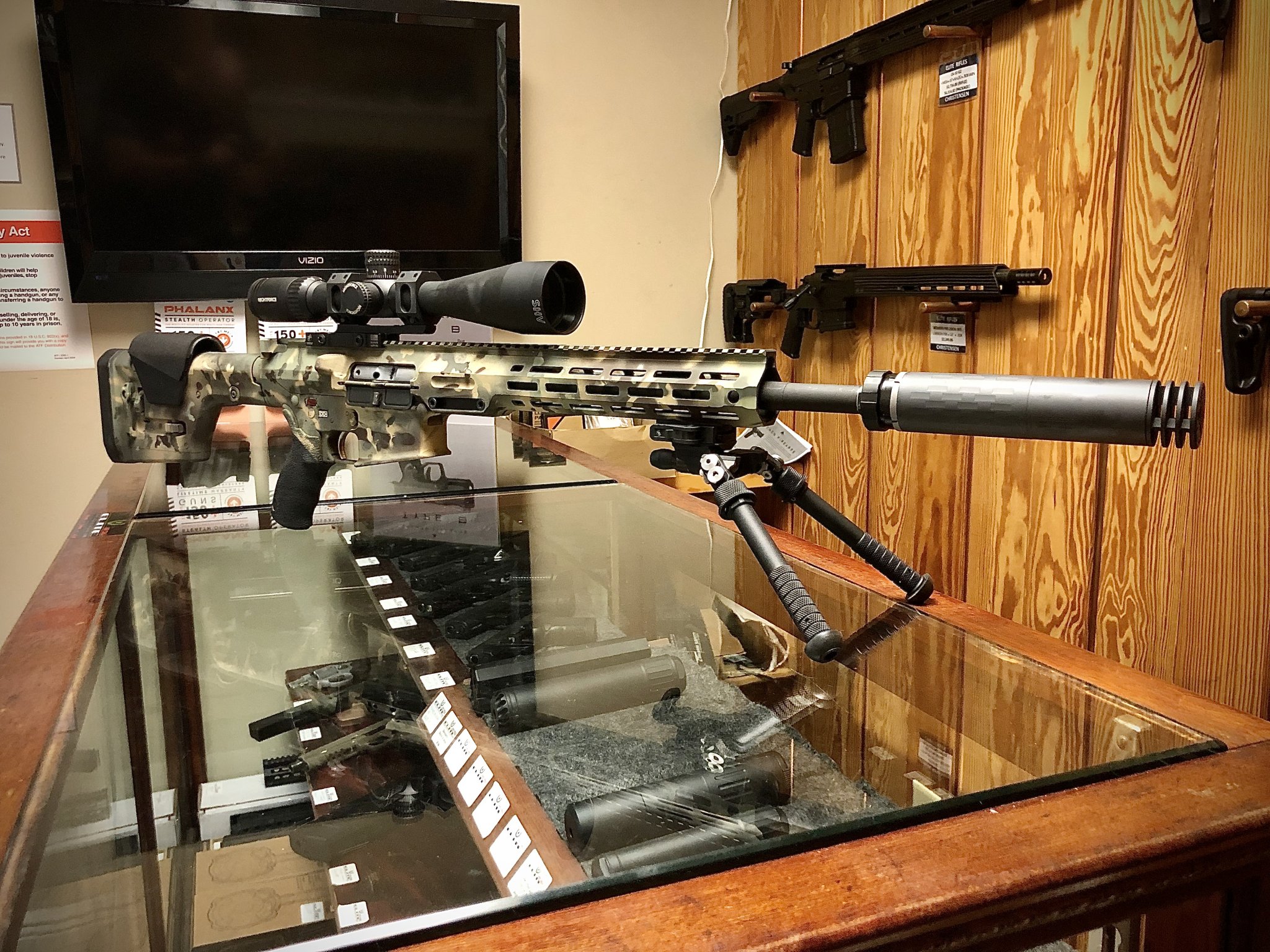

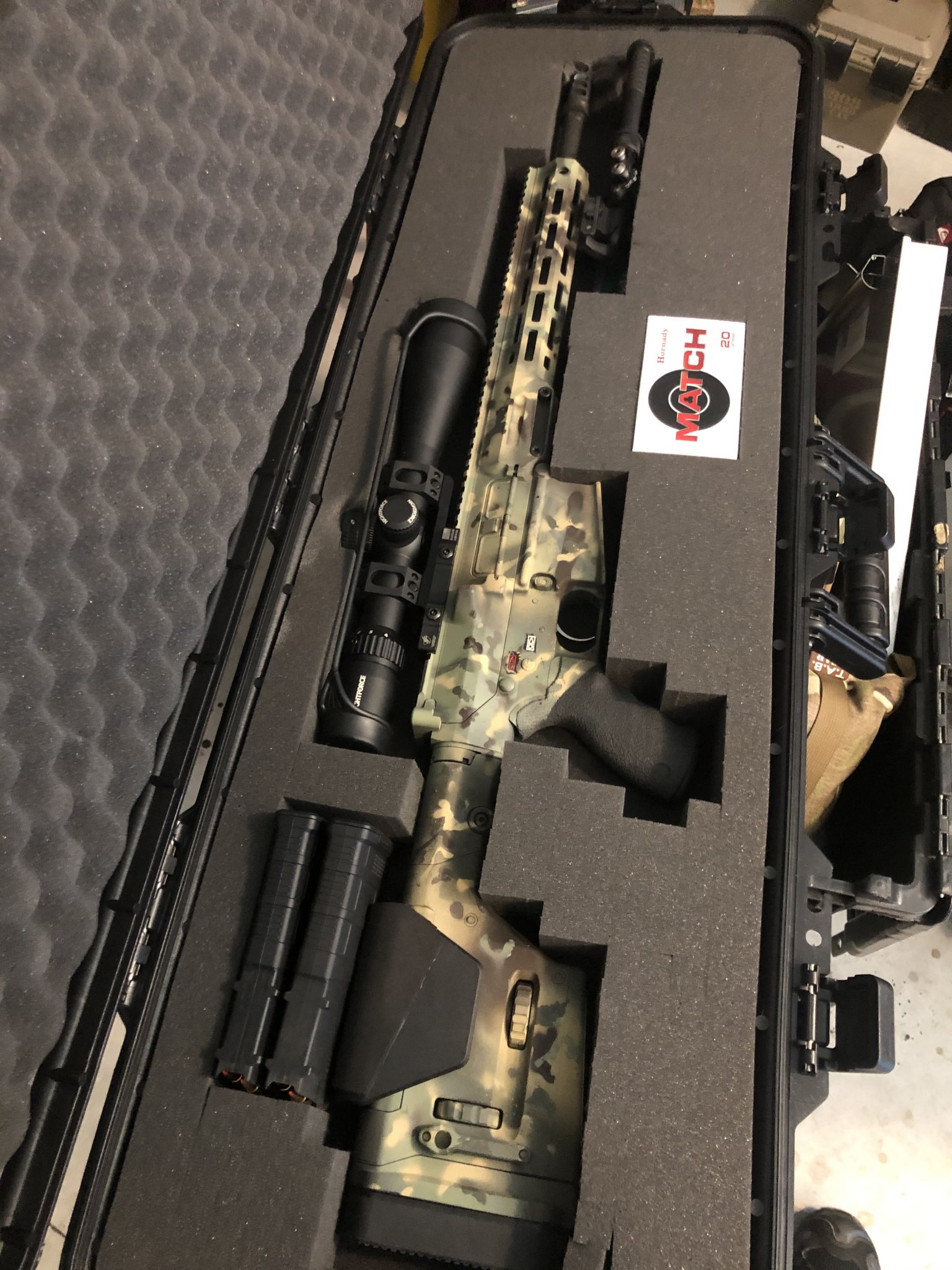

I just got done using the multicam pattern from freedom stencils. I thought it was a worthy purchase and it was a lot easier than drawing your own patterns and cutting them out. I have done that before, and it's more time consuming and not worth the cost savings vs just buying a set of stencils.

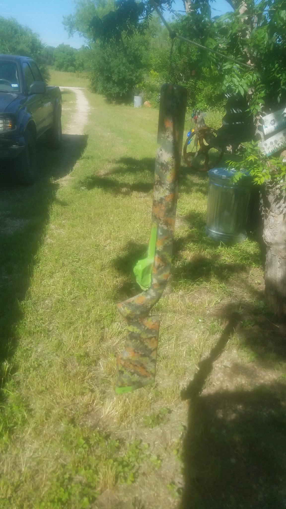

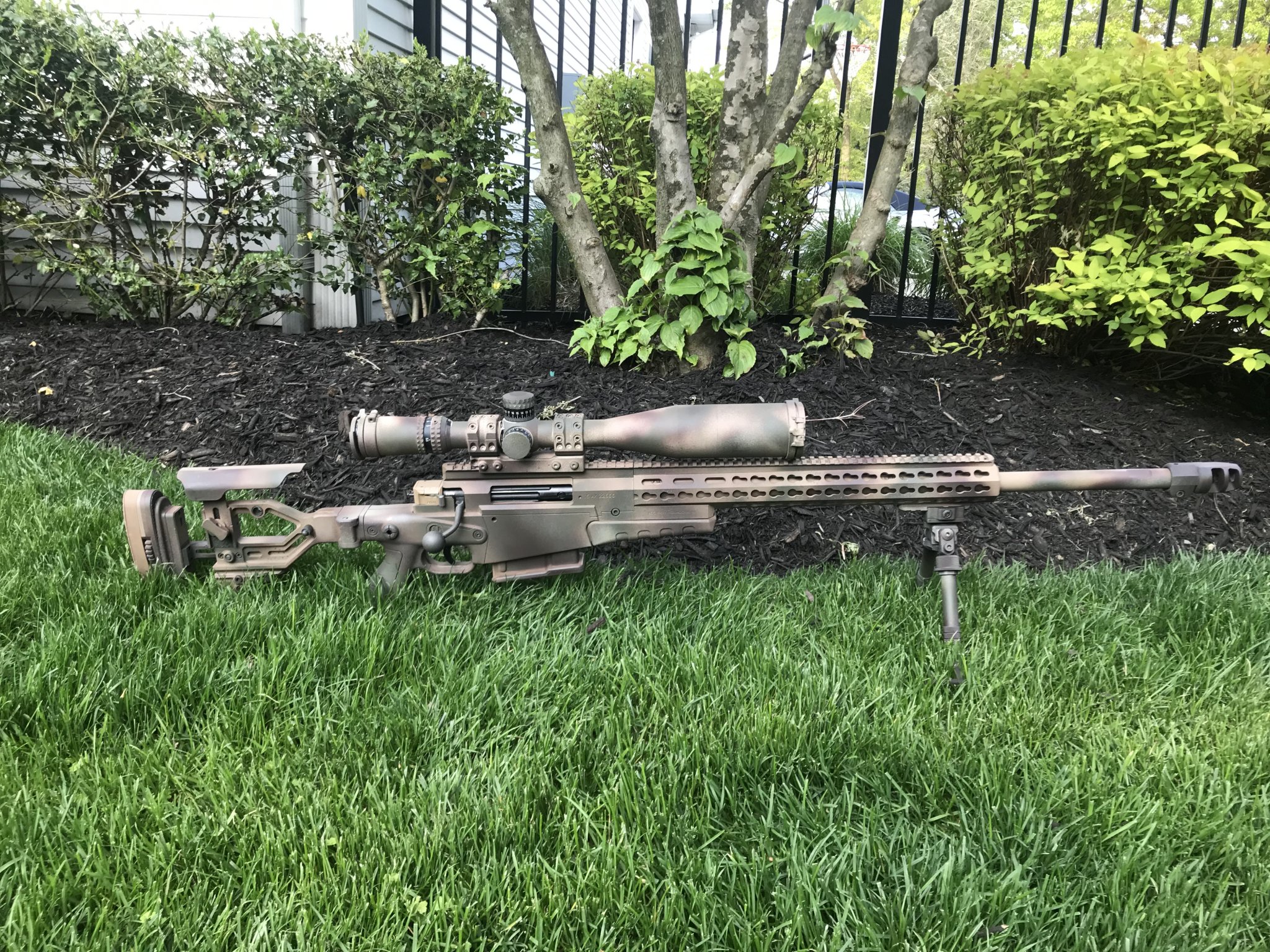

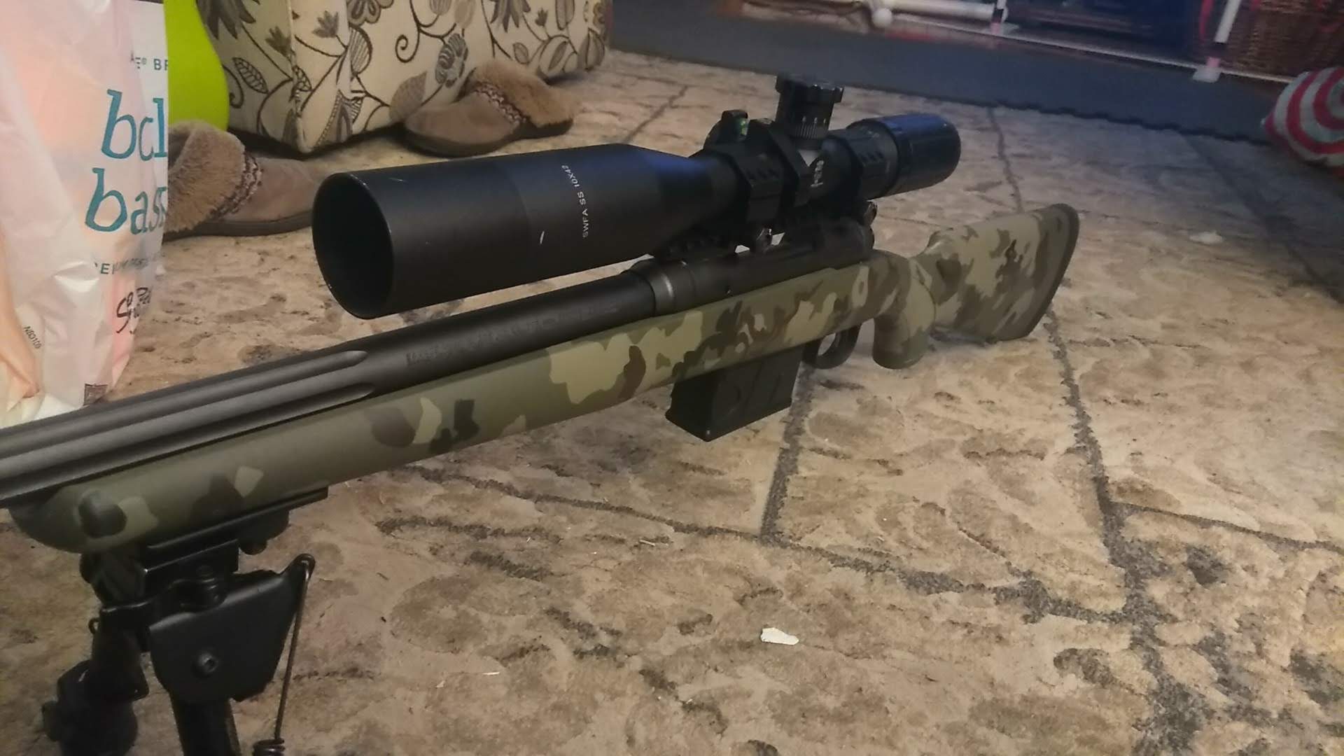

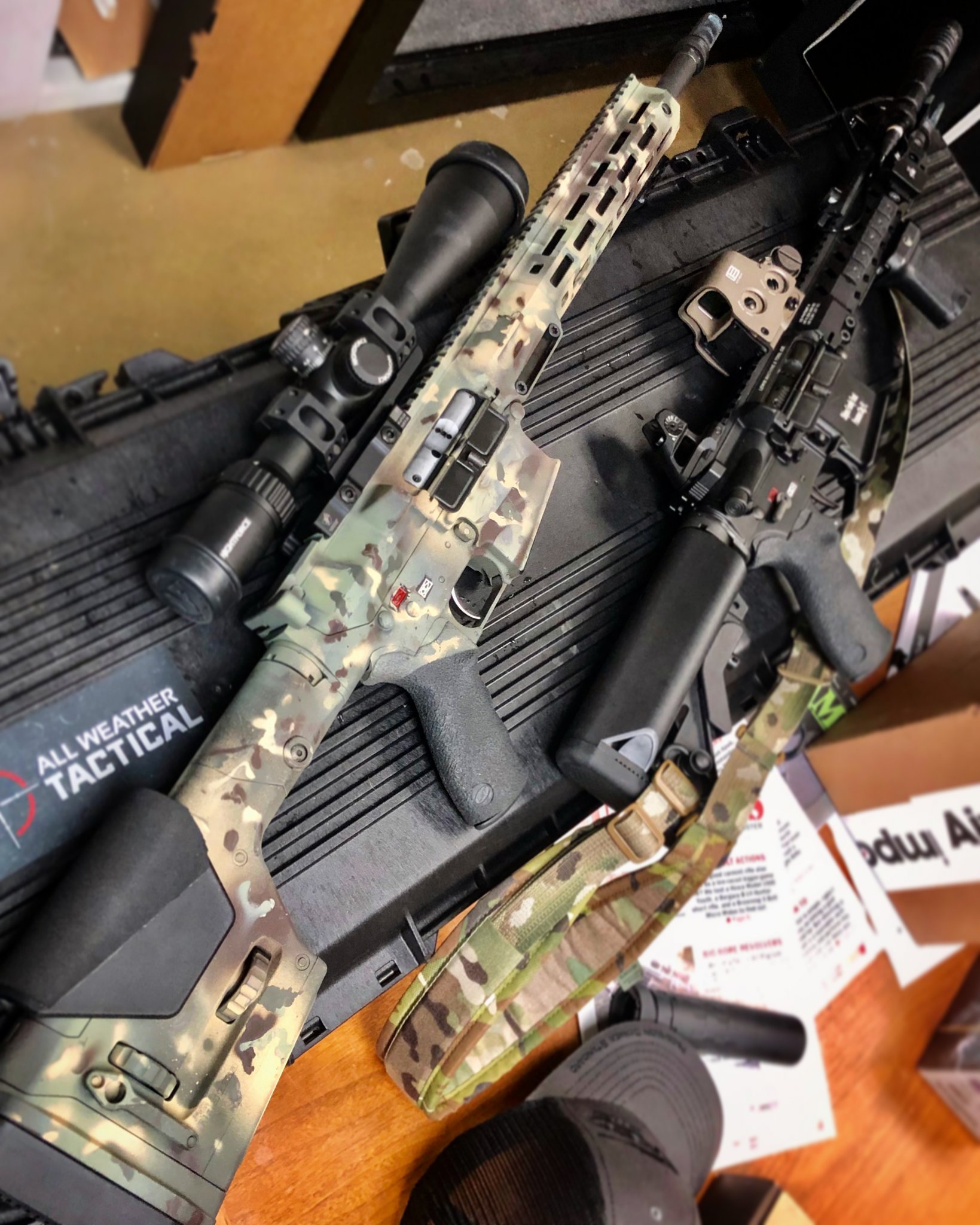

I recently used the primary arms multi cam stencil to do this one.

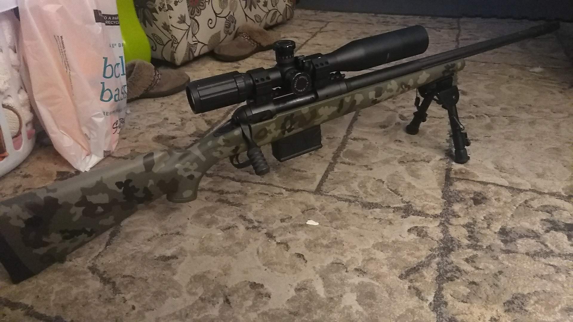

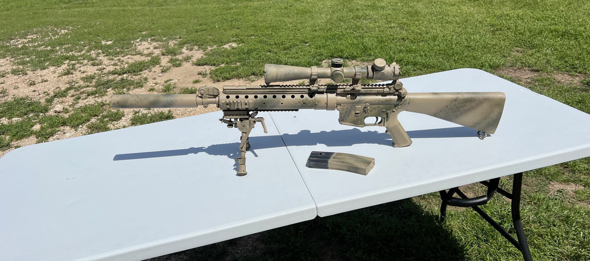

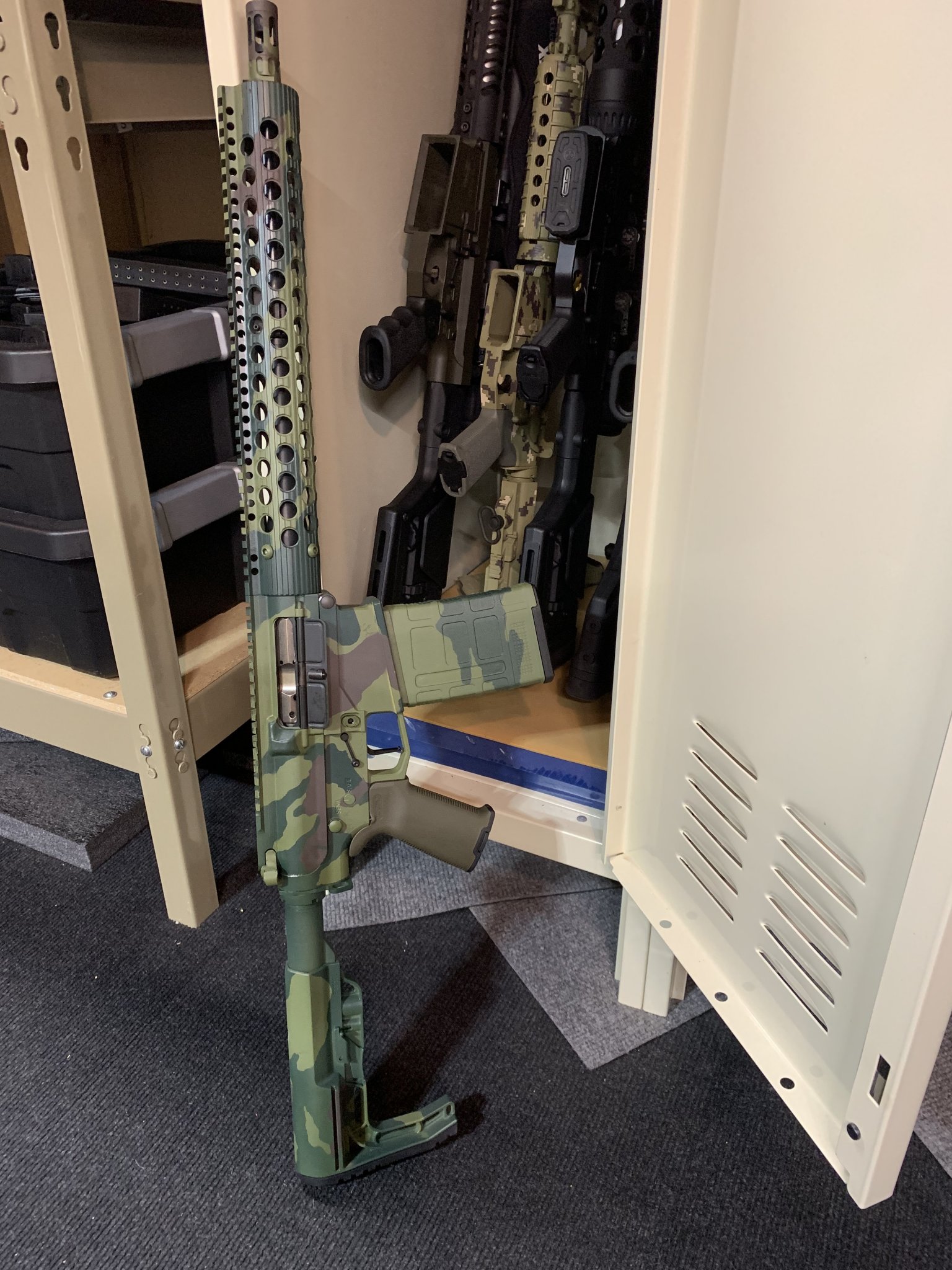

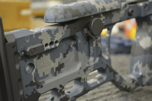

Duracoat Russian camo stencils on the AR10
Duracoat digital camo on the AR15
Duracoat is super easy to apply with a airbrush as well. If the sh!t hits the fan and I need to change colors I will break out the krylon. Until then I’ll stick with cerakote/duracoat .

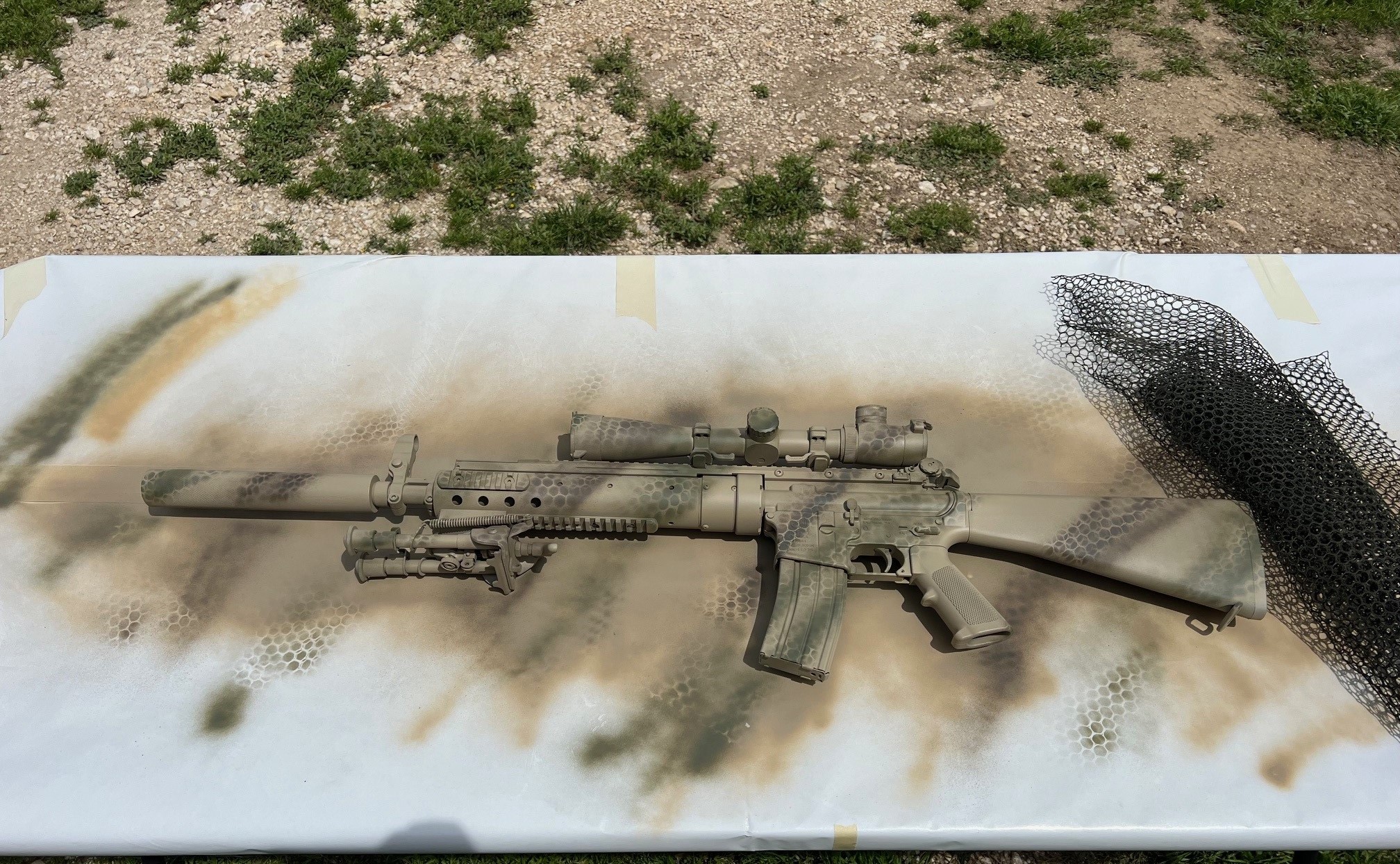

Camo net.
Spray base color, throw on camo net and spray next color, turn the net 90* and spray the next color, etc.

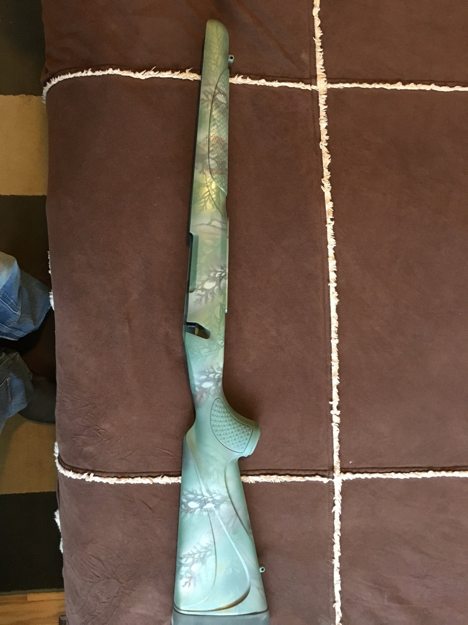

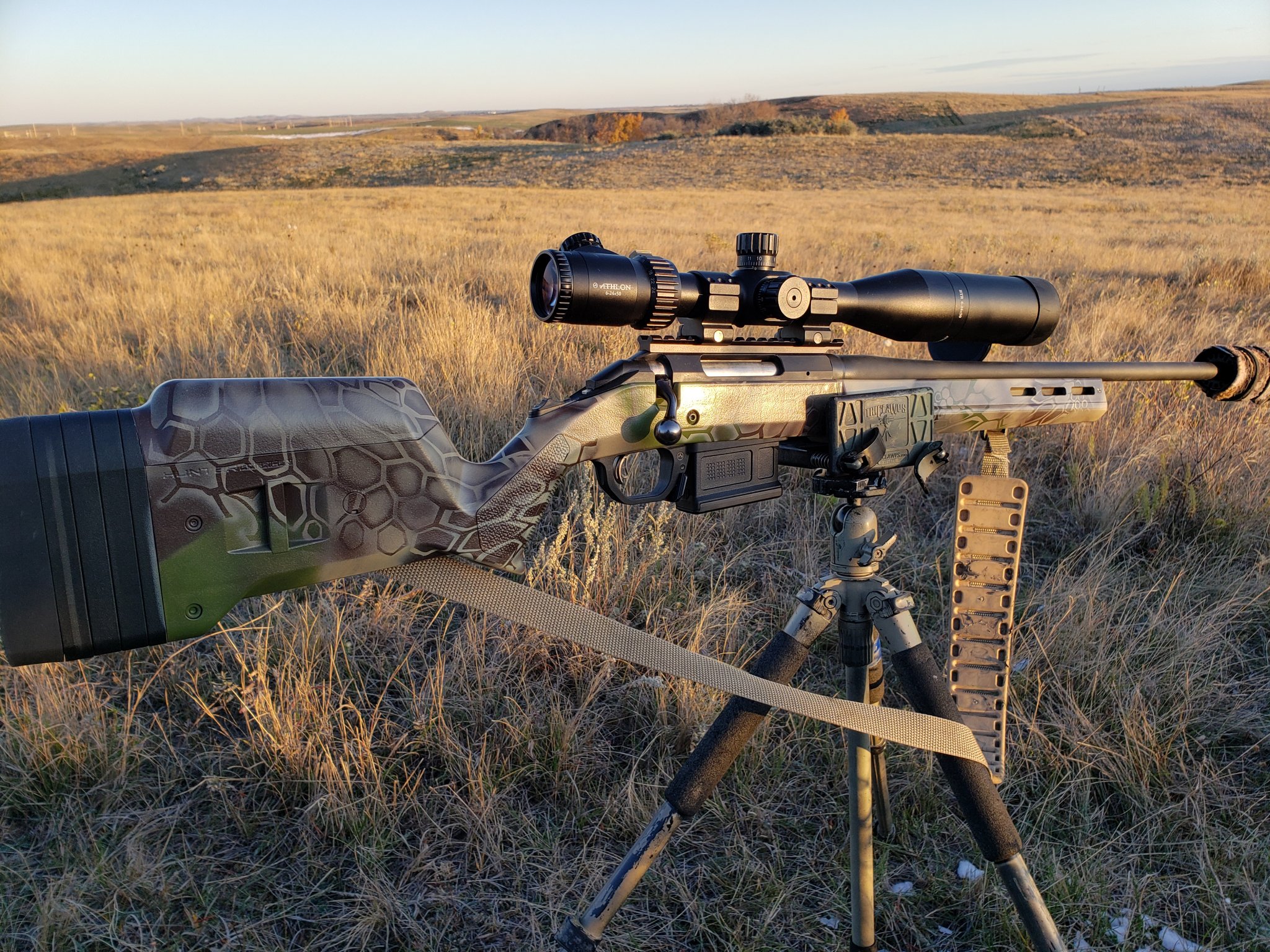

I've recently used wepon stencils and stencils from Etsy on yellow heat safe vinyl. Sharp edges, excellent adhesion but easy removal. Blue edgelock and green frog tape work well as well.
