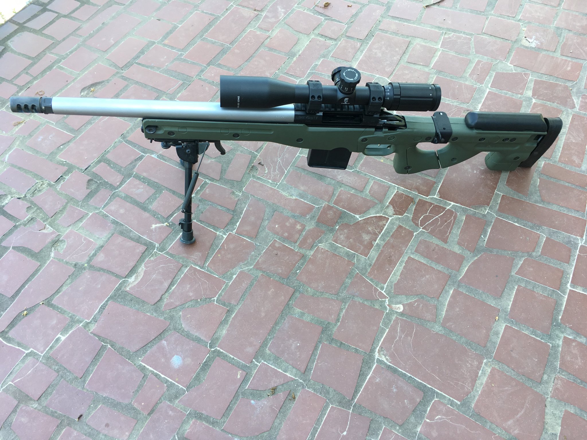

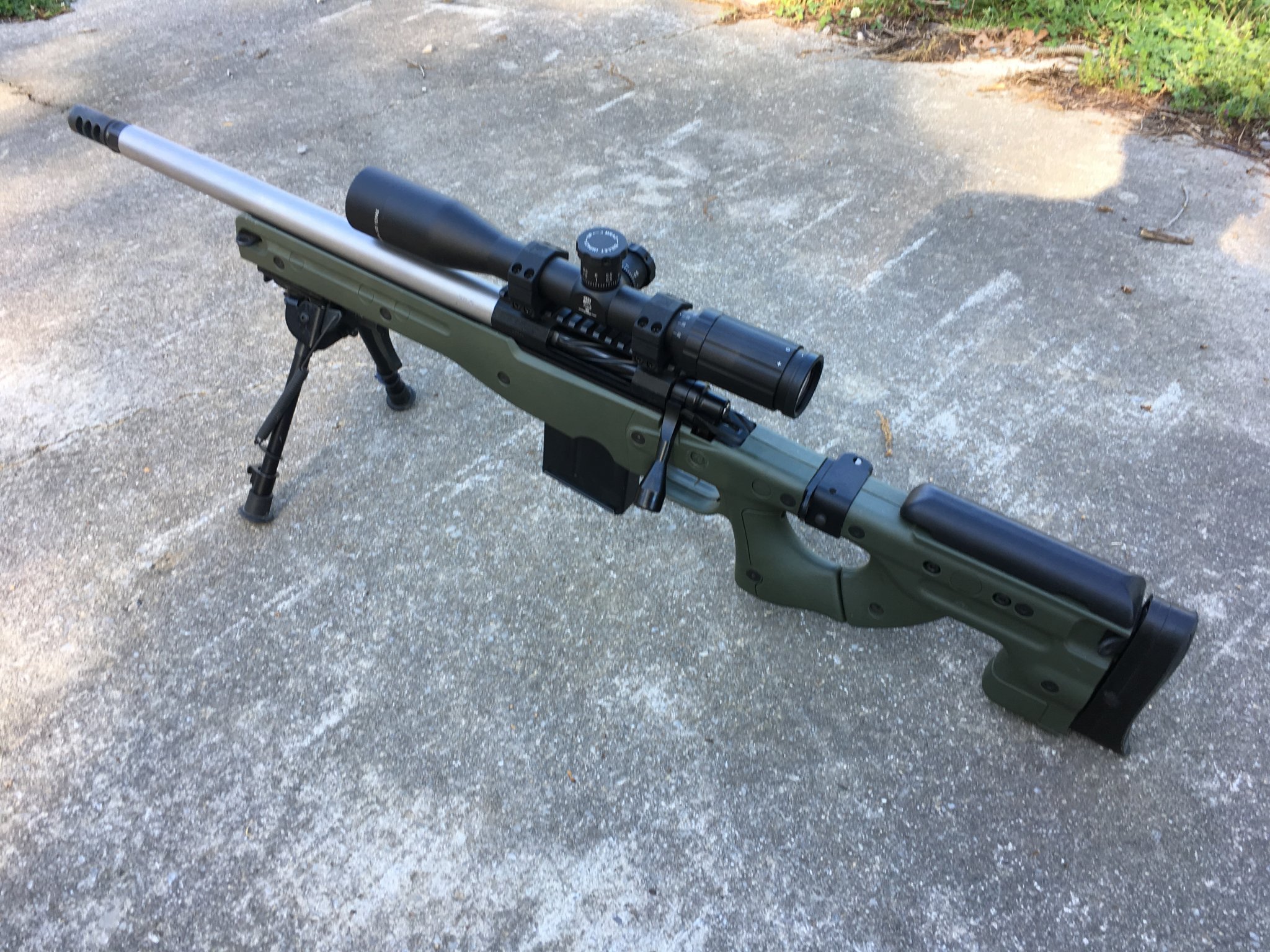

i send in 1 of the barrels to be cut down to 16.5 inch, ill see how i like that, and either do that with the second barrel also when its time or look more into other solutions
I got my barrel back from LRI , went super fast and the work looks very good, I had it cut down to 16.5 and re threaded, they received the barrel this Monday and today Friday I had it back.
Now the rifle is more useful for me, nice looking and compact and not so heavy anymore.
