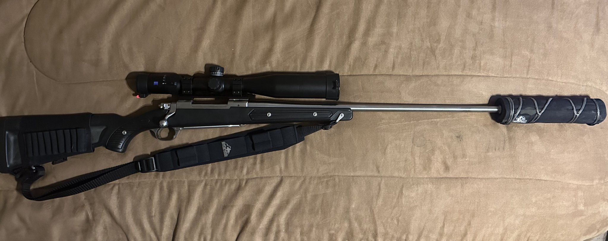

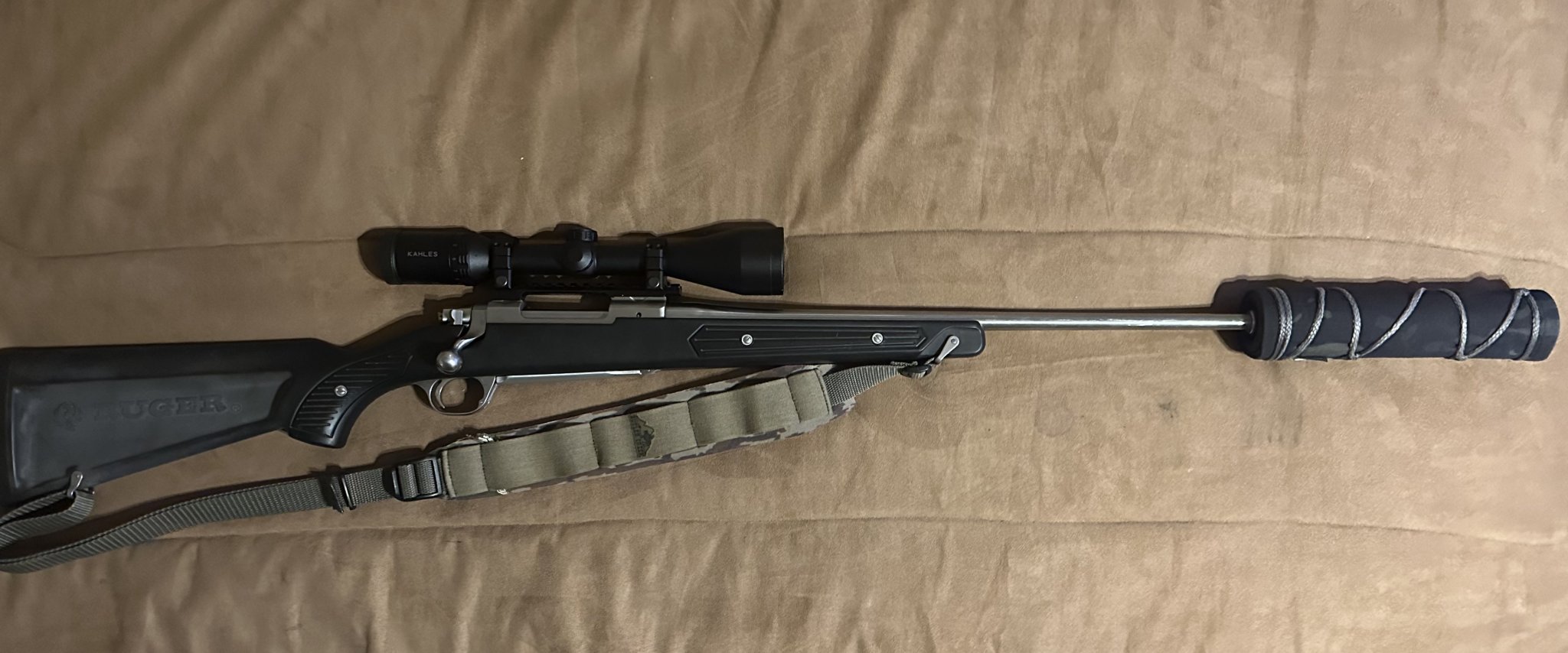

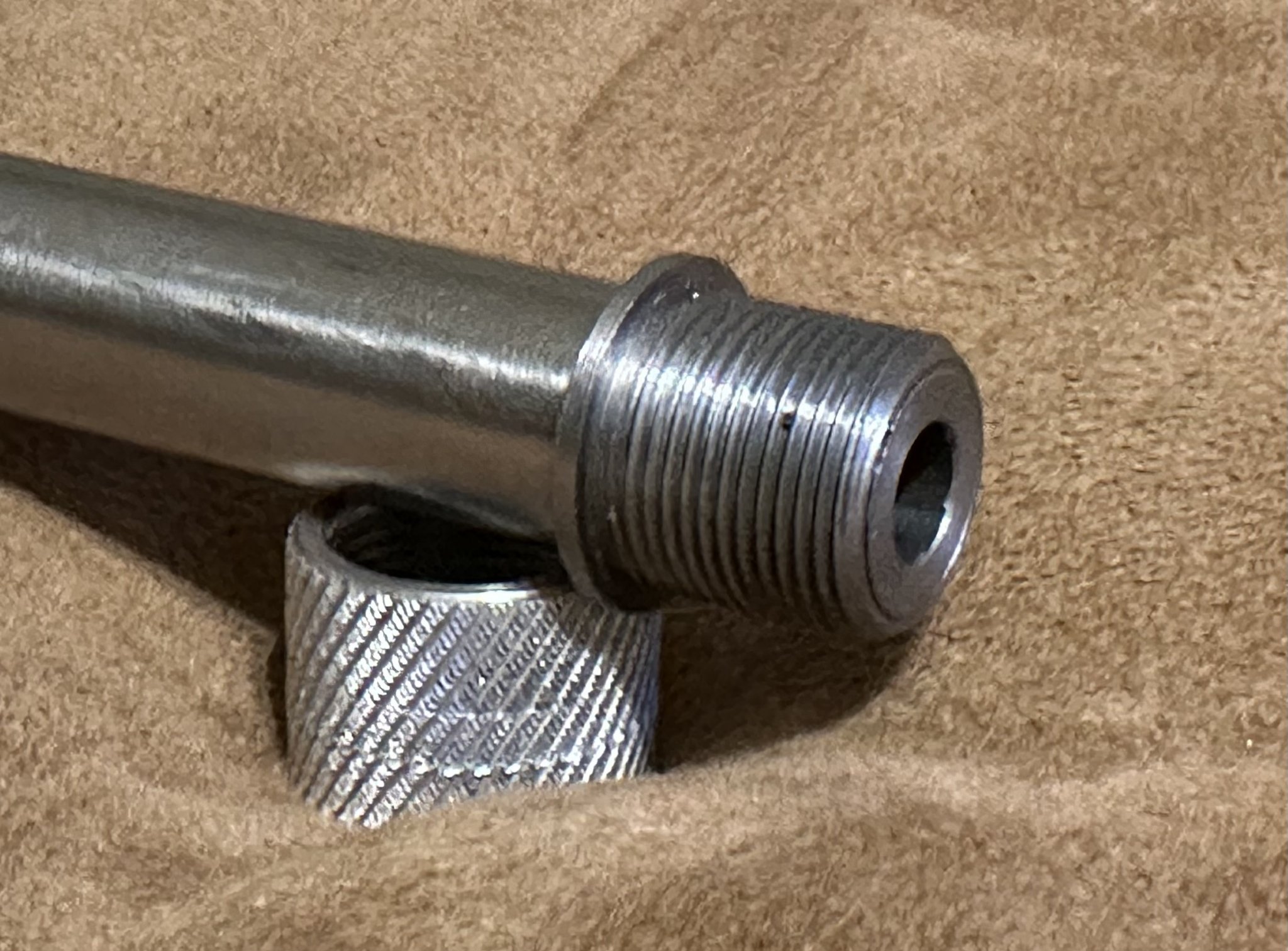

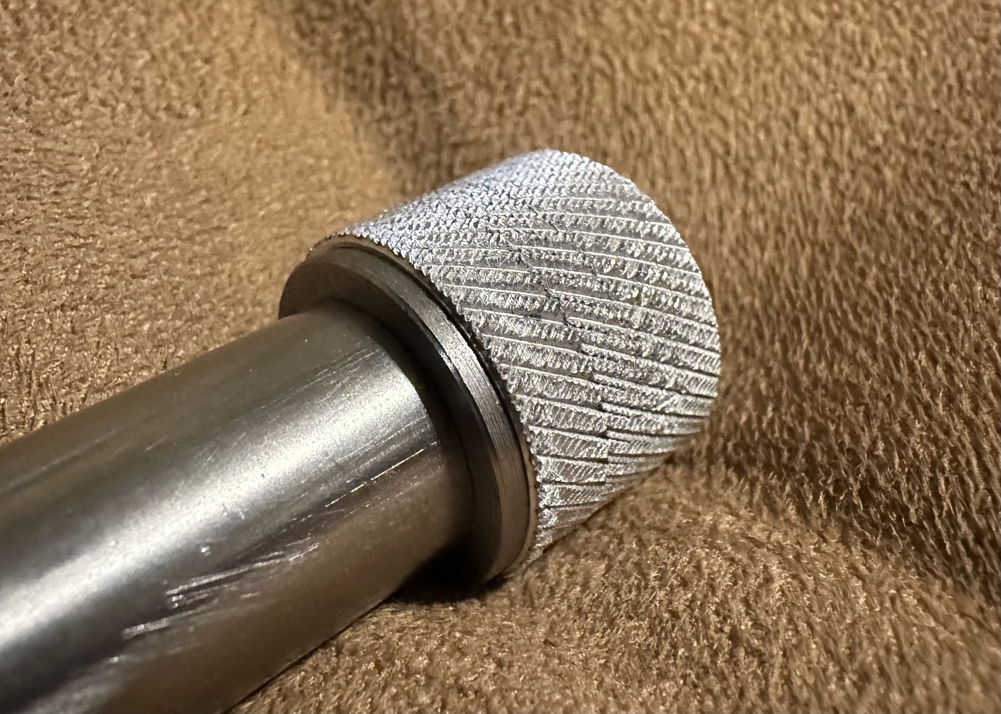

Yes, anything can be threaded... But you have to be careful of the diameter. The diameter might be too thin to thread it for 5/8-24 threads, in which case, you will want to have your gunsmith thread it smaller, and then permanently attach an adapter that is larger than the barrel diameter, that can be threaded 5/8-24 and still have a tall enough shoulder for your suppressor mount to properly butt up against. I had a couple of old Ruger M77 MKII's done earlier this year by my local smith.
