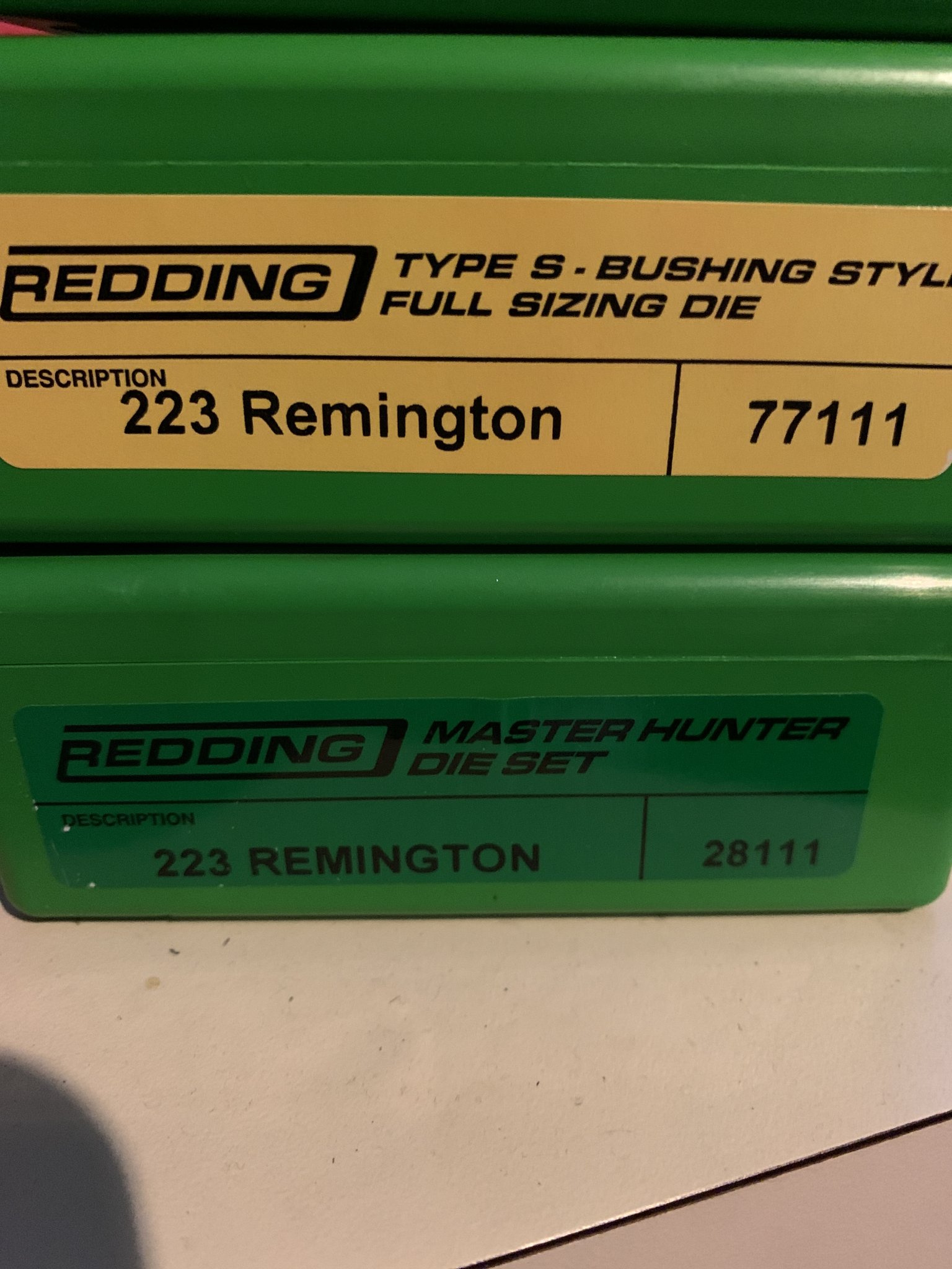

I’d avoid it. You would be working your precision brass more which defeats the purpose of using a bushing to limit working and inducing stresses.
I would buy a normal full length length die to dedicate to the cheap crap brass in order to ensure they all get worked enough and then set the bushing die up for the precision brass.
My bolt die on top, my ar die below to accomplish that.
