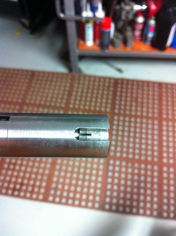

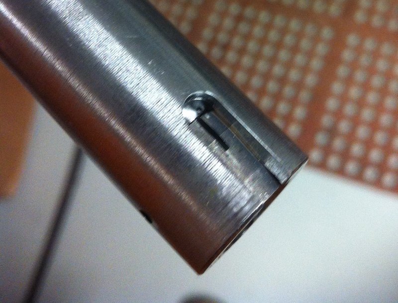

    I had a Rem 788 in 223 do the same exact thing a few years ago. Broke a chunk off the same way. I installed a Tubb/Sako style extractor and it worked great. Straight forward milling job. I don't see why you couldn't do it on your 6mm. They're easier to do on 788s without the lugs in the way like the 700.
    Here's a couple pics of extractor. I also managed to salvage a SS fluted Rem barrel that had a bad chamber by cutting off chamber and making a barrel nut for it. That was my only choice since the shoulder was no longer large enough. Turned the gun into a .222 for shits and grins. Functioned great and shot good.
