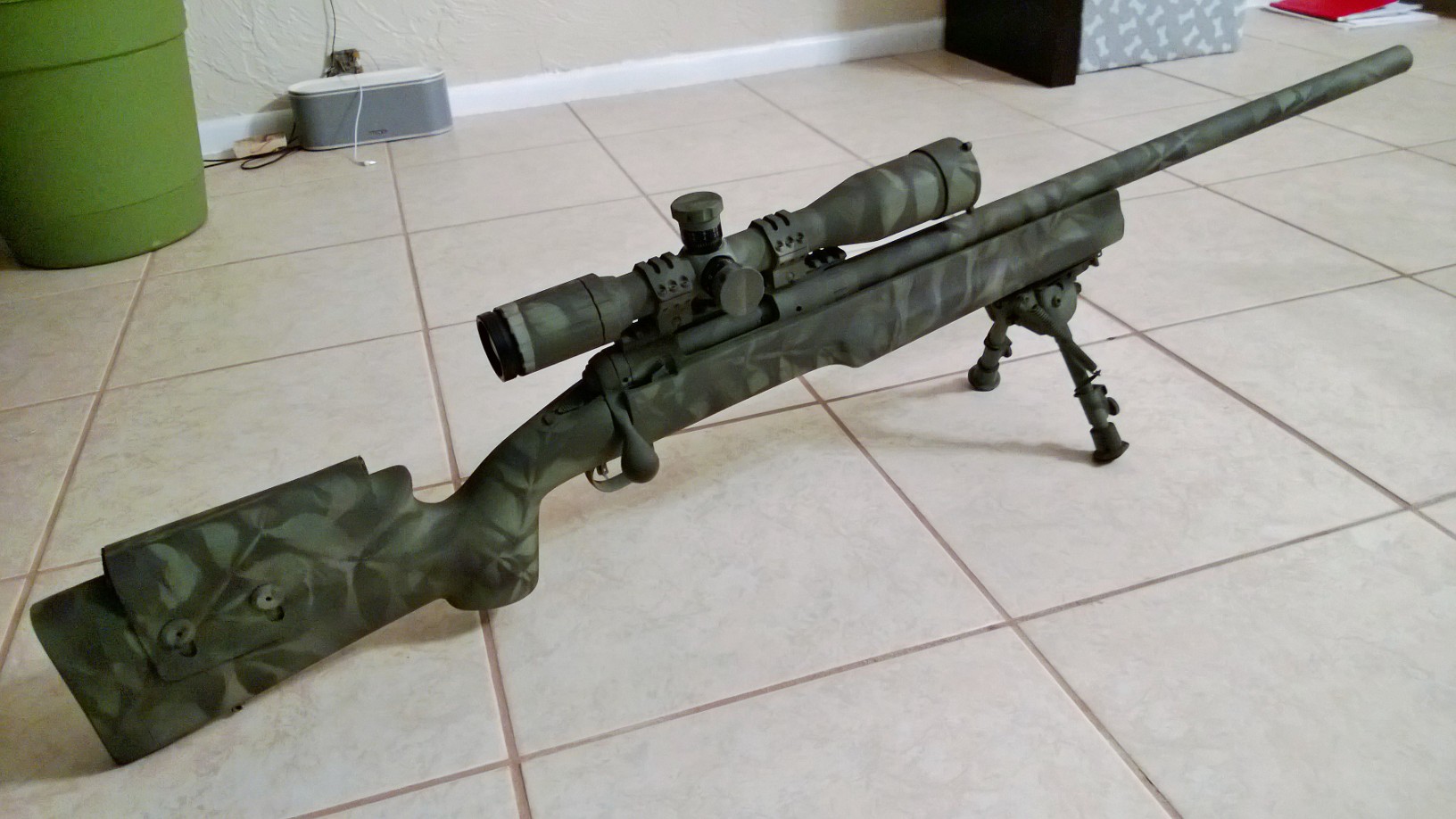

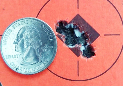

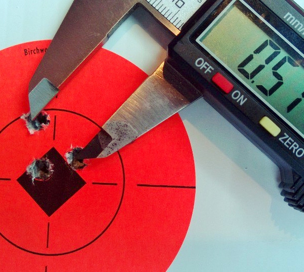

First pic = 7 shots at 100 yards FACTORY Hornady 140 Amax
2nd Pic = 200 yard group
3rd Pic = 850 yard group in the wind when the guys with the $5000+ custom rifles were crying (that's 20 rounds of 120Amax factory ammo)
4th Pic is the gun itself.
Yeah, they shoot. This one started out life as a 10FP-SR in .308 that I threw a Shilen SS SM in 6.5 CM 26" onto. Accutrigger with a B&C A2.
You absolutely MUST change the piece of crap stocks they put on them unless you want to shoot from sandbags. Every Savage I've owned would shoot 1/2" from sandbags, out of the box, but throw a bipod on there and you will be lucky to have 1.5".

Check out my post in this thread from earlier. .5" @200 is .25 MOA. My savage shot .25 MOA with factory amax ammo and a bit better with handloads. Check out the pics I posted. Those weren't flukes but a common occurrence. I now have a custom Remmy in 338 lapua with shilen ss sm bbl and aics 2.0, and no I wouldn't give it up for another savage, but that doesn't mean savages don't shoot. They do. The floating bolt face design has served them well.

Sorry, this was the quote I was responding to. Check out my pics from earlier in the thread. I can't speak to reliability because I never used it for a tactical match. But the rifle was a .25 MOA stick with factory ammo from a bipod.

That was directed to somebody else, but all is well. Cherry pick a group doesn't mean a lot. I shot a .0x group out of my AI at 200 last week. Doesn't mean I'm going to claim the gun is that accurate. It was a single tagged hole barely larger than bullet diameter. I didn't cut it out and stick it in my wallet or take pictures to post all over the internet as if I'm proving something with it.
If you want to claim your savage is .25 MOA at 200, shoot five targets on a single piece of paper with five rounds each. If they are all .25 MOA or under, then your Savage is a .25 MOA gun. If not, you've cherry-picked a group.
So the challenge is still out there, let's see a factory savage shoot a 5x5 under half MOA or in your case, .25 MOA.
Five groups of five on a single sheet of paper, no "called flyers" or any of that business.

Not cherry picked, that was as I noted before a common occurrence. I've shot it against guys with ais and custom remmys and have outshot most of them. With handloads, if I still had the rifle, I would go out and give you 10 groups of 5 shots that were under .25. Don't be mad because savages are accurate lol. They just are. I have other customs too, bighorns, truee remingtons, but that doesn't mean th savage isn't accurate. It is.

The myth of the .25 MOA Savage eludes us just like Bigfoot. One day we will actually get photographic evidence and capture one of these fine Savages.
Another coulda woulda should. Not asking for five groups, but five on a single range session on one sheet. If you show five random groups, they are cherry picked.
I don't care how accurate you say yours ways. It's only as accurate as you can prove. Furthermore any rifle is only as accurate as the shooter. If you say your savage beat custom Remingtons, your head is already screwed in backwards. Rifles don't shoot themselves. Read my other posts in this thread.

I lold at your bigfoot remark... Yes maybe not all savages were as accurate as mine. I did have a heavy shilen sm on there and other fine components. I am not a 'savage shooter.' just a dude who had a savage. And u may be right because I've shot guns and bows since I was a little kid and was an archery instructor for a couple of years for junior Olympians. So I know fundamentals that go into all shooting principles. But if I had the gun and my handloads I could throw down 5 or more groups in one session without a problem. But I think we've hijacked the thread. The op wanted to know if savages could be competent tactical rifles, not whether they are .25 MOA shooters. And I understand durability is a factor there, as well as reliability. However, to say that there are no .25 moa savages, is just plain not true. We must agree to disagree. Good day friend.
