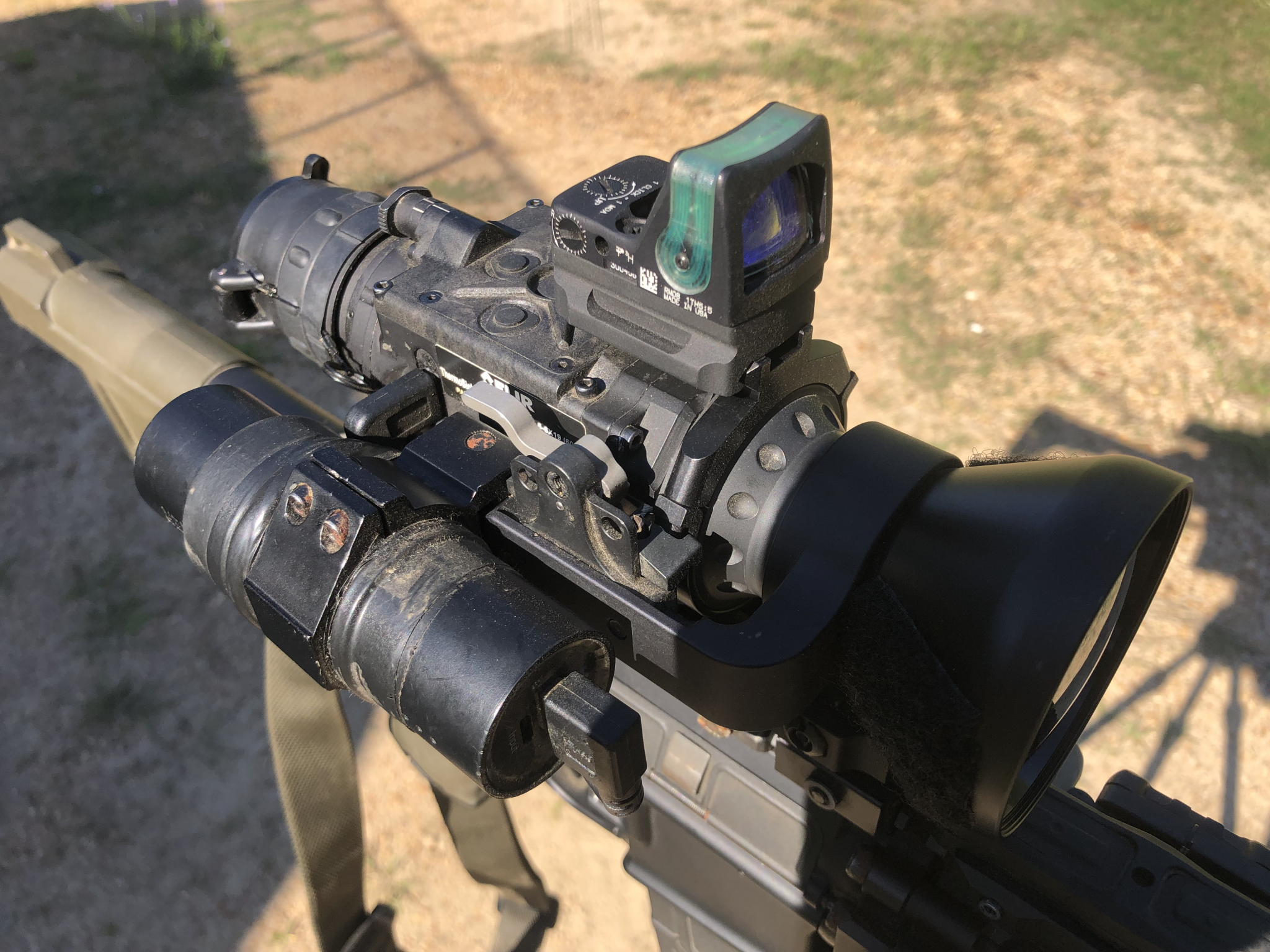

    I'm thinking it would be great to be able to attach a 2x or 3x magnifier to the front of a thermal scope to double or triple the native magnification.
    Anyone know of anything like this?
    Yep, I do it all the time.
    Flir PTS 233 with a Torrey Pines Logic 3 X Magnifier x 1.5 native PTS 233 produces a new native magnification of 4.5 X. Turns mini mouse into mighty mouse. :LOL:
    I had TPL make me custom mounting arms that quick attach to the PTS Thermosight Pic Rail. Ensures a rock solid mounting of the magnifier that does not move so you do not loose your POA/POI. It is critical that the magnifier be rock solid and does not move when attached to the host thermal sight.
    So I have the best of both worlds Wide FOV or Narrow FOV for longer range work. That 62 mm of Germanium working gathers up a lot of information. :)
    You can put a magnifier on virtually any thermal, if it will physically take one. I held a 3x FLIR M18 magnifier in front of my FLIR ONE some years back and I was surprised that it actually worked.
