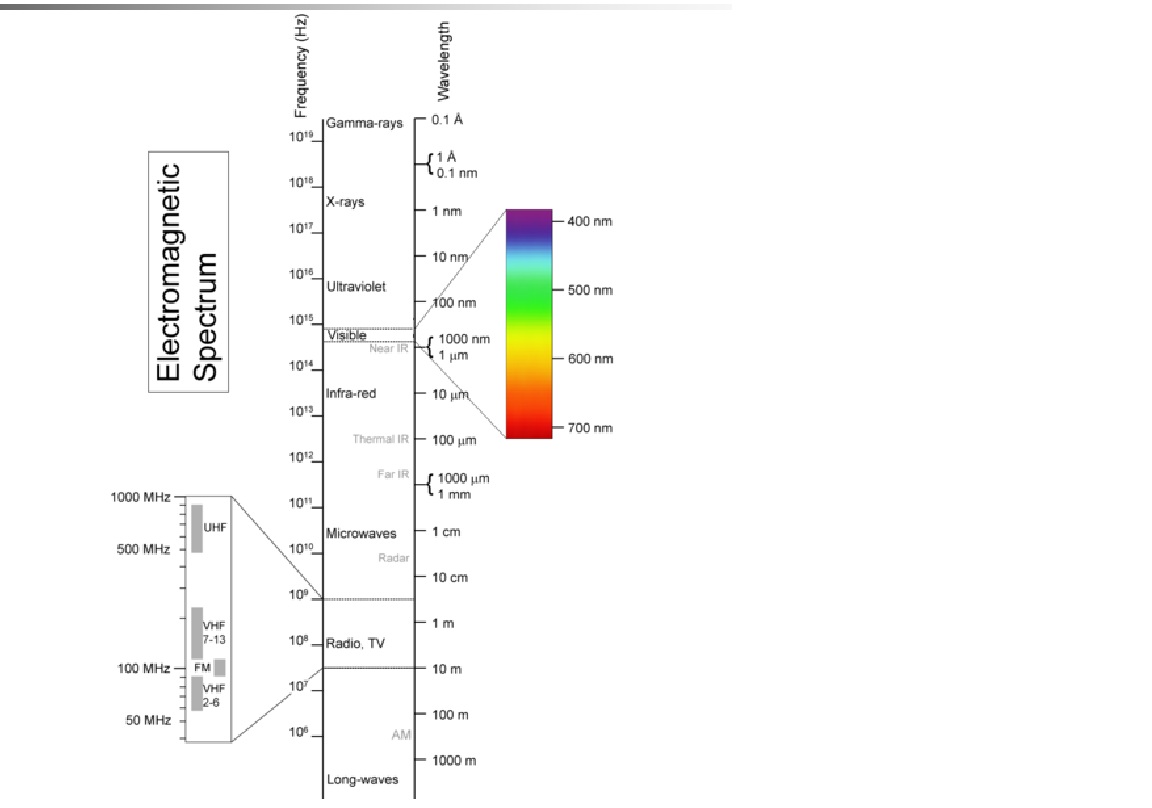

yes and no i guess, visible laser has different band than IR. but laser generally produce thermal radiation which can detect by IR, but the wavelength of the laser is not detectable by laser.
we can seen wavelength from 400-700nm, IR is in 700nm-1mm range. so green laser is in 500nm, while the red is in 600-700nm range, but because near-ir filter usually overlapping between red/IR, so the sensor usually can detect red laser in 650nm+ range.
so if your ir scope is from near-ir to some other range than it should be able to see red laser. but the intensity might not be too great
