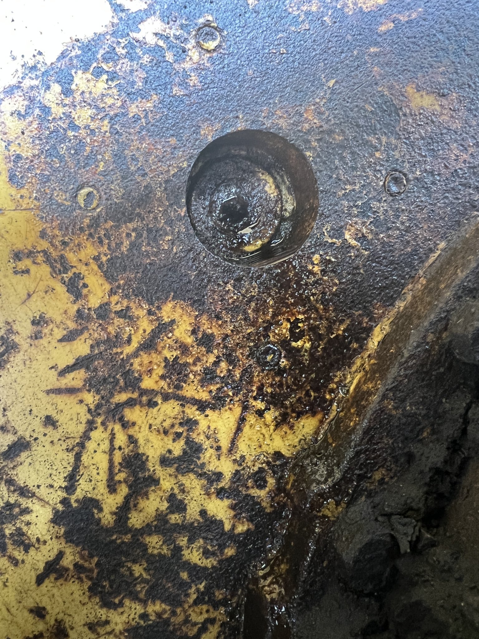

It appears that no mechanic in my area can figure out this problem? How would I go about repairing? Fluid sprays out when I move the dozer right to left. Apparently no one has ever encountered this problem before.

It's referred to as "The NASCAR leak."
It only appears when you turn left. 🤪
Seriously though if it only leaks when you turn left, get a hydraulic schematic and give it a look. Should be very simple to troubleshoot.
Repair might be another issue.
It looks like an older machine but without knowing the age and drivetrain I will recommend beginning by determining if it happens when you push the clutch to drift left or when you get into the brakes to turn left. Related but different systems, both a pain to get to.
Edit: After looking at the photo again and reading n2's post, did you break off a zerk?

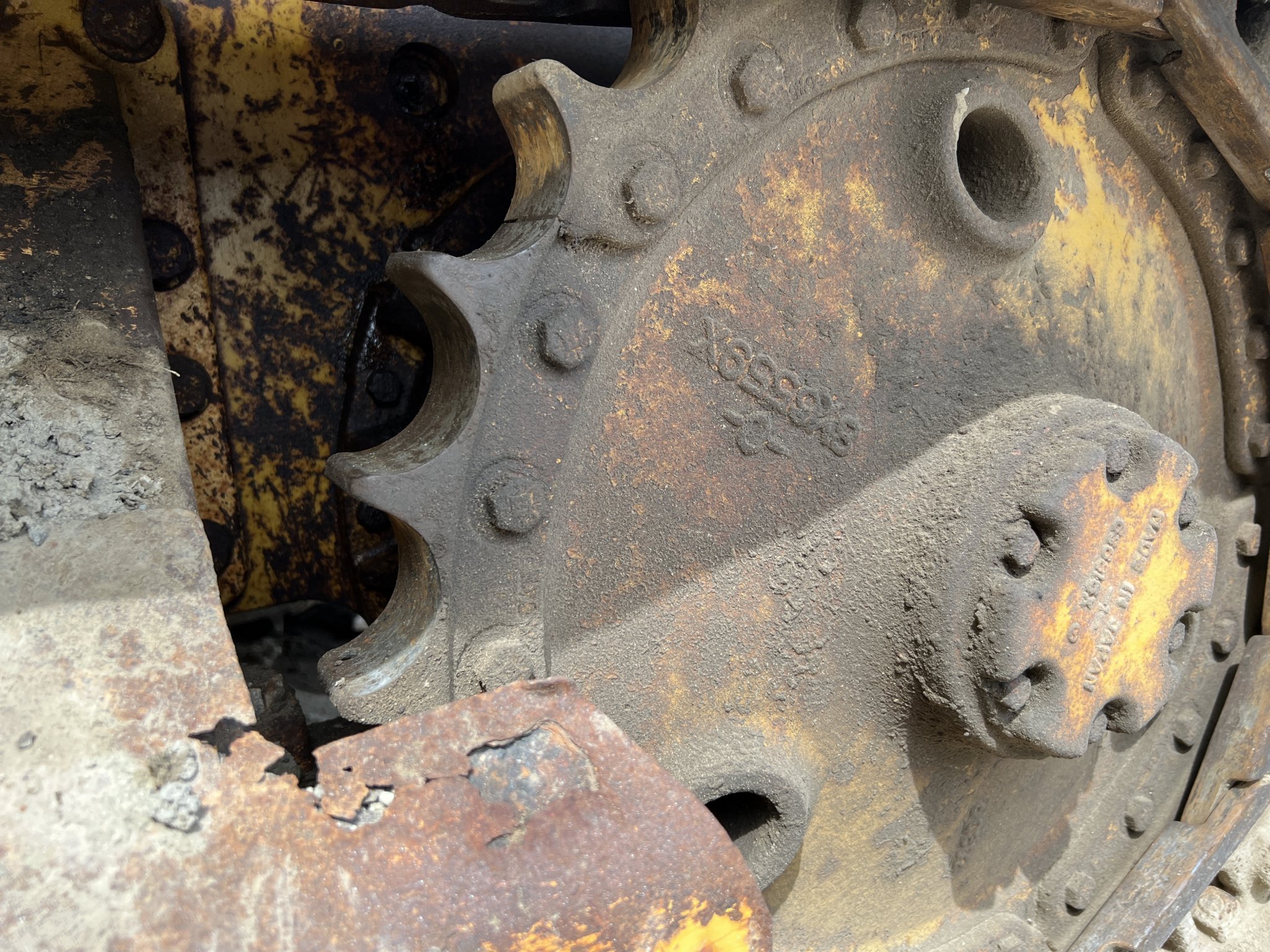

Second pic looks like an oil level plug for the final drive. Looks like there is a hole in the center. If it’s squirting oil out of there then you more then likely have seals bad on the pump that drives the final drive.
I think it is too high to be the high level check plug. It probably is a vent.... Take an easy out and remove the piece that is broken off.
Not seeing a vent in final drive housing
Could just be a plug.
Looks to me like that plug is cut to have a 1/2 drive socket inserted for removal like most final drive checks or fills. Have you taken that plug out? Could be as simple as an o ring that has gone out beind the plug face.

Here is a video on a D6. checking the steering clutch pressure. If you read the explanation they are tying in the hose for the gauge to the port on top of the bevel gear case..... That may be where you are loosing pressure and as a result your machine won't turn in one direction.

Have you thought about taking the plug out and seeing if the compartment is over full? If it is what type of lube is it full of, should be gear lube I believe. Is the o-ring on that plug in good condition or is it missing?
It sounds like you might have an issue with the seal between the steering clutch compartment and the final drive. Not sure why it would leak at the plug and not at the duo cone seal area unless the plug o-ring is gone.
