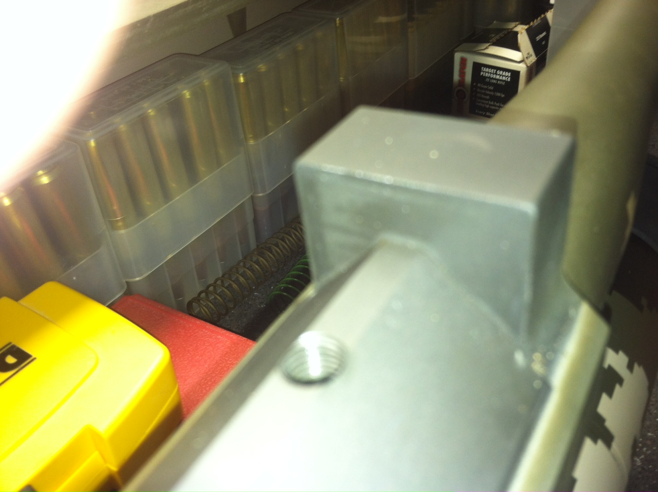

    HI Dang, We looked at doing this about 5 or so years ago. If I remember correct, the issue is not the inlet, I think that it was the long rear tang. If the action was set up correct in the stock for the proper distance to the trigger shoe. I think that the long square rear tang actually would break through the side of the stock. Send me a PM with your phone number and I will give you a buzz. Thank you very much,

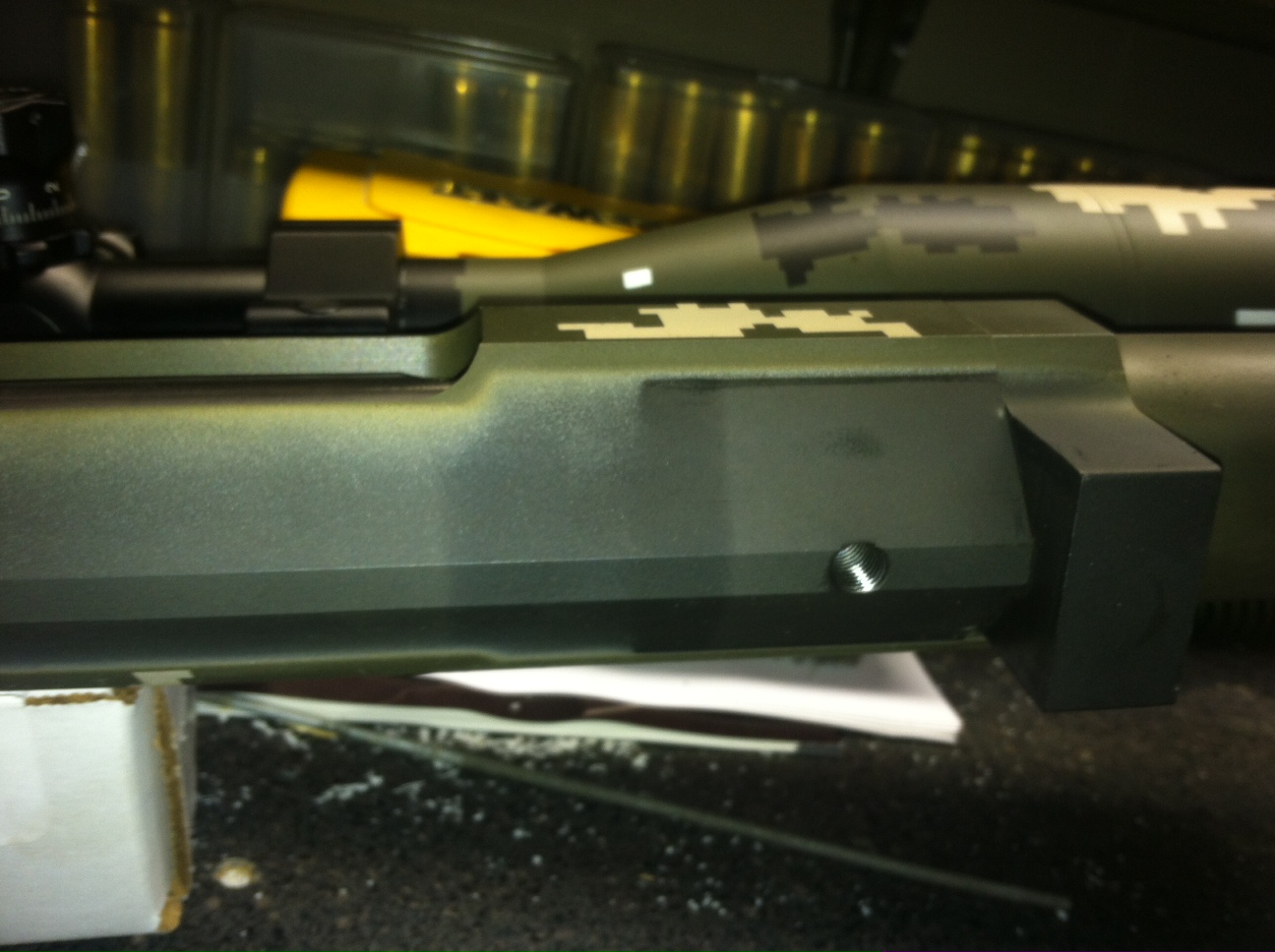

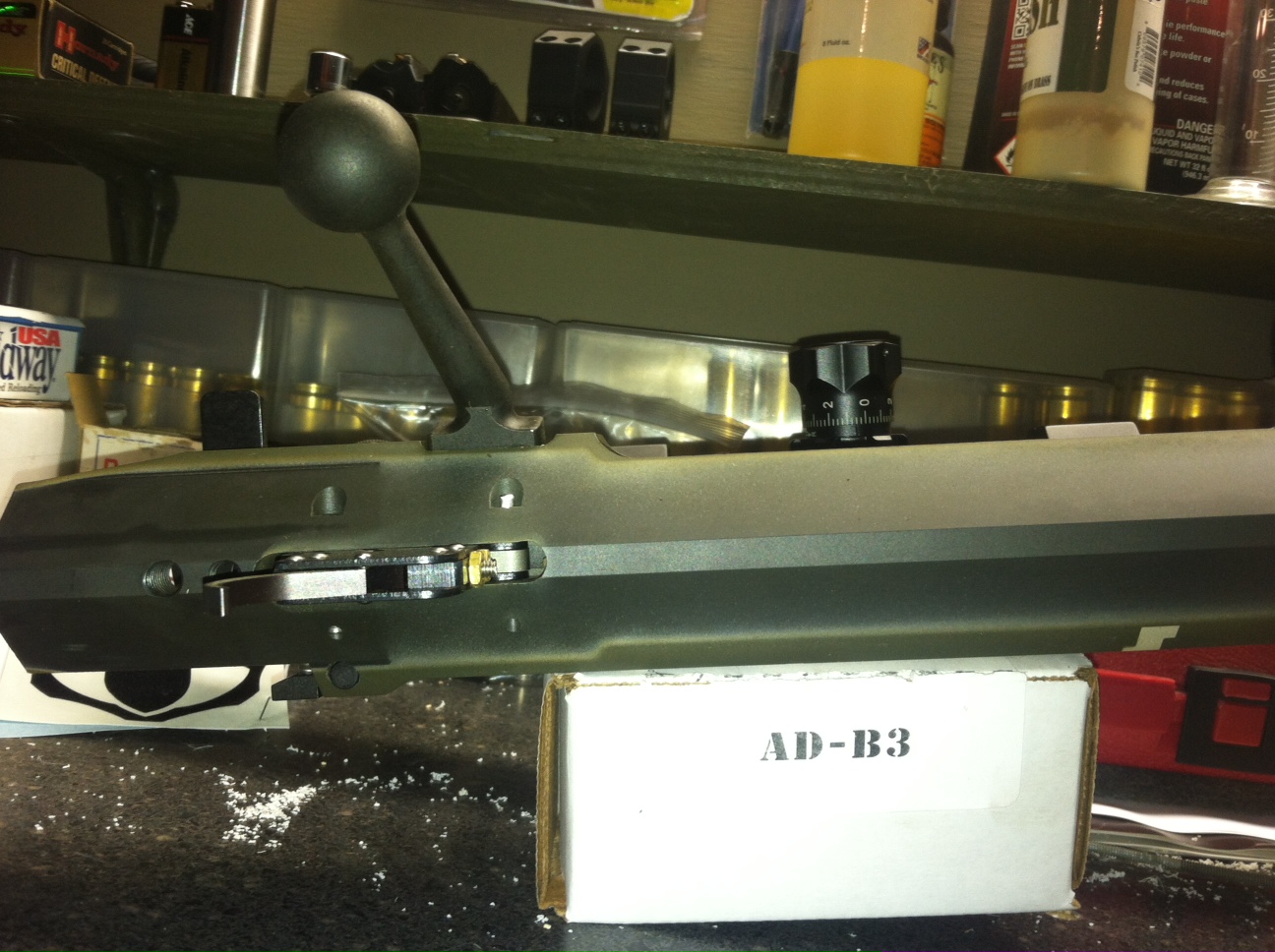

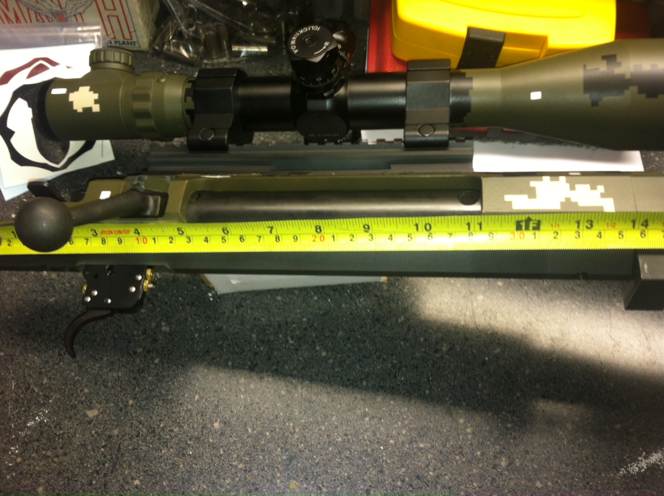

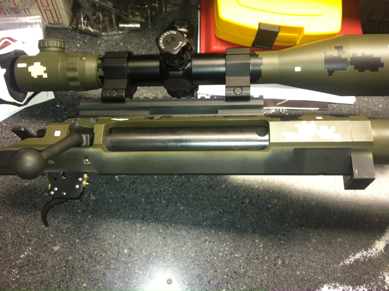

    I've included so pics of the action for anyone interested. I sent them over the Chad at LRI to see if we can come up with something. This is one Big Sum' Bich'. I forgot that it actually has a normal recoil lug setup. The wedge in the Armalite stock is in the front of the lug and helps hold it tight I guess.

    Tom Manners and I spoke earlier this week about this. There's a few different ways I can approach this. One is glassing up the stock to accomidate the tang and the other is machining the receiver's tang feature to better fit the stock.
    Either way is acceptable. The Armalight action has a big ass (tang) and could stand a diet. Look forward to messing with this, these jobs are fun.
