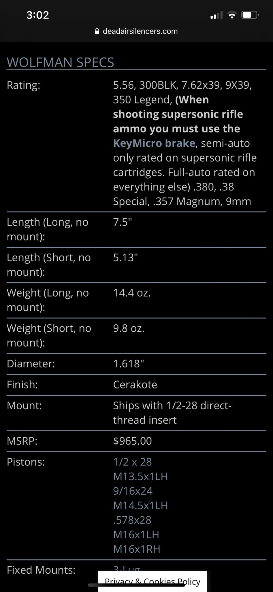

Suppressors Can for 5" barreled 300 blk?
Yeah just checked and short configuration is under 6”. No barrel restrictions with the key micro.

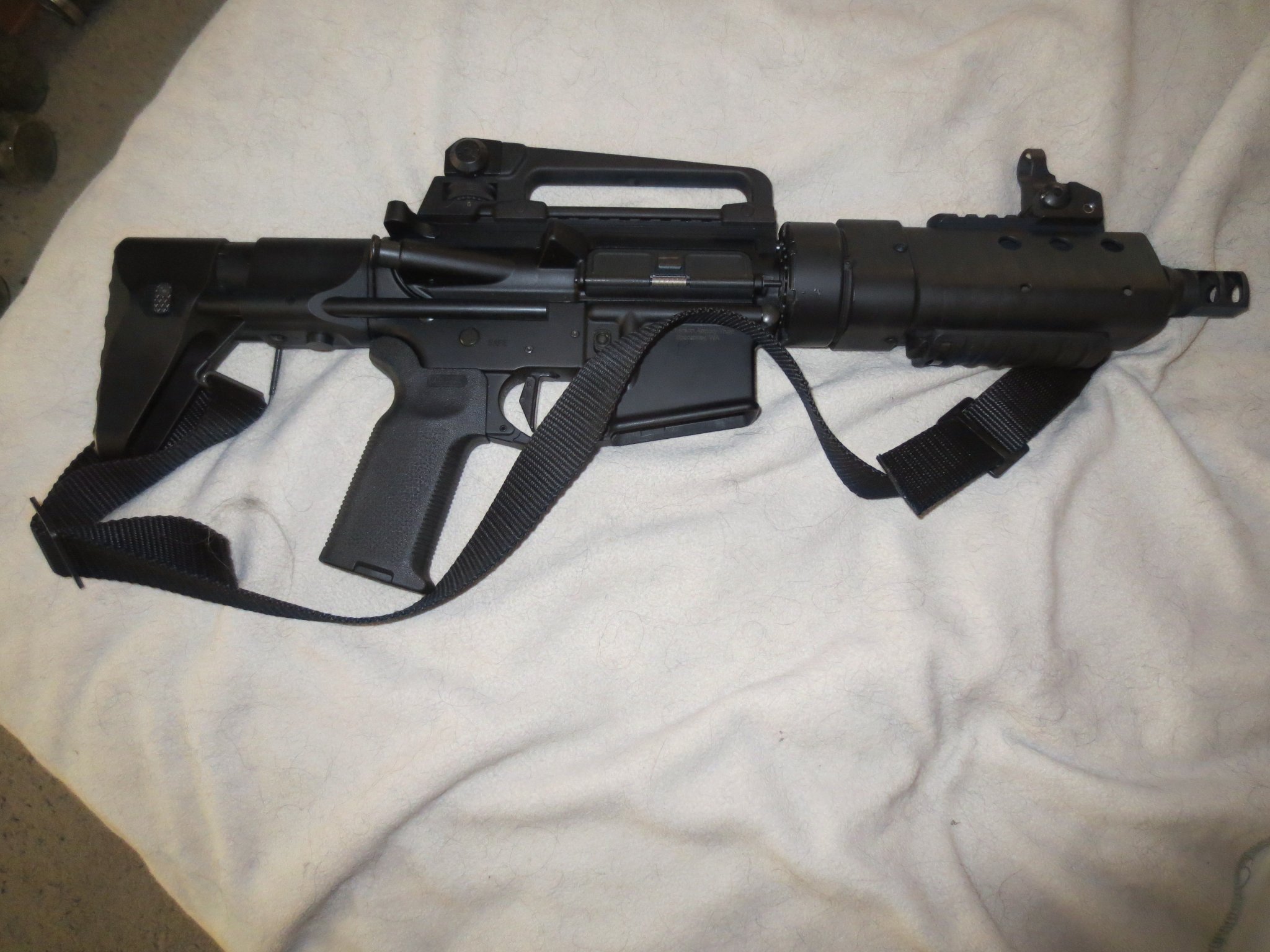

FWIW, my shortest one is an 8.2"bbl. PDW with a TBAC Ultra 5 on it (but I can always put the 30CB9 on it if I want more). This little fucker is cool. I think the thing is less than 2 feet long suppressed. It also runs supers or subs, suppressed or not without any hiccups, which to be honest I was kinda impressed with given the type of buttstock but these Noveske barrels are like fucking magic in SBR's man, only way to go IMO:

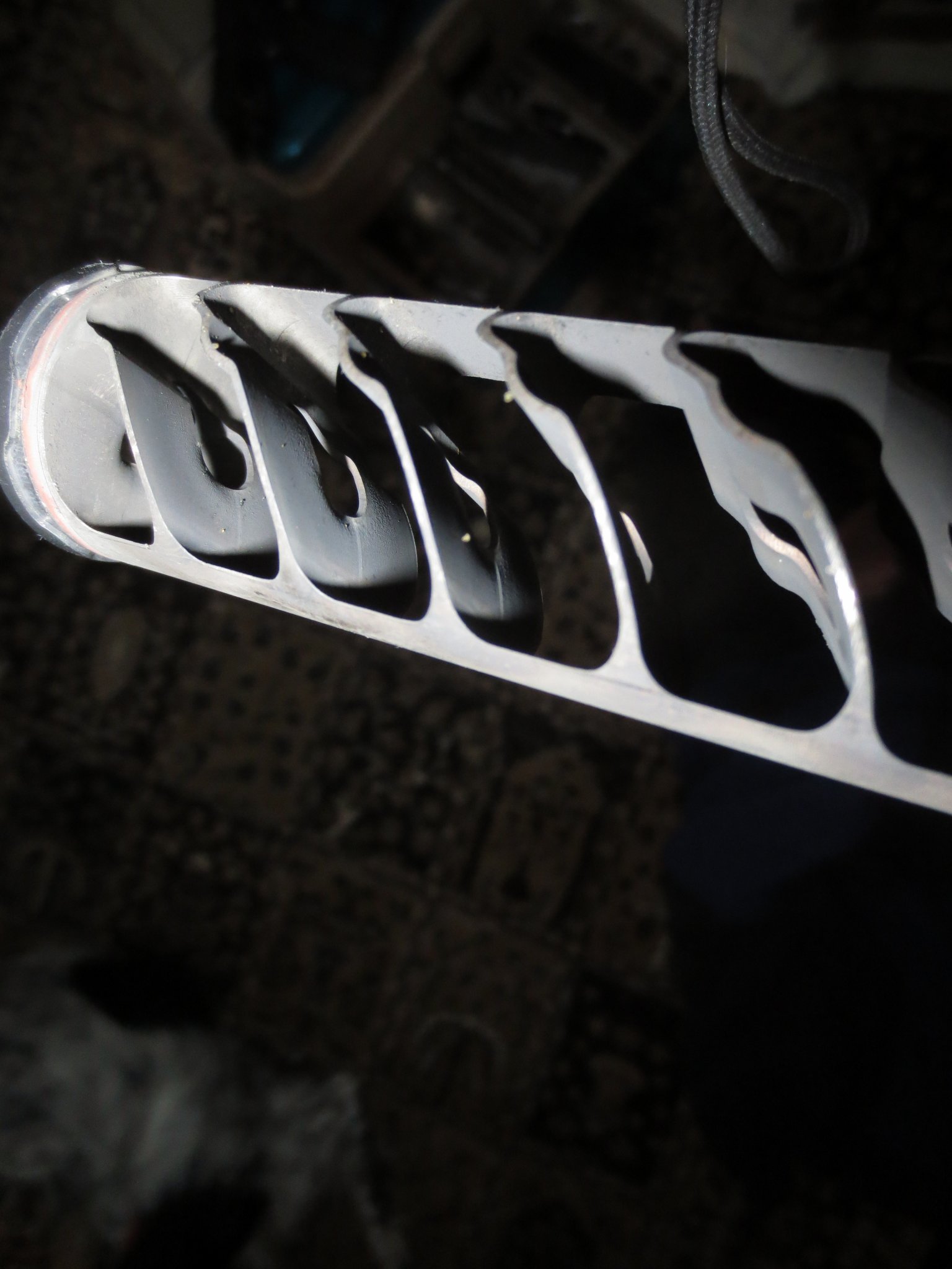

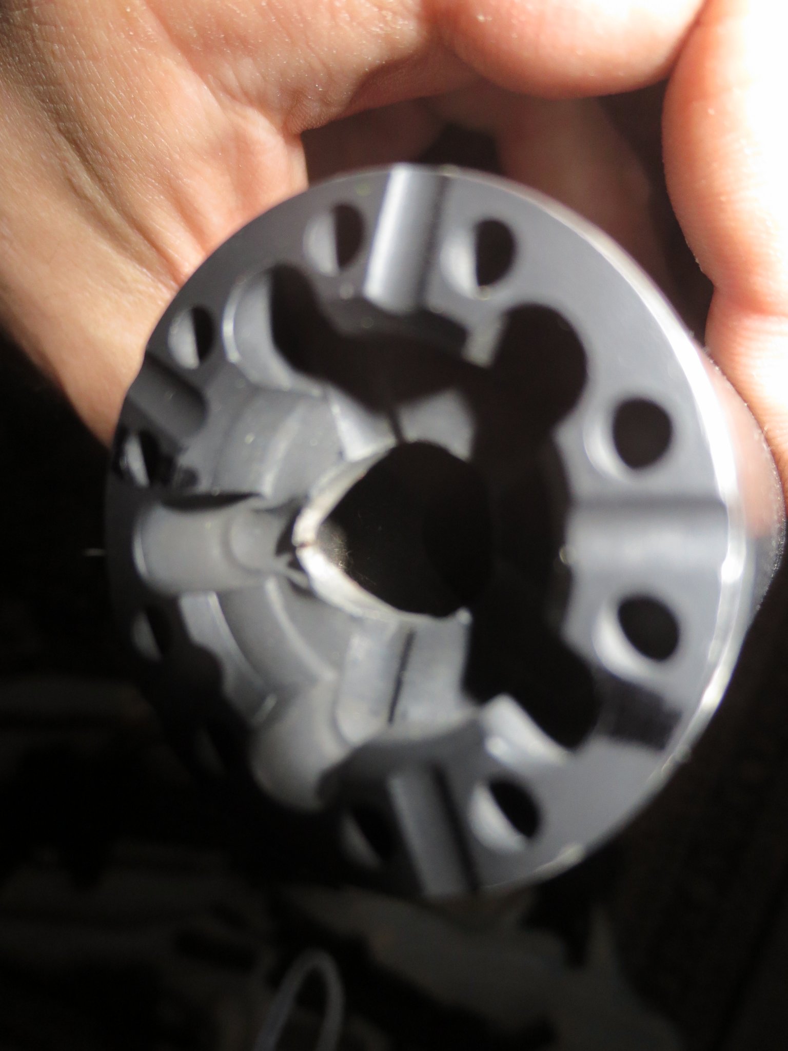

Want proof of fucked up ballistics?
Here's a strike on a Mystic X that was previously attributed to a possible loose mount. It was later found to be possibly due to 115gr. bullets with damaged tips. So two possibilities. The second though seems more apt (the can was just installed and tight, less than half a mag ran through it, zero previous problems, I don't think it shot loose...). So the bullet may have been stable in the barrel but the damage could cause it to wobble some later and looking back is probably the cause for the slightly keyholed shots that day.
If you notice the strike happened about halfway down the can, maybe 5" past the bore. It wasn't much but it was enough to throw accuracy completely out the window and it had to go back to have the entire core replaced (basically a new can, big thanks to Liberty for unfucking it fast and for "just making it right").
