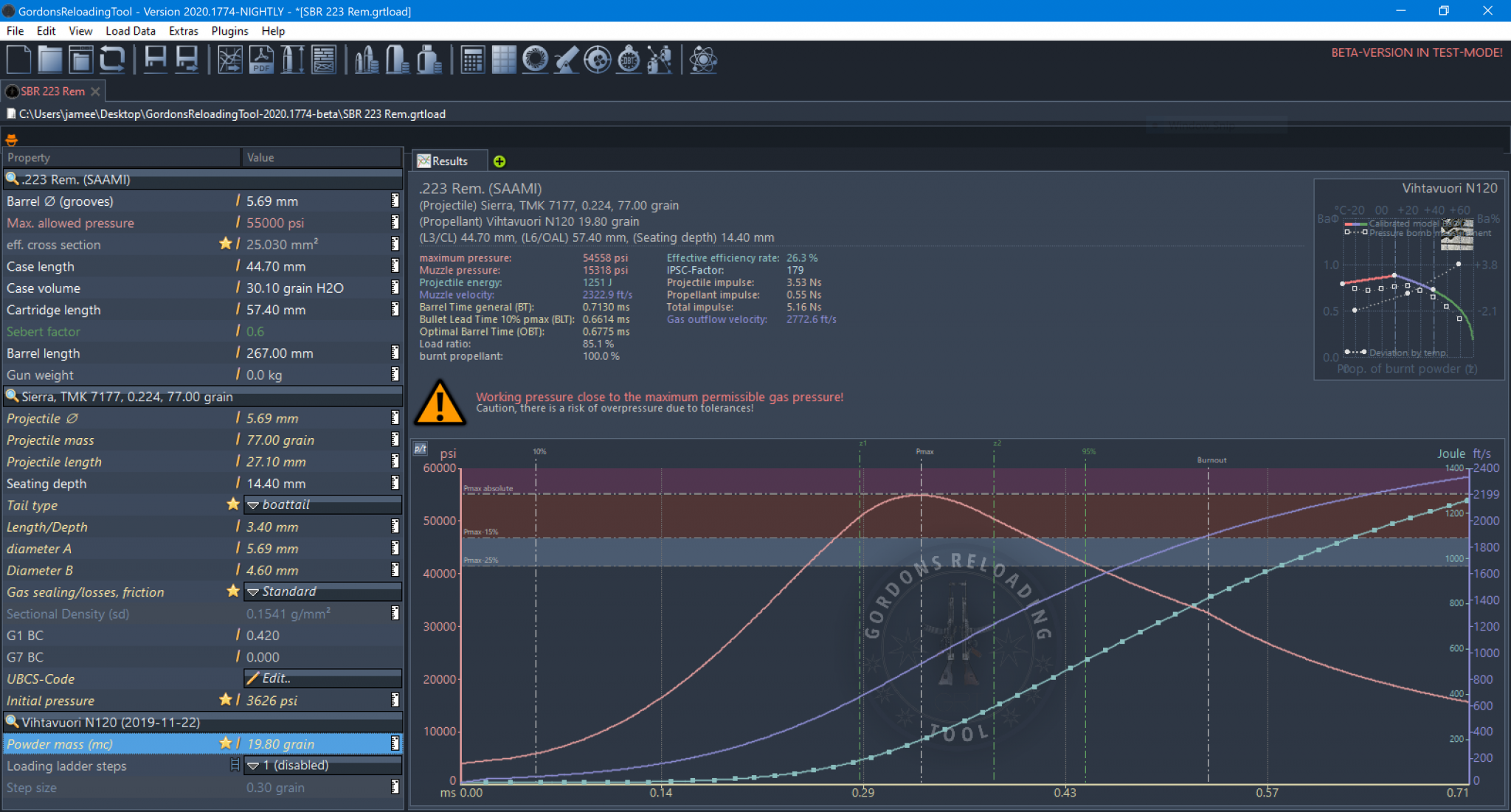

I don't have Quickload (I may yet purchase, but for a single exercise like this I didn't feel it was worth the expenditure) but I did download Gordons Reloading Tool (GRT) to do some analysis to see what might be interesting to try.
I played around with various powders, using a 2020 powder burn speed chart from the internet to guide me towards progressively faster powders. After quite a bit of trial and error I came up with the following proposed load (particular to powders I can actually find easily locally):
19.8 grains Vihtavuori N120 over a Sierra 77 grain TMK, loaded to SAAMI length (GRT does not appear to have a 5.56 cartridge in the available cartridges).
N120 is recommended for lower to mid-weight bullets in 223 Remington, so I'm not doing anything insane like filling the case with pistol powder. It is not suggested for heavier bullets, but in this case seems to work.
According to GRT, I should get 2323 fps muzzle velocity out of that load. This seems not terrible, and I am also showing 100% of propellant burned per the attached analysis:
So, can someone with more experience in this please help me out and walk through my rambling and tell me if I am at all on the right track? If someone would kindly check my math in Quickload, especially the pressure values, I would be very thankful.

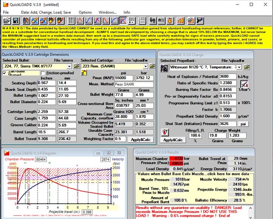

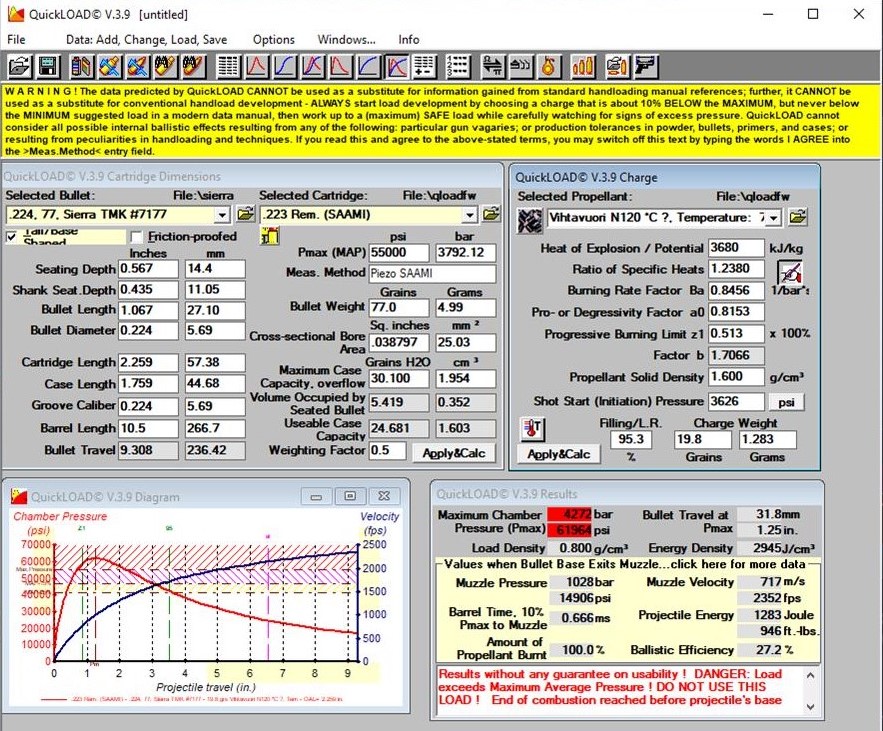

Running QuickLoad and the number are pretty much in line with what you're app is showing, except for a couple things. 1. Case volume of 30.1 gr of H2O is significantly higher that what QL has for a default volume (which is 28.8). So, you probably should measure your own cases (or maybe that's what you did???) as that 1.3 grs is a significant difference. 2. QL shows pressure at 61.964 psi with 30.1 gr of H2O and 68,635 psi with 28.8 H2O, so either one looks really HOT! Take a looks at the QL data:
Besides measuring your own cases for volume, you should chrono your loads and use the velocities you get to adjust the powder burn rate. Then the all numbers will be more accurate.
Fantastic! Thanks so much for running this for me. I am new to this kind of software, so I erroneously assumed some things like case volume I should not have. I will now spend a lot more time checking the numbers that are being inputted to the calculations.
