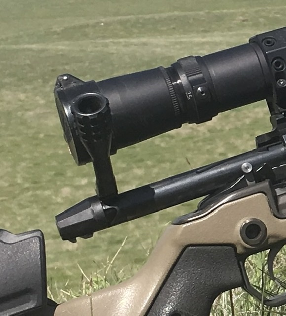

Yes you can, I prefer the surgeon style knob as well....... it matches fine but I think it needed a short piece of threaded adaptor due to both the bolt and handle having female threads.

Mine date to the first year of manufacture as both are sub 100 serial number...... I'm not familiar with the current spec but the thread title caught my attention as I've got the surgeon knob on my impact!

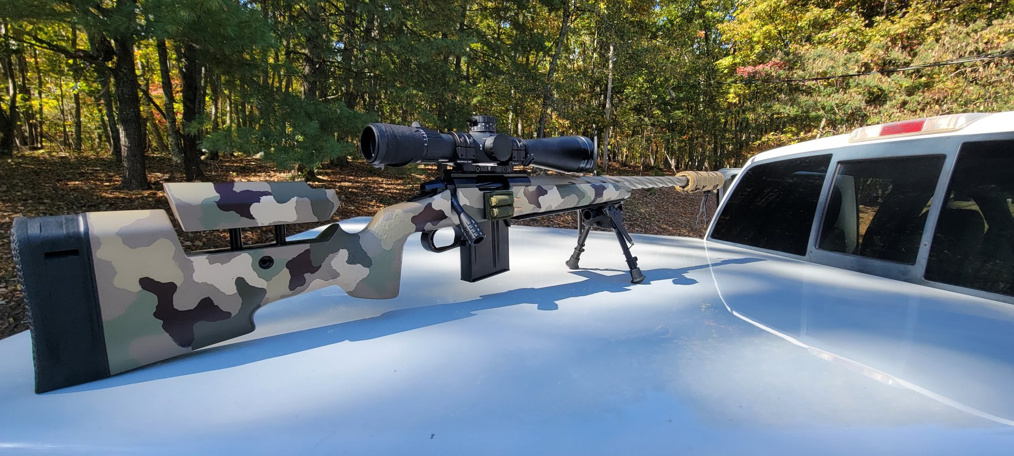

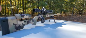

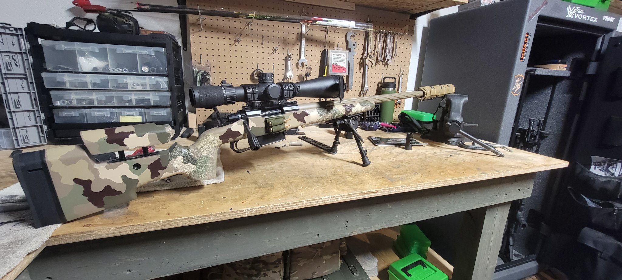

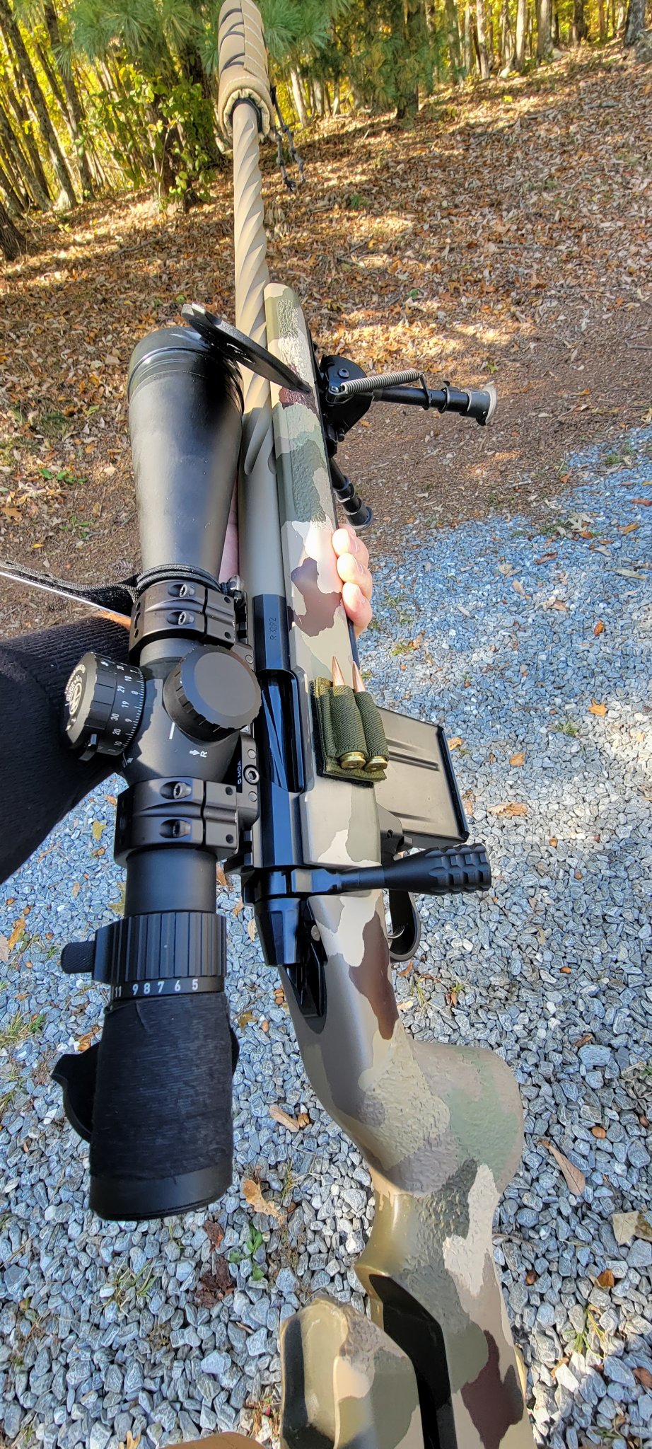

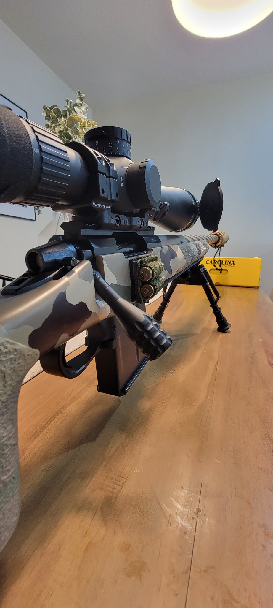

Surgeon 591 Style Bolt knob on my Impact!!! Absolutely fantastic. Love how this BR turned out 🔥
@Terry Cross
