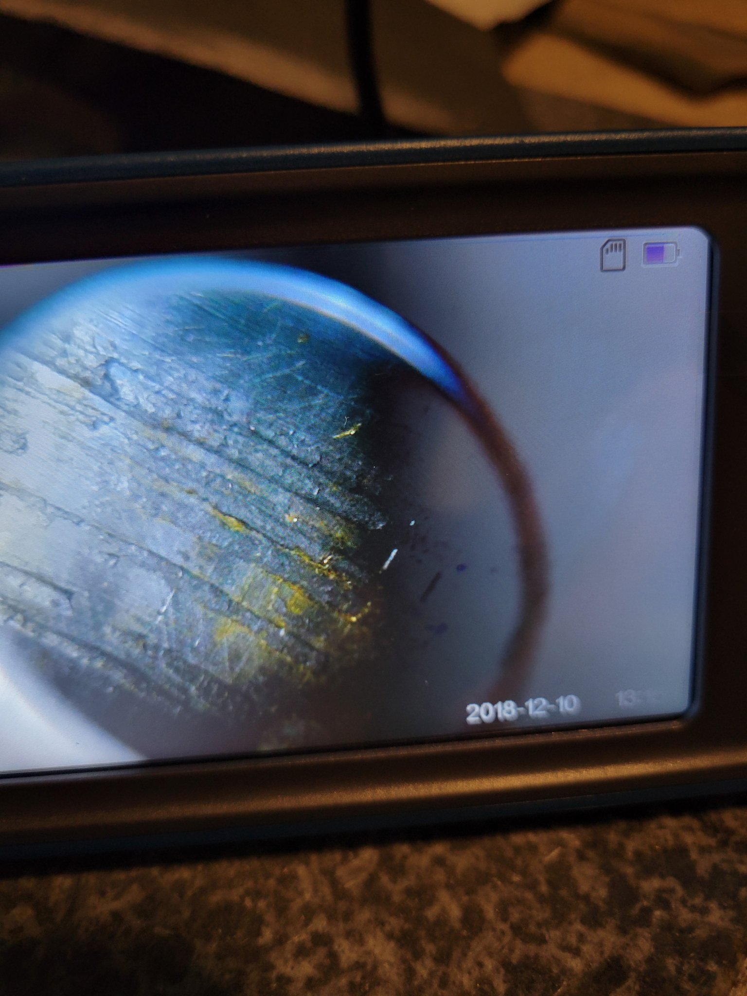

So... I made a huge booboo. Was shooting my 7-300 win mag and get a hugely overpressure round which results in not being able to extract the brass. Completely my fault, most likely issue with too much powder and bullet seating depth trying to chase the lands. But the main issue is my barrel chamber. I got the brass out then borescoped and it looks like brass residue in the chamber. To my untrained eyes the throat and rifling seem ok with usual copper fouling.
My question is, am I able to have the barrel set back and rechambered or would there be potential issues with the structural integrity of the barrel and better to just rebarrel?

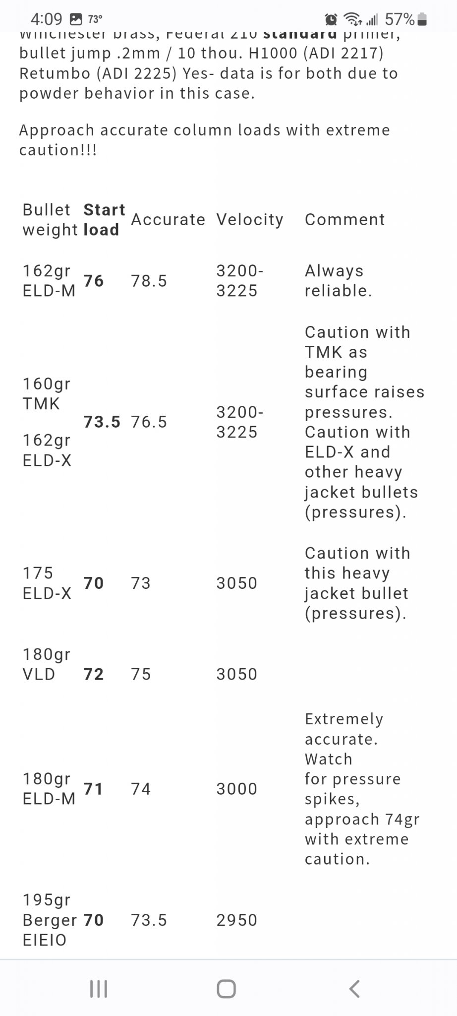

This might help load data from a 7mm-300 practical. Which is a improved version so it hold a little more powder.

So I got my borescope and saw this in the chamber not to mention a lot of longitudinal scratches. This definitely needs a rechambering job. So lesson to the wiser... Double check your loads haha.
Did your smith chamber your barrel with a dremel? What does the fired brass look like? From your post you make it sound like it's in one piece. Did it rupture? Looks to me like a shitpot chambering job. The steel barrel is going to be just fine long after your brass is extruded into your ejector recess and your firing pin is wearing your primer like a tophat.
ETA: The above was unhelpful. A rechamber job might be in order for you. Not because you had an overpressure round (especially if it the brass came out in one piece). But because it looks like you have rough chamber walls that will cause cases to stick as soon as your reach the elastic limit of brass. The brass will deform into the rough chamber walls creating a mechanical lock.
