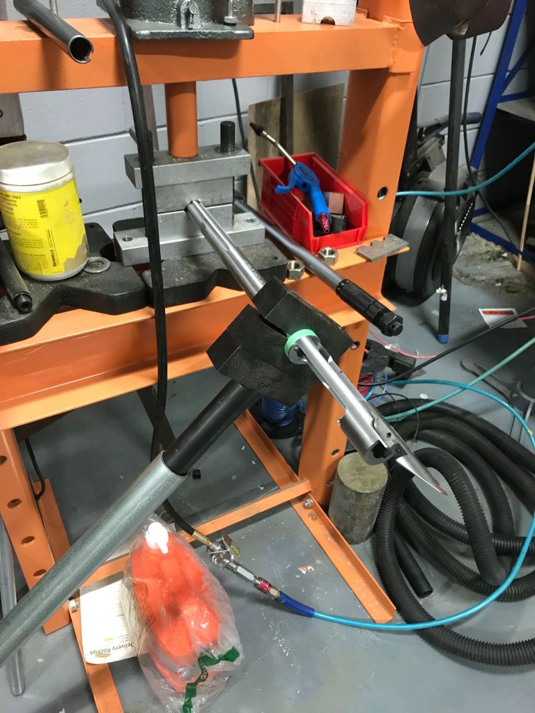

Getting ready to do my first barrel swap on a brand new Tikka. I'd like to keep the factory barrel in pristine condition so I can offer it up in the exchange. I have a big shop full of equipment (but no barrel vise) and I was thinking that I could pair a couple aluminum blocks in the mill and then bore down between them so I have a radius in each. I've got some rubber or leather I could line them with and then squeeze the setup in my shop press to hold the barrel. Seems reasonable to me; anyone else done this?

I see on rifleshooter.com he uses a shop press seems like it would work well .
tikka factory barrels are no joke they are on their tight as hell. I would use rosin on the jaws, leather or rubber will most likely slip. I use a Wilcox action wrench on a tikka and you will most likely need a cheater pipe on the wrench handle.
Are they torqued on tight or is it a thread locker that makes them so tight?
