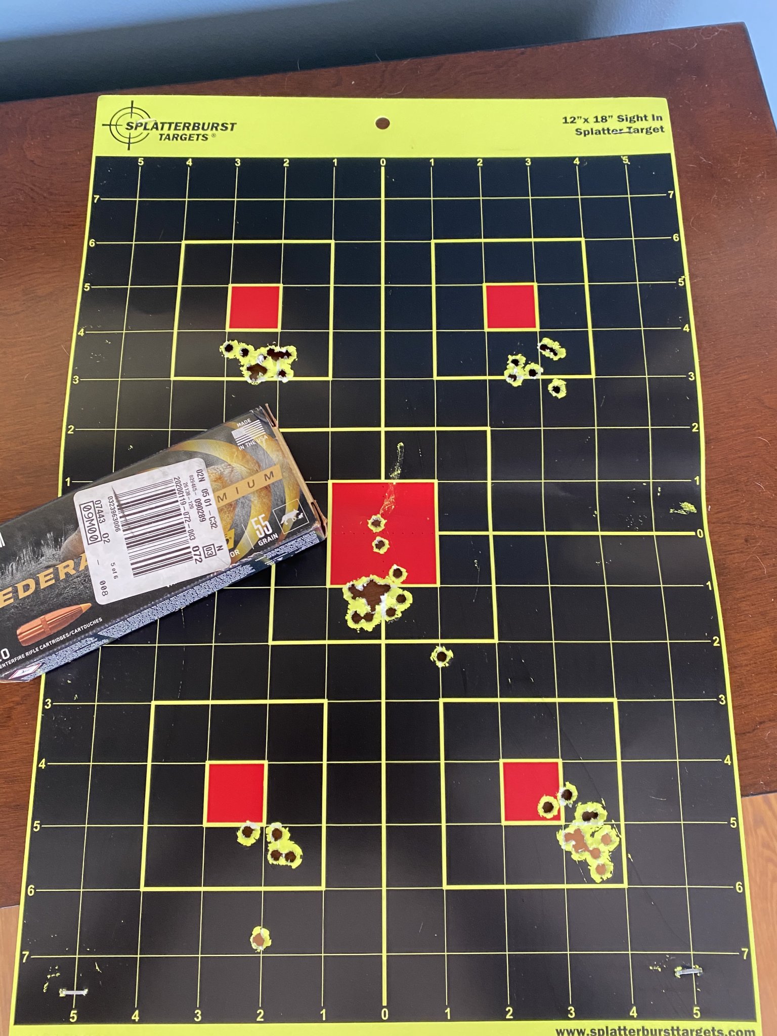

I'm somewhat new to this long range shooting. I did shoot a PSA 16" ar15 using this same scope and mount and I believe my groups were very close.
I built an ar15 rifle with a Faxon 16" pencil barrel. LaRue MBT 2s trigger
Barrel link: https://faxonfirearms.com/faxon-16-pencil-profile-ar15-barrel-5-56-nato-nitrided/
Steiner 4x optic.
AMMO is Lake City 5.56mm NATO XM193 Ammo 55 Grain
Ammo Link: https://www.targetsportsusa.com/tar...metal-jacket-1000-rounds-m193bk-p-110074.aspx
Using sand bags to help stabilize rifle.
I re torqued the scope bolts, The barrel nut was torqued to around 60 ft lbs. , I ran many patches down the barrel and then a clean patch.
Definitely holding rifle at center of target at 50 yards.
At 50 yards here are 3 of my groupings, I shot 2x at each target. Something just seems off and groups seem really large.
Are these definitely bad groupings at 50 yards and is my barrel most likely the issue?
How would you deal with this issue and can I return this barrel to Faxon?
Thanks for any advice on dealing with this issue,.
50 yards, each box is a square inch.

we’ve been harping about how surplus ammo isnt precision based, and I tried to find you an example.
In the attached picture there’s 3 x 3 shot groups. The bigger one of the right is surplus ammo out of a $400 match grade barrel. The 2 smaller ones on the left, is simply loading a better bullet to match grade standards. This was at 100yds mind you, but shows you that even high quality barrels will only shoot so well with ammo that isn't suited for it.
Unfortunately man, its RARE to be able to buy a standard style AR-15 barrel and expect precision shooting out of it. That being said, if you don't have the cash to get a better barrel, and you're not expecting to take it out to 600yds with amazing success, you can still have fun with this barrel, and learn to shoot better with it, then upgrade later

At 50 yards that is bad. Let a good AR15 shooter try the rifle first before anything else.
This^^^^^^^^^^^^^
For God's sake, he's shooting 50 yards..............rare to have even XM193 shoot that badly, & the 2 shot groups are moving around.
Could easily be the shooter, bad scope, or both................even really shit AR barrels will normally do better than that at 50 YARDS. Not possible to shoot that stock consistently, but it is only 50 yards, should be able to do much better.
60 ft/lb if torque is heavy, but unless he broke something, if done right, should be OK.

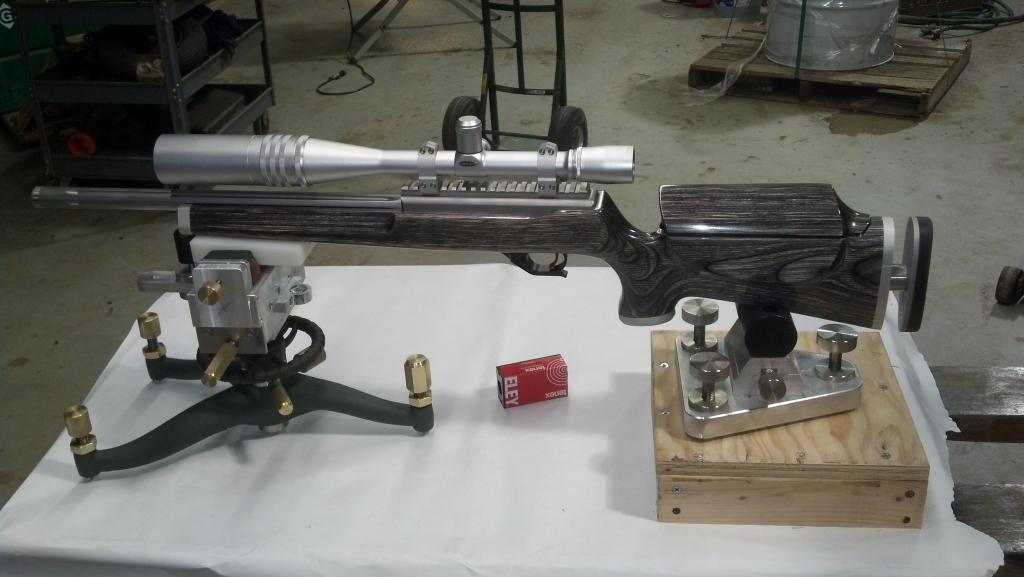

Get a rifle sled and set it up and just pinch the trigger to take out any of the human effect and shoot a 5 round group and that will tell you if its the rifle is ok or not.
Please post pics of groups that you've personally fired from a semi-automatic AR-15 using a "rifle sled." In the meantime, here's a pic of a 10-shot group fired from an AR-15, shooting off of bags, at a distance of 100 yards, using a lower receiver with a pistol brace.
Reactions: Gustav7 and JS8588
Sand bags will
Never fired a AR15 off a sled this was was set up on a custom built 10/22 . The front rest has micrometer adjustment as well as the rear rest , a little more accurate than a rifle sled.
The groups with more holes on this target are from my off-the-shelf Ruger AR-556 (16" barrel, 1-8 twist) at 100 yards equipped with a cheapo Vortex China scope and shot off of a Harris-copy bipod and a sock filled with rice for a rear bag. I wasn't trying too hard on some groups, as you can see by me walking up a little as I shot faster. The smaller (in number of rounds) groups are my .223 bolt gun (22" barrel, 1-9 twist), which WAS NOT a fan of these rounds. Those groups were VERY try hard. Personally, I would not buy this ammo again. I can get the same groups (or better) from much less expensive factory ammo. Was on sale for a reason.
FYI: I don't aim for the red squares and the two holes in the big center red square are one shot from each gun to validate a good enough zero before leaving.

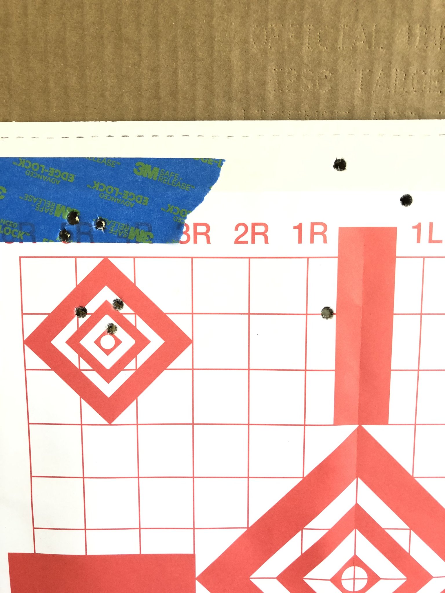

I went to the range today. The only thing I did was quickly clean the gun and barrel quickly before heading to the range and put on a different stock. I used the same 5.56 Federal, but also tried some Wolf Gold .223 ammo.
I guess it must be me then, I didn't think I became that much of a better shooter. I wonder if it had to do with the rain and foggy glasses. It did seem overall easier to shoot today.
The groups labeled with 5.56 and Wolf are from my AR15, I wasn't about a couple of groups so I didn't label them. There is one black target which I labled 100 yards with 3 shots from the Wolf ammo. The other targets are at 50 Yards.
This is using the same Steiner 4x scope.
I guess these groups look normal with the ammo and barrel I'm using?
50 Yard groups. The groups not labled are probably from my ar15, but I can't be sure if they were from my 308 or ar15.
50 Yard Groups
100 Yard Group circled. I was aiming dead center.
Ar15 on left. The scar 17s is difficult to shoot with the 24x scope, the trigger is awful and very hard to press and the gun shakes a lot, I can't steady it on target for some reason. I used the 24x magnification at 50 yards and 100 yards with the scar17s.
50 Yard Groups
Just a question: are you breaking your cheek weld at all between shots in a given group for any reason?
Also, why is the SCAR 17 “shaking”?
24x magnification is a bit high for these distances so perhaps the tiny involuntary movements we all have to some extent is being magnified by the optic?
I use 10-14x when shooting targets at a grand depending on conditions. I’d turn the magnification down to about 8-10x at 50/100 yards and ensure you have a well-rested/supported position. Then I’d work on your breathing. You should be breaking your shots at the bottom of your natural respiratory pause once the x hair comes naturally to a rest right over the target after exhaling. That’s when the body is most at rest...at home, work on dry firing exercises, ensuring you’re not pulling, pushing or slapping the trigger. Should be a symmetrical squeeze straight back every time. You can do this indoors on 1-2x magnification (referring to your AR15) if you have some space.
Can’t argue with you on the SCAR trigger, lol. Perhaps someone more familiar with that platform can recommend a trigger upgrade.
The 5.56 groups look reasonable given your set up but I bet you can tighten them up a bit with some more practice on the fundamentals.
If you haven’t already done so, I’d consider signing up for the on-line training. Lots of really good information for shooters of all skill levels.
Yes, I was breaking the cheek weld pretty often the first time around. Is that bad to do?
Unless there is reason to (weapon malfunction or sudden distraction requiring your immediate attention) always maintain your cheek weld as long as you are on the gun. Come off only when you have completed that particular group or have to reload and can’t do it while still on the gun. Between that and your disclosure in post 14 (only making contact with the shoulder) explains the large dispersion.
still would like to get to the bottom of the case of the shaking SCAR, lol.
