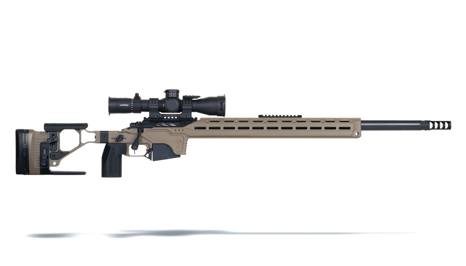

So I have an itch to build a long range rifle. I have a Ruger PRP in 6.5CM, Savage .308, and a savage 110 in 338LM. I generally shoot 800-1200 yards. I was looking at picking up a SA 700 clone with .308 bolt to drop in a chassis. I dont compete and I prefer prone to a bench, but if I wanted to try out a local PRS match I wouldn't want my chassis to be the limiting factor.
I really like the minimalist styling of the AT-X chassis but it seems to get a lot of hate from people. Why? Is it that bad, or is it just not ideal for PRS?Ideally I want a folder. Should I just suck it up and get an MDT ACC or something else?

If you want local, excellent support, with a plethora of parts and attachments that are not proprietary, go MDT ACC Elite. Heck, you could message @MDT_OFFICIAL here if you ever have issues and they will square you away.
If you want minimal access to parts and proprietary attachments, get an AI ATX.
As noted, AT-X is a good choice. Keep in mind it is not M-LOK. MDT makes a good chassis. For kicks, I would also look at the Cadex Strike Pro.
Once you pair with a good action and / or barreled action, your shooting will probably improve. Personally, I still have a Savage LA, and think it is underappreciated, but pair up a great chassis with even a Bergara or Tikka barreled action, and you will think you have moved from driving a Honda to a Masserati.
I definitely think that MDT is going to offer better customer support if you had an issue.
Otherwise I'll second the post above that said that the AT-X will not be a limiting factor.

I like MDT overall very much...but, would suggest looking at the Vision Chassis for comparison. Yeah, bit of money but I think that by the time you add the top covers and vibration dampers I believe they come out to be very close in cost.
Gulf Coast Precision is their US distributor (think I got that right and I've had very good experiences talking/ordering from GCP).

I love my the atx aics chassis ergos. Have 3 and an ai atx rifle. Also have a few acc elite. The only advantage mdt has is slightly wider forend, and the mlok VS keyslot/keymod whatever. But once you add some ai weights or sawtooth side Trax the forend width advantage is nil. The bore height to arca rail dimension of the atx is only bested by xlr envy pro. Both these chassis track very well under recoil off of a bag.
