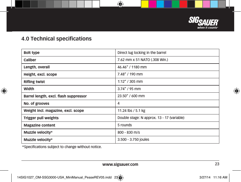

I have a SIG SSG-3000 which I love, have been shooting it for 5 years, fits me well, shoots like a dream, has the 24" barrel.
The twist rate is 1:11, and is spot on accurate with the 175 gr Federal Match, largely one hole
at 100 yards, and repeatable data out to 1,000 yards.
SIG also made a short production run of the same rifle in the 18" barrel, but keep the twist
rate the same, 1:11 (also seen it given as 1:12), despite a nearly 25% reduction in barrel length.

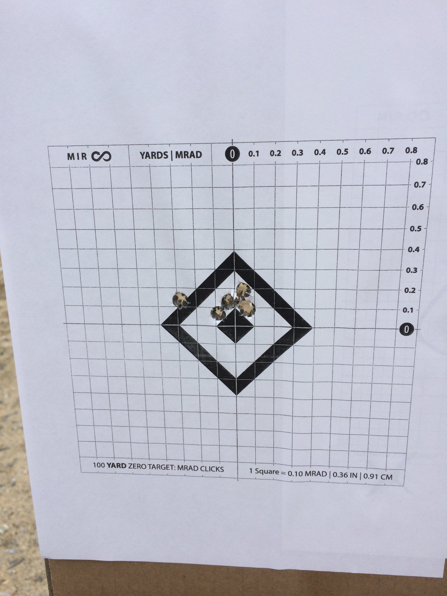

Same model gun with the 24” barrel shots nearly one hole groups, the 18” barrel is still a tight group, but more like .5-.7 MOA.
The 24” vs the 18” is nearly a 25% reduction in barrel length, yet retains the same twist rate. I actually wanted to shorten it to 16”.
Group appears below, and yes it is consistent across multiple days and range visits.
My notes show that the shot at the left side of the diamond was the initial CCB.
May not be the rifling data, may be barrel or crow defect, though I can’t see it. See below.
Thanks!

You didn't mention if group size is linear as distance increases, i.e. 1moa@100yds, 2moa@200yds, etc., if so this would point to a barrel that is simply less accurate vs a stability problem.
Good data, thank you!
Yes, the group progressively opens up as the range increases, which happens even with a tighter grouping.
I’m just not happy with the size of the group at 100 yards, and being that large at 100, it of course gets worse further out.
