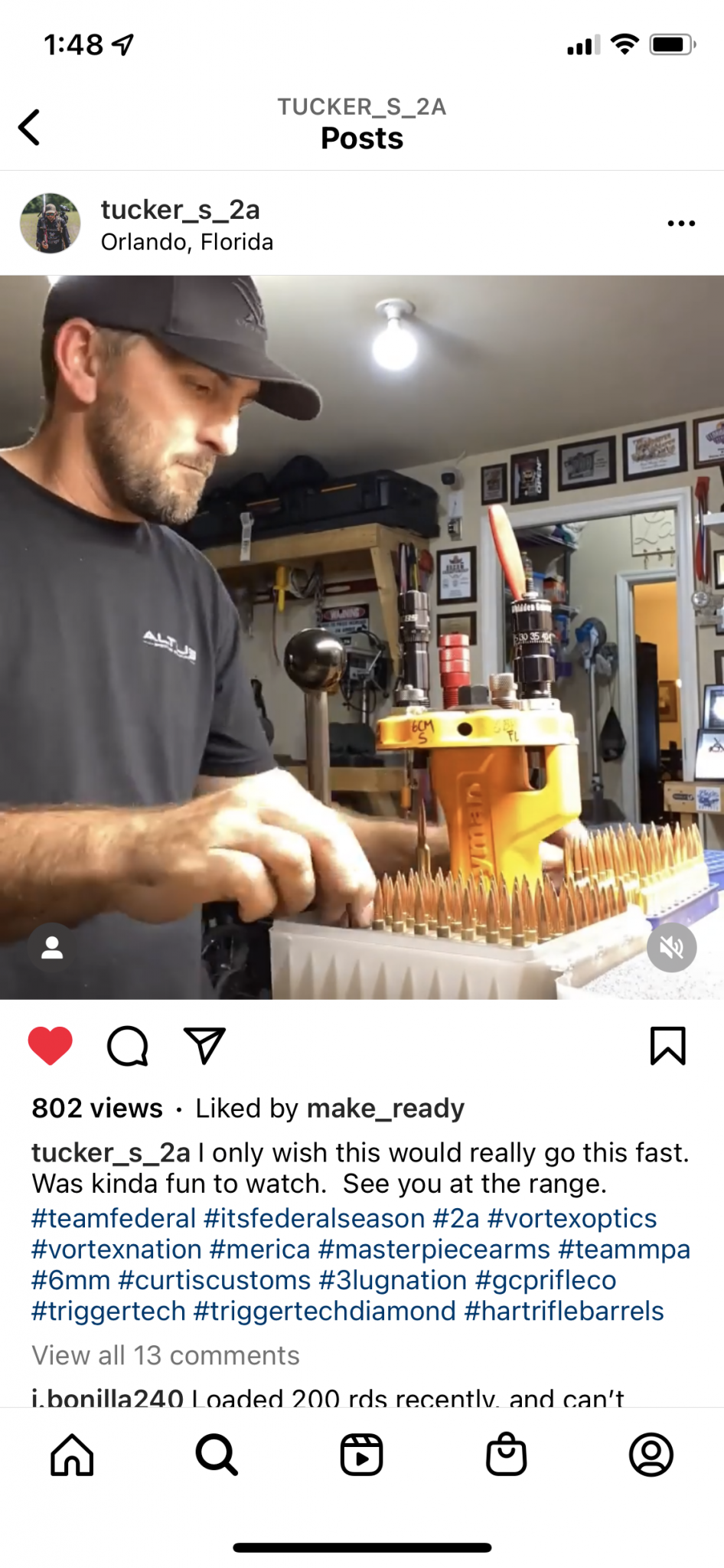

Tucker Schmidt won the 2020 and 2021 Pigg River HAM matches and finished 4th in 2022 shooting Federal factory 6 Creed ammo.
Interesting, because IG shows he handloads, and says in his post that he was running 6GT back in 2020.
