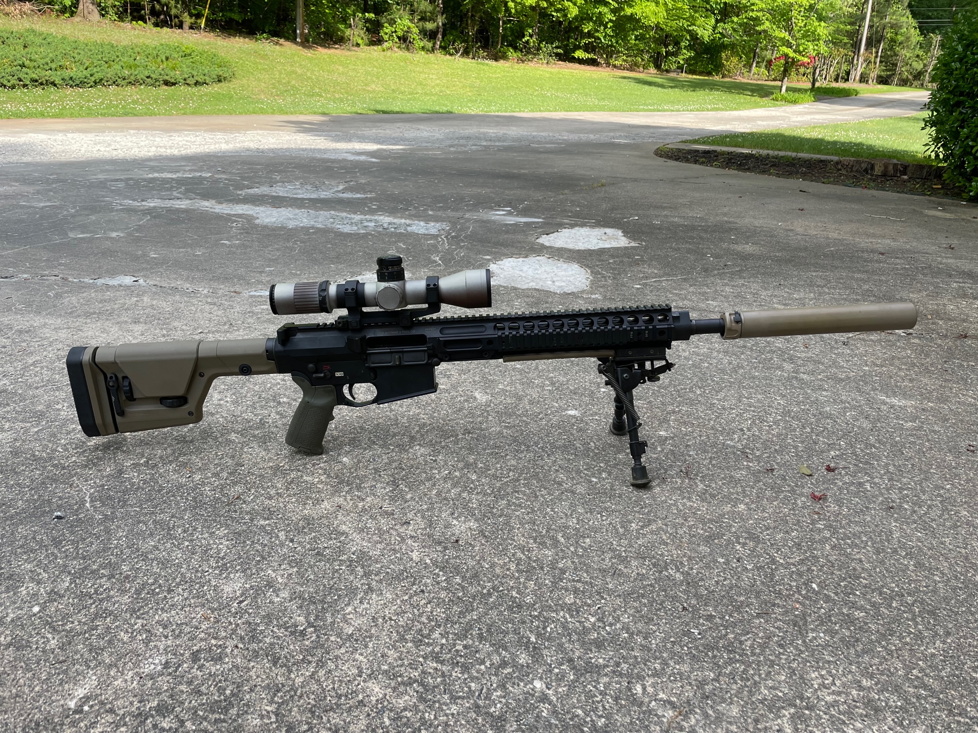

Yes, this is possible to swap a fixed LMT factory gas block for an adjustable.
Here's one I did on an MRP barrel. The reasoning is because the barrel itself is overgassed, that coupled with the AEM5, it's obnoxious.

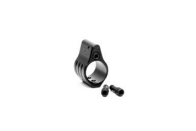

This particular one is a newer SLR one that uses straight tubes and has changeable gas jets. I would recommend using an Superlative Arms adjustable gas block if it is going to end up inside the rail. It's one of the few on the market with a compact and symmetric size that actually fits inside an LMT rail.
Cool! That looks great.
