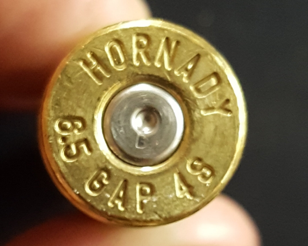

I bush all bolt and turn firing pins to nominally .060 up to and including 338 LM. Never had a problem. Love the lack of cratering. Here is 6.5 SAUM fired with a .060 firing pin with a nice clean dimple in it.
