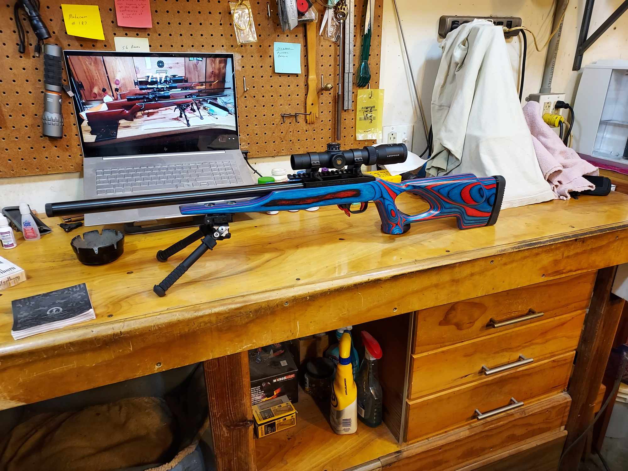

Sorry, I at times lump Ruger into a category. I've tried LVT, along with the old target models, and lately this one, 2024 US shooting team with an 18" target barrel, still a Ruger.

Minuteman - Gotta ask - how accurate is that spiderman/olympic 31180 rife at 50 yards ? Currently on the fence on purchasing one. Side note - worked as a motor man out of Gillette in the 70's. Cured me from staying there in the winters. thx b
