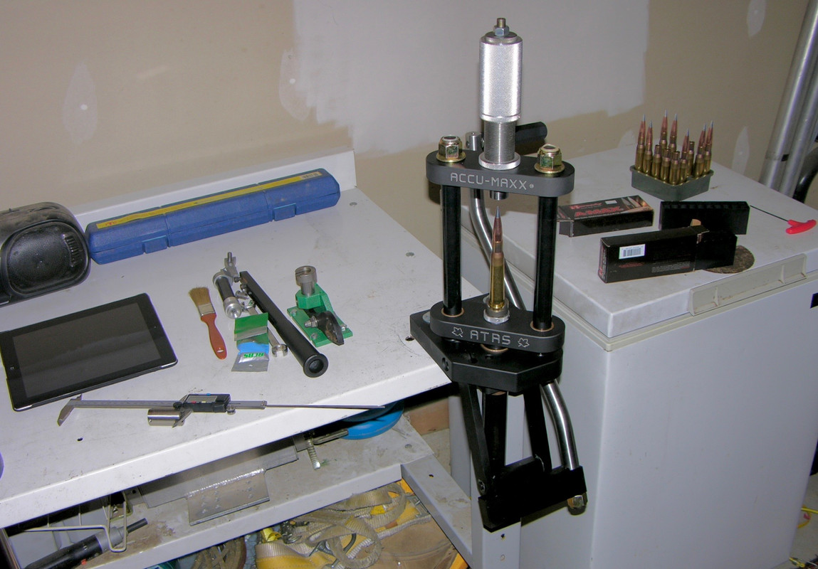

Sean, I‘m not familiar with the German press, but I’ve owned the big ATRS press. My focus on that press was the BMG round. CH4d dies fit beautifully with the bigger threaded press. I own a Co-Ax and love it’s torque and leverage when loading up to the .338LM case. The ATRS rig‘s leverage is off the chart with any press I ever tried. The machine work is wonderful and it is very robust. But, you can still feel your way to priming, sizing, and seating. It’s that smooth.
The only concern I would have is you being in the USA . I am close enough that I picked up my press in person. I had a talk with someone who had it shipped to their home. It arrived damaged. It is very heavy. And it is fully assembled. When I picked mine up, there was no packaging. I tossed it into my car’s trunk. I wasn’t comfortable with that. And the fellow I spoke with wasn’t comfortable either. Since his arrived damaged. Where I’m going with this is, that press would need some heavy duty packing to survive a shipping trip. No matter how long or short it is.
I’m sorry I don’t have experience with the German press to give you an honest comparison. But I would recommend the ATRS one. If you’re using it for smaller threaded dies, seaters, and the like; then you’ll need some adapters. It can be a pain finding them. I used a smaller threaded de-capping die, and had a terrible time finding one. In fact, I needed to get one made. (Just an FYI.)
Here’s a pic of mine in action loading the big case...
The darn thing is so big and heavy that I couldn’t mount it in my loading room in the house. I was restricted to the shop and the big bench.
oooo....I just noticed how old this thread is. Sorry.
