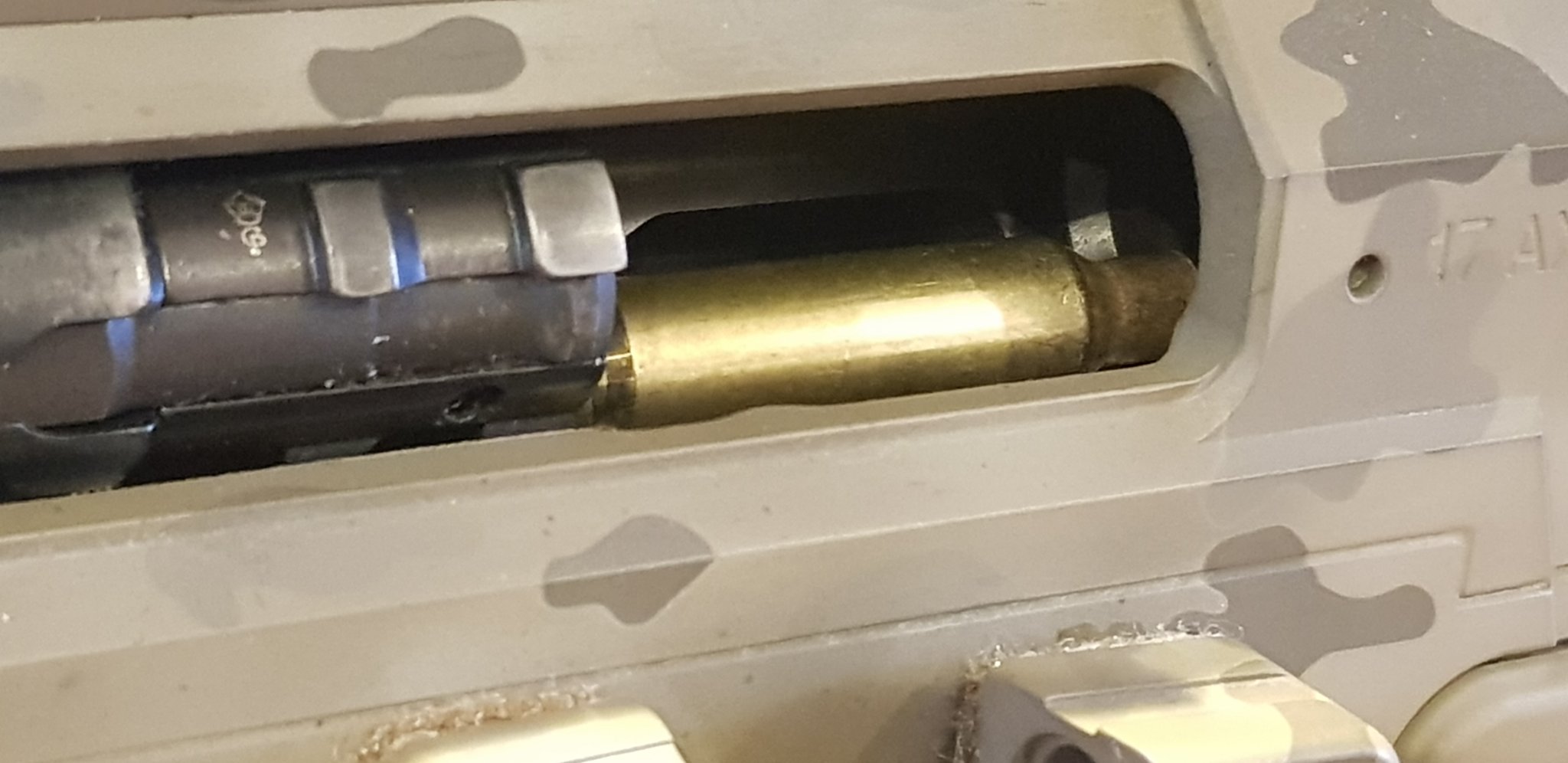

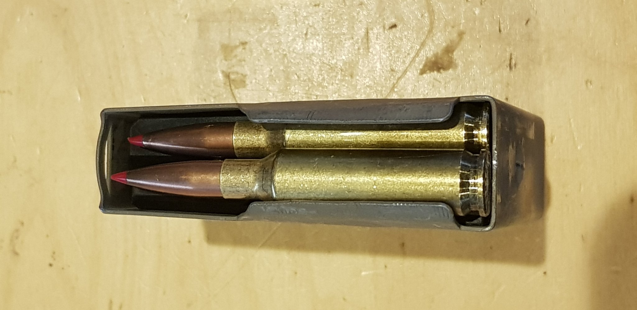

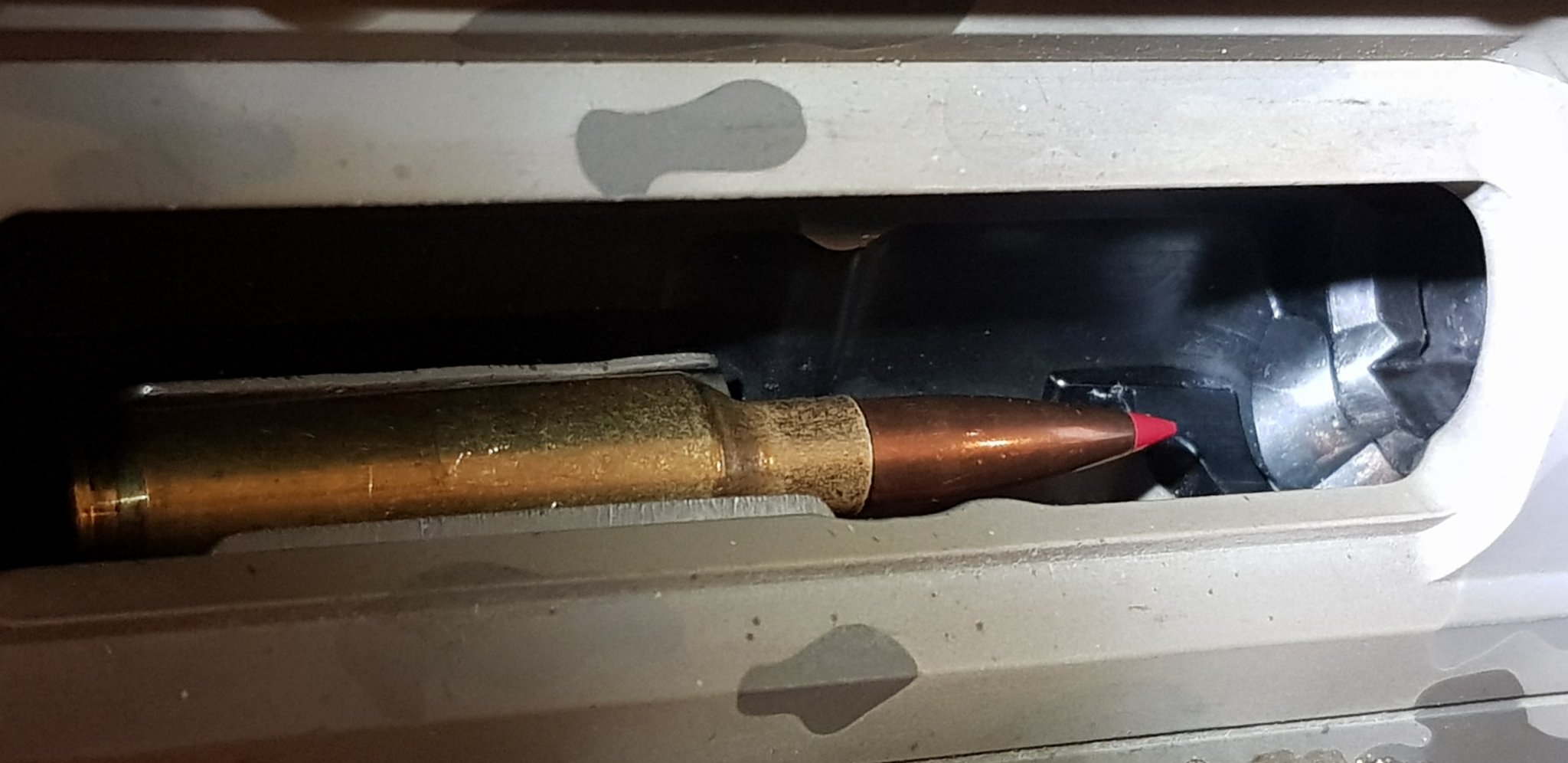

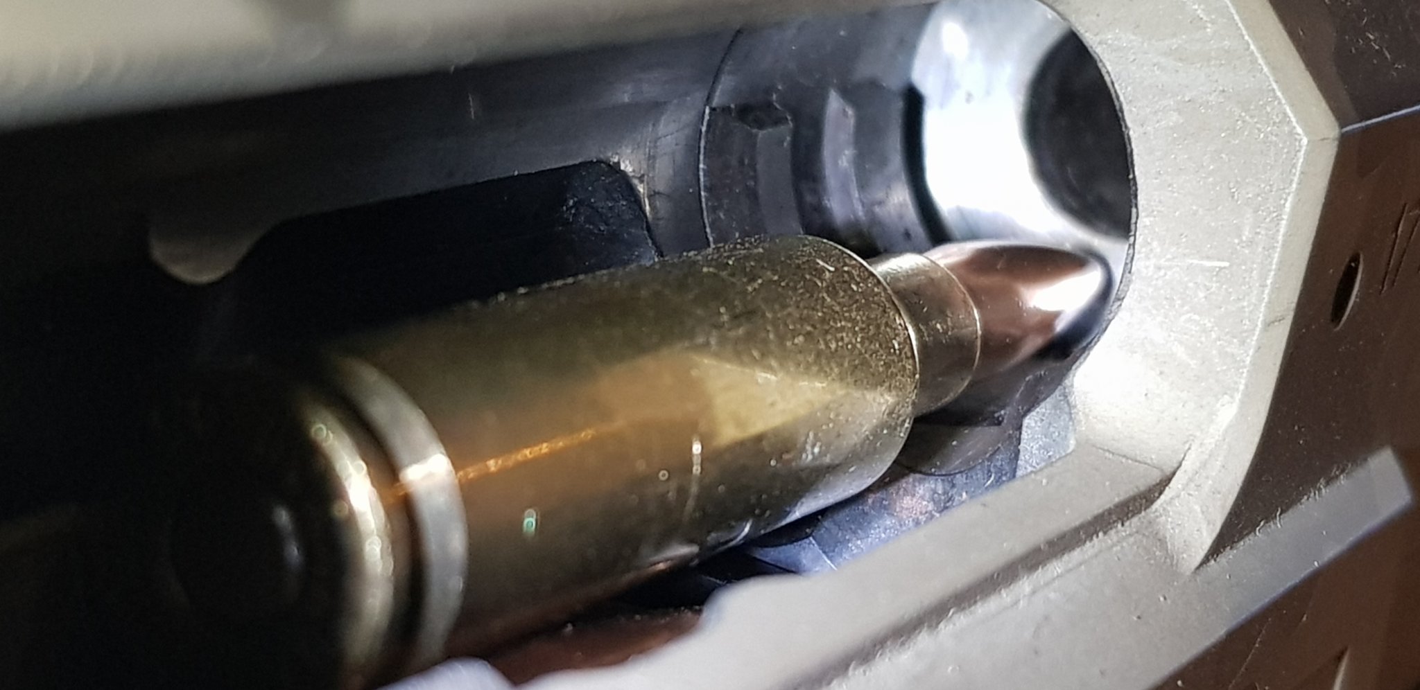

Hi Guys
Some pics attached of the problem.
Thanks
have you tried a newer mag? those things look beat to shit.
Look at the feed lips on that mag. They’ve clearly been fucked with.
My thoughts exactly. The beat up conditions of the mag lips and maybe a long COAL is what it looks like to me(?). Kind of hard to diagnose from a few still pictures....
True learning question for me on this, for those pointing to the feedlips, is it the thoughts that the lips are bent in a way that it isn't letting go of the round soon enough? Or am I misinterpreting?
Without calipers and multiple measurements across the feed lips (and other measurements, like the height of the lip, gap width, etc.), it's hard to say. Looking at one pic, you can see someone used some pliers to adjust the lips a bit (can see the teeth marks), which means it's anybody's guess where the feed lip actually was bent (just the lip, or the lower side wall of the lip, also where it was adjusted along the length of the lip matters too).

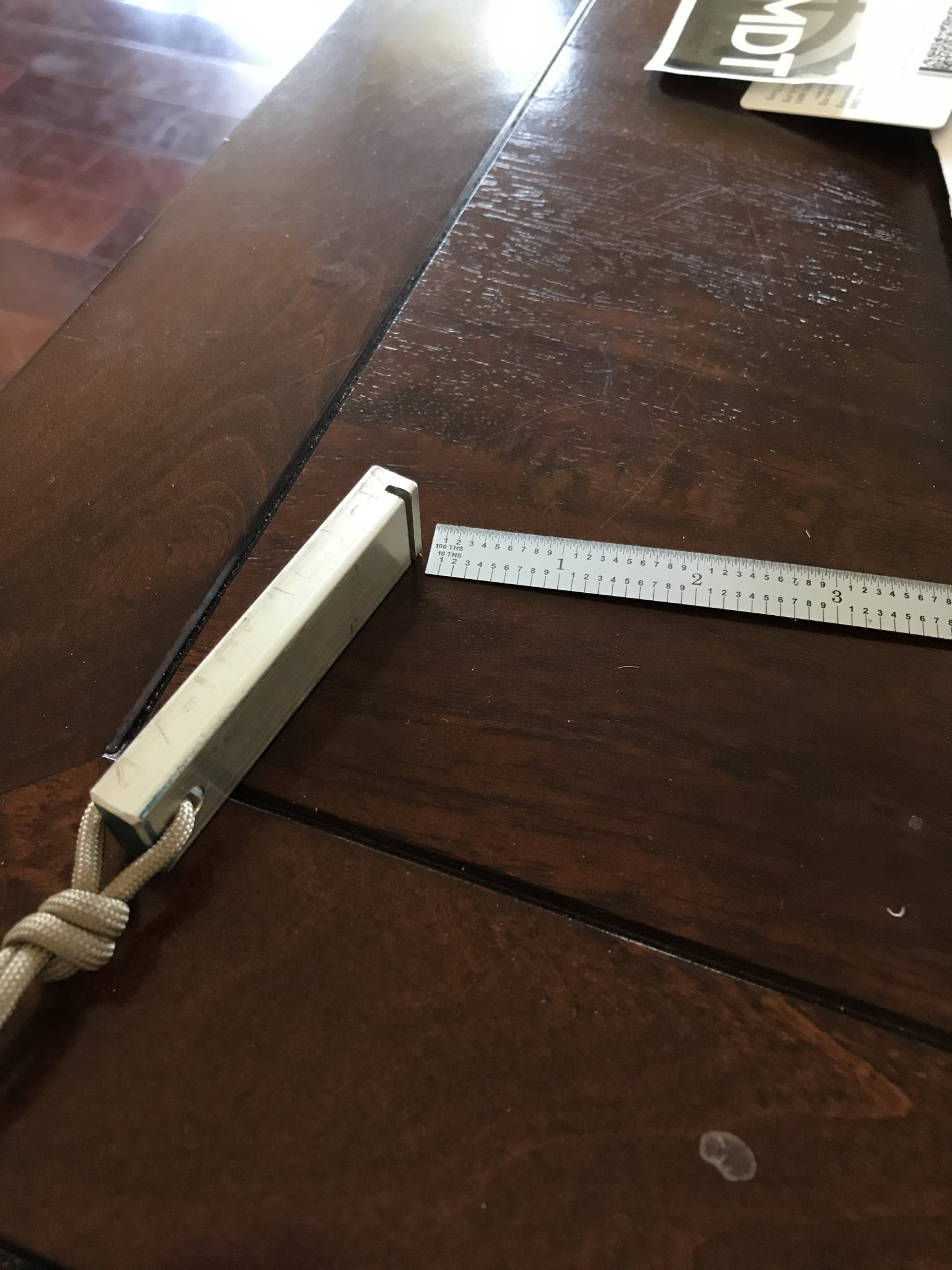

I know it's probably not the OP's fault, but this is where a feed lip tool pays dividends in adjusting them properly, and in the appropriate area. I don't know why more people don't sell the tools, since it is really just a piece of aluminum bar stock, slit with a slitting saw the appropriate thickness and depth. I forget what the dimensions are for the one I made; but you just need something to support the entire lip while bending/adjusting it. @LongRifles Inc. could probably churn out a hundred of these "tools" for a decent profit....somewhere in the archives, Chad had a treatise of sorts, explaining the position a cartridge should be, to feed properly into a chamber. The whole "figure eight" set of annotated pictures and such...

Can you share the dimensions you are using? Same measurements across the front opening versus back? I had mag issues, played with the feed lip tool as a shot in the dark before sending two mags back, and stumbled into getting them to work.
Mine was cut to a depth of roughly 0.175" and the slot was roughly .050" (I say "roughly, because all I had were .035" slitting saw blades, so I had to take a second pass, and there was some tool deflection). It just needs to be wide enough to accept the feed lip and support it, while bending/moving the lip up and out, or down and in). I'll take a picture on my phone and attach it.

Out of curiosity which way did you tweak the problem mag to get it working?
It looks like the feed lips were too wide in the front and let the round go too soon which let the base come up and tip miss the chamber.
