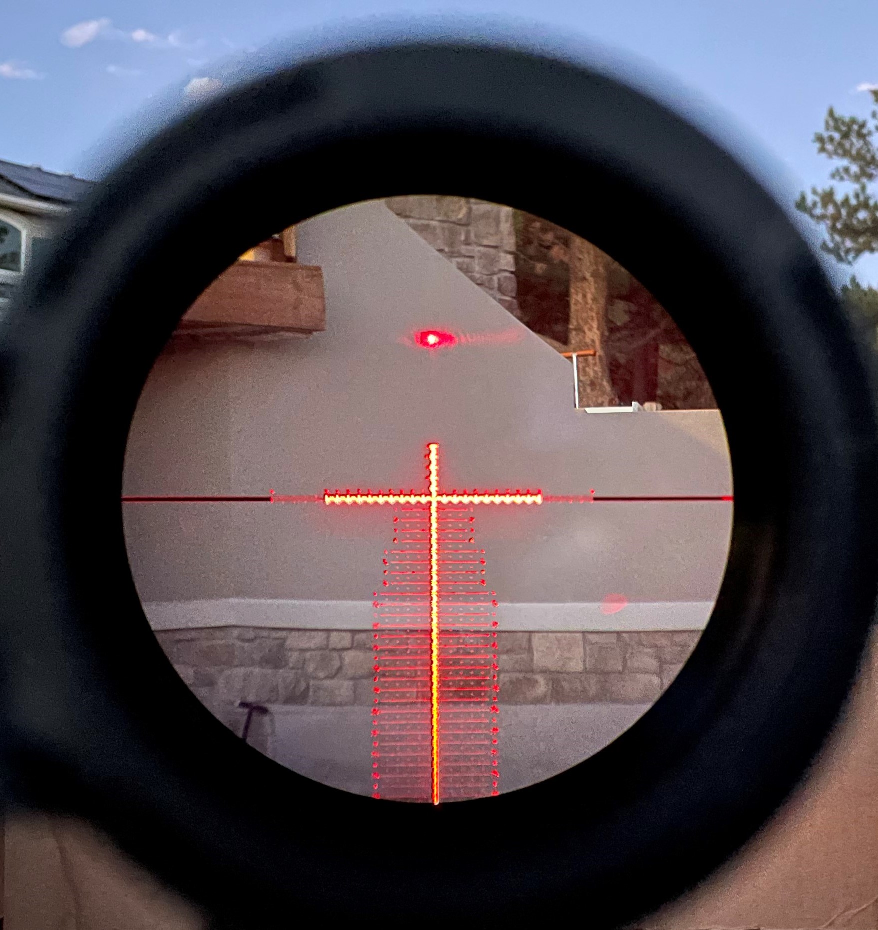

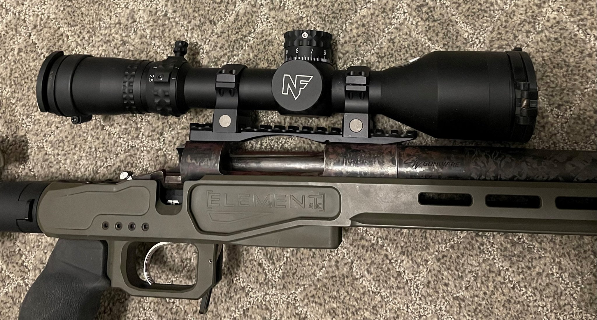

My rifle shoots about 6 feet high at 100M. It can't adjust elevation any lower.
I thought there might be something mis adjusted in the zero stop, so I loosened it up all the way and cranked it as far as I could. I broke the retainer cap.
Night Force repaired it for me and sent it back. They said there is nothing mechanically wrong with the scope and couldn't guess why I can't zero it.
I mounted the scope again, and issue appears to persist.
NX8 2.5-20 x 50 F1
30 MOA mount
The reticle below is shown at 50M, on 8x. The red dot is the bore sight laser.
I had a NF scope do that me once, I took off the top cap and screwed the middle screw down or up, I can't remember but it fixed it...never had a problem with it after that
I don't have any way to verify that it's actually 30 MOA, but it was advertised as such.
Maybe I need to try a flat rail.

He did say it’s shooting 6ft high at 100
Is there any chance you also have cant built into the rings? Are they the same height?

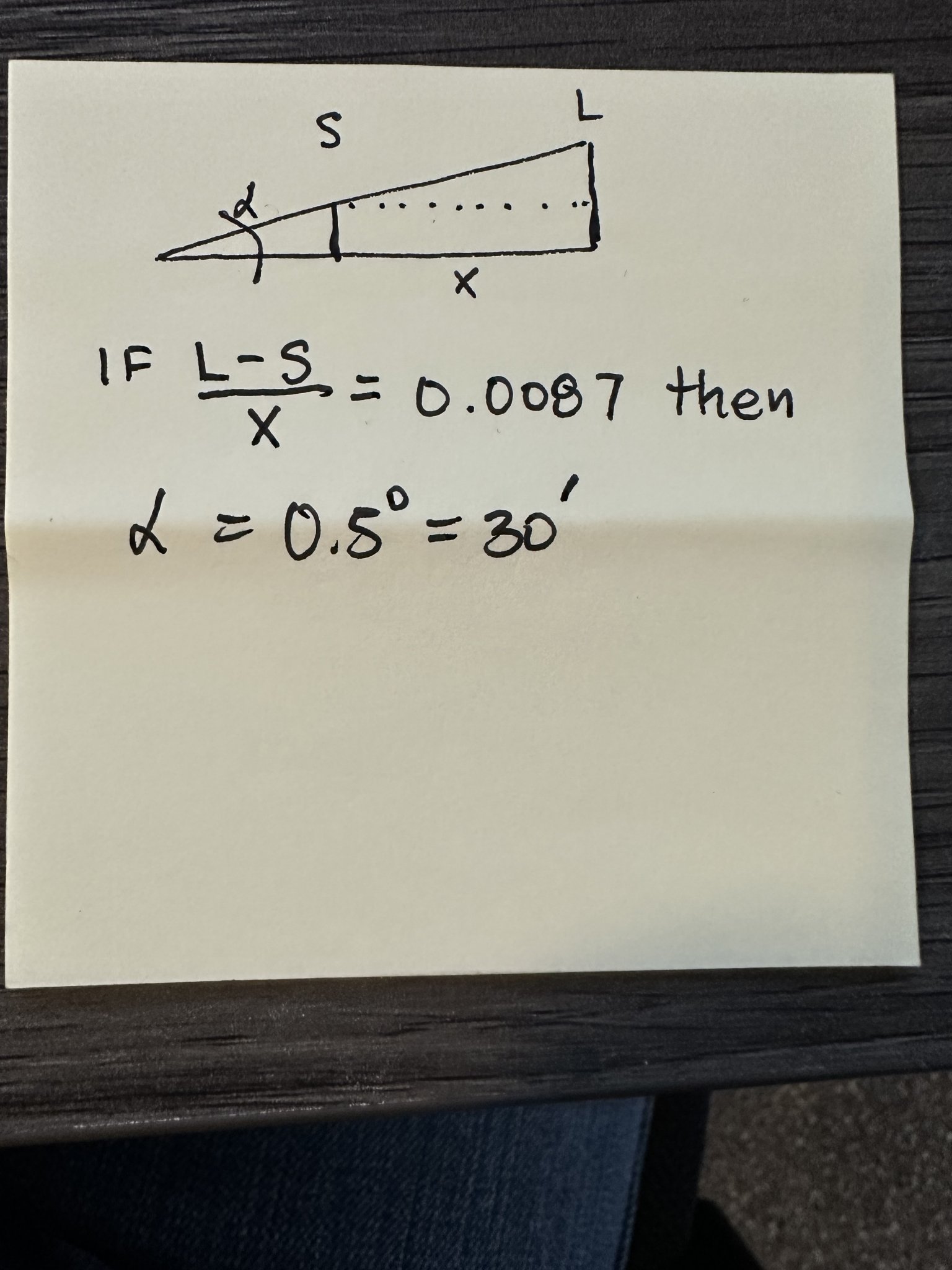

As for determining if that is a 30 MOA rail…measure it’s thickness in 2 places. Subtract the short thickness from the long thickness. Now divide that number by the distance between the 2 places you measured. It that number is 0.0087, then it’s a 30 MOA rail.

Also that rail does look quite different, but 700 clones are that way sometimes.
What is the action make and model?
Model of rail?
Also, the zero stop sometimes is out of adjustment, try loosening the zero stop ring and thread it all the way up, then you should have max travel of the scope to get zeroed.
I just ordered a new rail from optics planet. Leupold 0 MOA.
The rail is Area 419. I can't find my caliper, but as I examined it closer, it says 20 MOA on it (sorry. Its been a long time since I built this thing.)
The receiver is a Defiance Tenacity from Gunware. The rings are Night Force.
@fluwoebers I think I see the problem, that rail is for a 700 style action. The top back of the receiver on a rem 700 is lower than the front by a small amount. That rail looks bent slightly if I pull up the pic on the computer and snap some lines.
If you ordered one from leupold for a rem 700 it will have the same problem.
Defiance tenacity can come with a rail that pins in place I believe.
And the defiance tenacity action is the same exact plane all along the top of the action.
I don’t know what rail you need, but I’m sure someone can recommend the correct one.

You're using a standard Rem700 scope base.
You need a scope base made for Defiance actions. The FOOTprint is a 700 clone, the top is not. I almost went through the same thing until I noticed the rear of the scope base wasn't matching up to the receiver all the way around.
I got one from this guy for my AnTi action.
His shop is less than 5 minutes from my house so I stopped by to pick up a titanium base, because, why not.
Just buy Burris Signature XTR rings and it should correct the problem by putting the 20 moa shim lower saddle up front and the 10 shim upper saddle in the rear opposite of the front to raise it. Burris Signature XTR rings can really fix all kinds of POI issues. Best of all they will never leave a single mark on your scope tube and keeps that scope looking brand new as though it's never been mounted.
I had a similar problem one time. I had a 20 minute mount that I put on a 20 minute rail. Could not get it zeroed until I got rid of the mount and used a set of rings.

Defiance includes a rail with their actions for a reason. Call them and spend the $99 on their pinned rail to make it right.
I’m sure there is some good reason they make their receivers with non-standard heights, but I was not aware of it when I bought it.
I’m trying to keep the weight down as this will be my hunting rifle, and their rails are quite heavy. If nothing else works, I will try their rail.

Lmao it was solved, but you’re ignoring the solution
I don’t know why you would try another 700-specific rail, that Leupold will have the exact same problem.
You could also try and use a thin washer or shim material in between the bottom of the FRONT of the base for a cheap fix.

Defiance makes an aluminum one that is about 1.5oz
Here is an aluminum aftermarket if you can’t find a Defiance in stock

A standard 700 rail WILL NOT WORK.
You need a Defiance compatible rail. If you're worried about weight, get the titanium rail from Murphy's. 🤦‍♂️
Reactions: wade2big and BurtG
So call Talley and get an aluminum one (I'm 99% sure they make them for defiance anyways).
It's like you're ignoring all the correct things in order to chase your dreams of using the wrong parts.
If you really want to save weight just order the rings. Lose the base altogether. (That is, if you're eye relief will allow it to work with the short tubes on the nx8.)

Thanks for the link. I just ordered it. I'm confident that this will solve the problem. I wish I had realized 1 day sooner that defiance actions are not the same as Remington 700; I could have avoided the need to return the Leopold I ordered.
