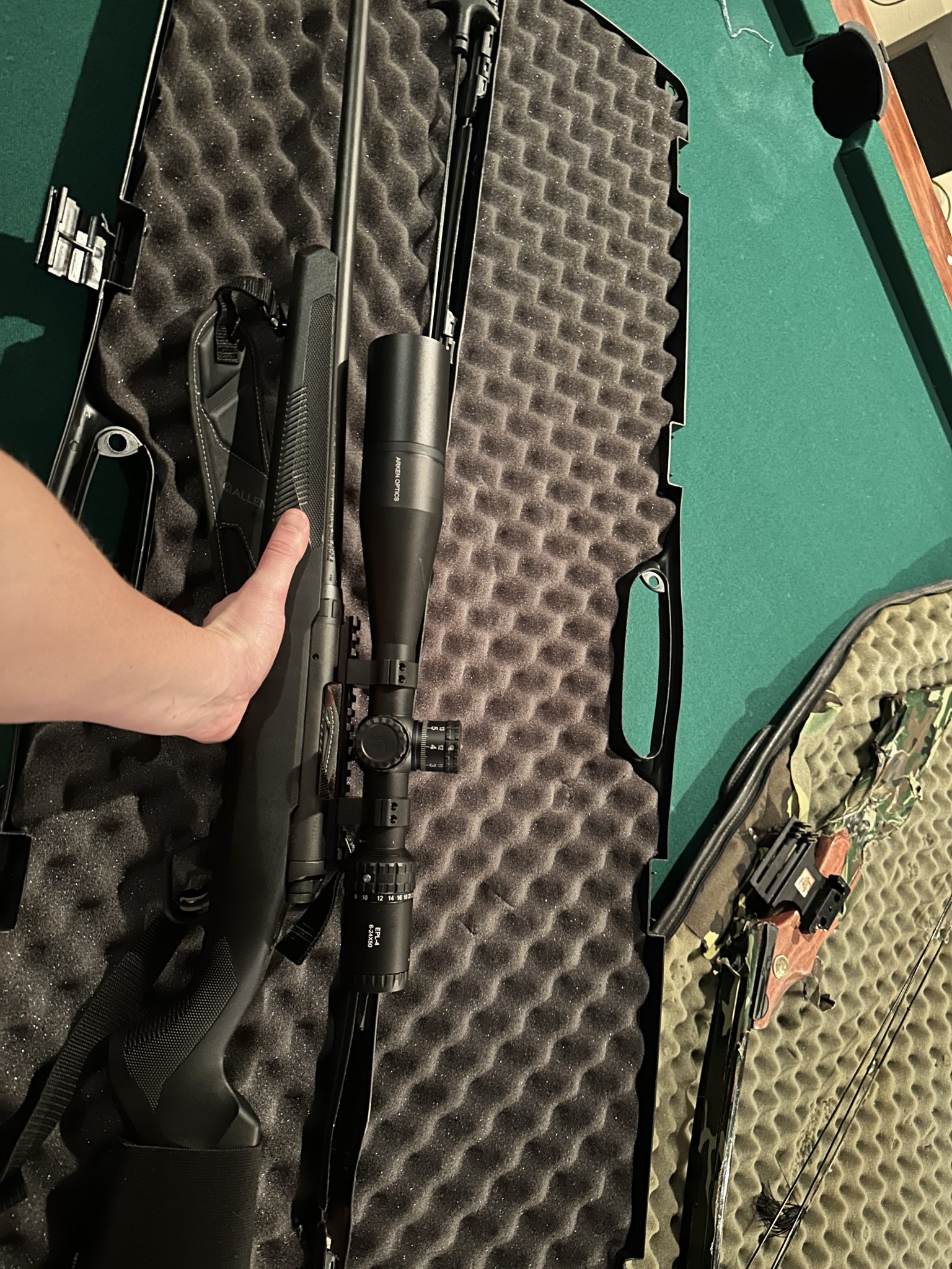

Can’t zero my new scope. Can it be broken or am I missing something ?
Zmu23
Jan 12, 2024
4
0
Pennsylvania
Hey all. I recently swapped my vortex crossfire 3-9 off my savage axis 308 and put on an arken epl4 6-24x50. Prior to this, I had no issue with my 3-9 and could take it out to 500 yards consistently. Since putting the new scope on I cannot get it to zero in any capacity. I have tried two different laser bore sights and ranged it at 25 yards, 50 yards, and 100 yards all while taking shots after each and they weren’t even on paper.
it is shooting about 3 mil’s to the right and I’m out of windage on the turrets. It’s also shooting high and I’m almost out of elevation.
Any idea of what I can do or should I just return the scope? I’ve wasted about 50 rounds so far

Could it be the scope has too much clearance above the barrel? I’m using warne 30mm medium rings
Also it is a 0moa rail
Is the zero stop causing a problem?
If that doesn’t work, try switching the warne rings with each other.
Lastly, remove the bolt,
Set gun on stable position,
Look through the bore,
Without moving the gun, adjust the scope till it roughly align with what you see through the bore.

Also, check to see if the rail is 0 MOA or 20 MOA. A 20 MOA rail should be zeroed at 200 yards. If you try to zero at 100, you run into that problem. If not that and torque is not a problem, then send it in for warranty. I hear their warranty is good. Also, you will need some Vibra Tite for the turrets. Those set screws will back themselves out and you are left with spinning dials.
I have a 100 yard zero on my 243 with a 50moa base
I have a 50 yard zero on my 22 with a 30moa base and 20moa mount =50 moa
Also, is there a windage limiter preventing full usage of the windage?

Yah I’m gonna try it one last time tomorrow before I send it back. I don’t think there’s a windage limiter but to be transparent I’m not sure what that means

For example, some of the NF atacr models will only allow 15 moa of windage left or right before it hits a stop or limiter, but can adjust 60moa/17mrad total windage.
Just a thought.

First obviously check that your scope is mounted properly then make sure your scope is at its mechanical/default zero.
Get a few cheap poster boards usually they are 22" x 28" set it up at 100yds and put one aiming point / dot in the center.
If your scope is mounted properly and nothing is wrong with your rifle you should have no problem hitting somewhere on the poster board even at 100 yds. From there you can see the difference between your point of aim vs your point of impact and adjust according. You can bring it in closer if you need to, but I have never had a problem being on a 22" x 28" poster board at 100yds when scope was mounted correctly. I see people fool around all the time with these gimickly bore sighters and all they really need to do is just start with a target bigger than what most so called "sighting targets" are.
Anyway good luck!
Edit: Wanted to add that if you do happen to not be on a 22" x 28" poster board at 100yds you if you can try to notice the impact you can use the corners as the point of aim and really have a "huge board" Example: You shoot and think/notice the bullet hit maybe a little high and to the right of the board. Then my next shot I would aim at the bottom left corner of the board. If you were to shoot at all four corners of a 22" x 28" poster board that would be like shooting at a 44" x 56" board and if you can't hit that something is terribly wrong.....:) All it should take is 5 rounds max to know where you are using that method.

You are not wrong with going down that fork in the road or at least eliminating it early on.
I think that or something else to do with the base/ring/scope connections would be my first thing to inspect.

First, center your dials. Turn them as far as you can in one direction. Then count rotations and/or clicks as you turn the dial the other direction. Then go back half that rotation.
Then, loosen the ring to rail/mount bolts and push the scope forward on the rail/mount and torque to spec as you continue to push the scope toward the muzzle.
Next, loosen the ring bolts that squeeze it together on the scope and then retorque. I'd do this one ring at a time so I don't have to relevel the scope in the rings.
Turn the zoom to minimum.
Set up a target 25 yards away with a nice big visible dot and view it THROUGH THE BORE OF THE RIFLE. Lock that rifle in place so it doesn't move. Recheck to see if you can still see the dot through the bore. Now, carefully look through the scope. You should see the target and it should be pretty much centered in your view. CAREFULLY operate the turrets so the crosshair is now centered on the target.
Shoot at that target 3 times.
If you are still not on paper, put that other scope back on and see what happens. If all is good, return the shitty scope.
It sounds like you're tuning the turrets backwards.
Turning the elevation CCW makes the point of impact go up. Do that if the point of impact is below the point of aim. Turn it CW if the point of impact is above the point of aim.
Windage is the same. CCW to move the point of impact to the right.

Bore scope the rifle, with your Eyeball, close! Do this on a bench or prone with bipod/bag. The rifle needs to remain relatively still thru this process.
Get turrets back to 0/0. To do this crank elevation and windage in one direction until they stop. If you know how much travel your scope has…..see the box and/or manual. Dial the minutes or mils back to 0. If you don’t know the total travel, Go from one end of the full travel to the other for each turret. Either count the minutes/mils visually to get total travel, or literally count the clicks, then dial halfway back the opposite direction. Knowing your windage/elevation travel is pretty important btw. My recommendation, get those values and validate before you start.
Once you’re centered, pull bolt, line up bore with center of your “close” target.
Raise your head up to the reticle, without moving the rig!
Reticle should be on paper if you’re at 20-30 yards. That’s pretty damn close btw.
From there, dial your reticle to center of target, fire a round.
Then chase your impact with your ret. In other words, reset to the center of target after that initial round, then dial your reticle to the hole you just made.
Make sure this target is easy to see, and is at least 24”x24”.
If your reticle isn’t on paper after using your eyeball to center up bore on target, re-validate your 0/0 on elevation/windage, then try again.
This is a very simple process, don’t overthink it……..

It is until nobody tells the new guy that, when boresighting by lining up the poi with the bore, the turrets work backwards from what the ignorant would think.
If the target is centered in the bore and it is above the reticle center when viewed through the scope, the elevation turret has to be dialed DOWN to bring the reticle UP into the center of the target image.
