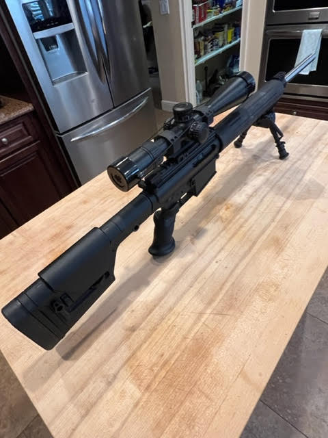

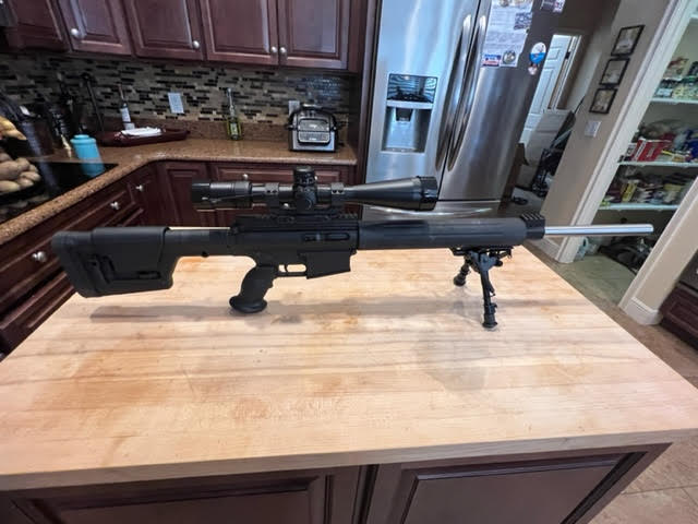

If its a PRS either works, comes with two adapters, i can't imagine needing any more LOP, i maybe used half of it, and simple move of the scope will cure that
