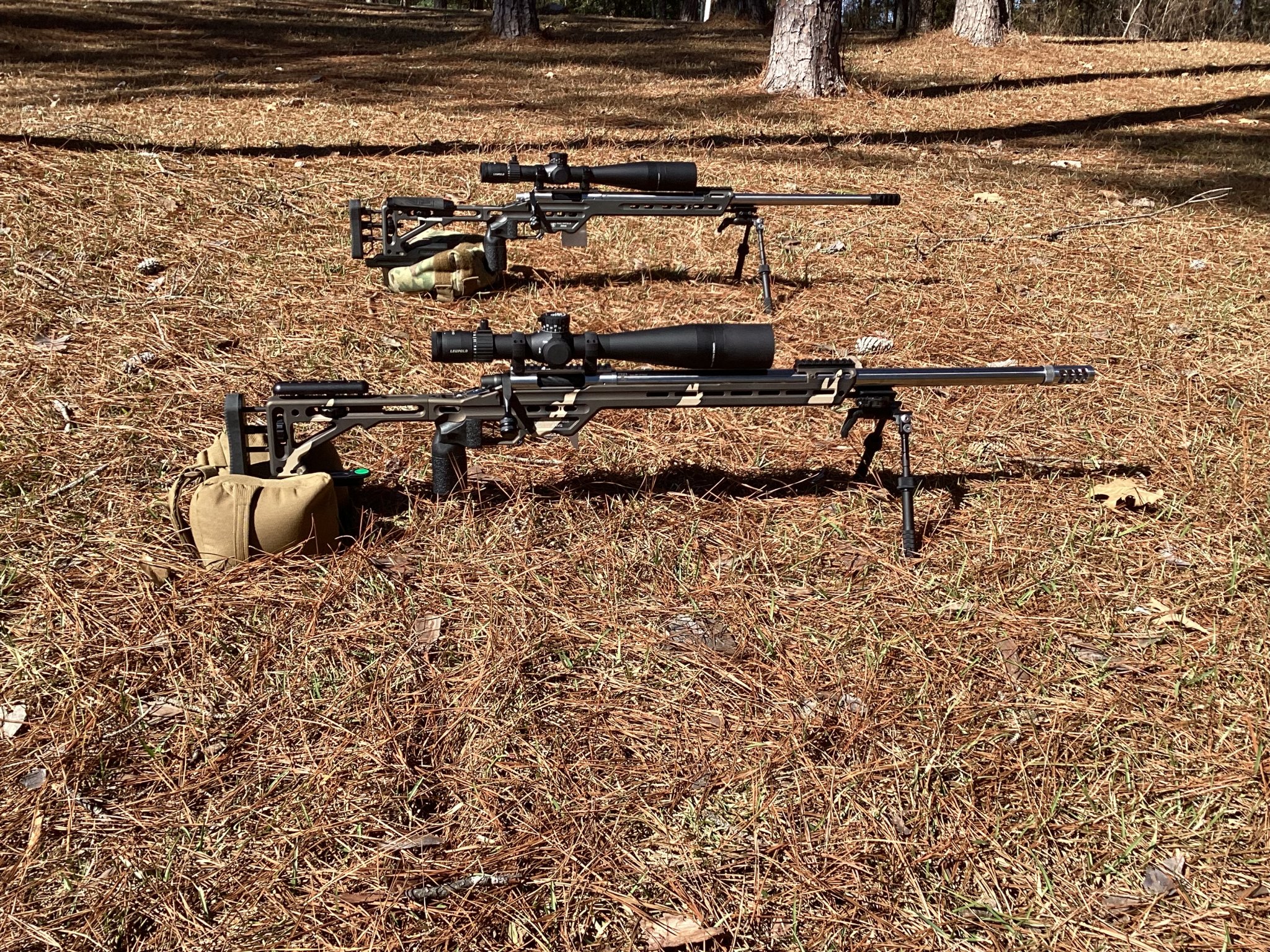

Vudoo as I am shooting it
The two GT’s, the rifle used in the match this past weekend is the Gray rifle in the background
