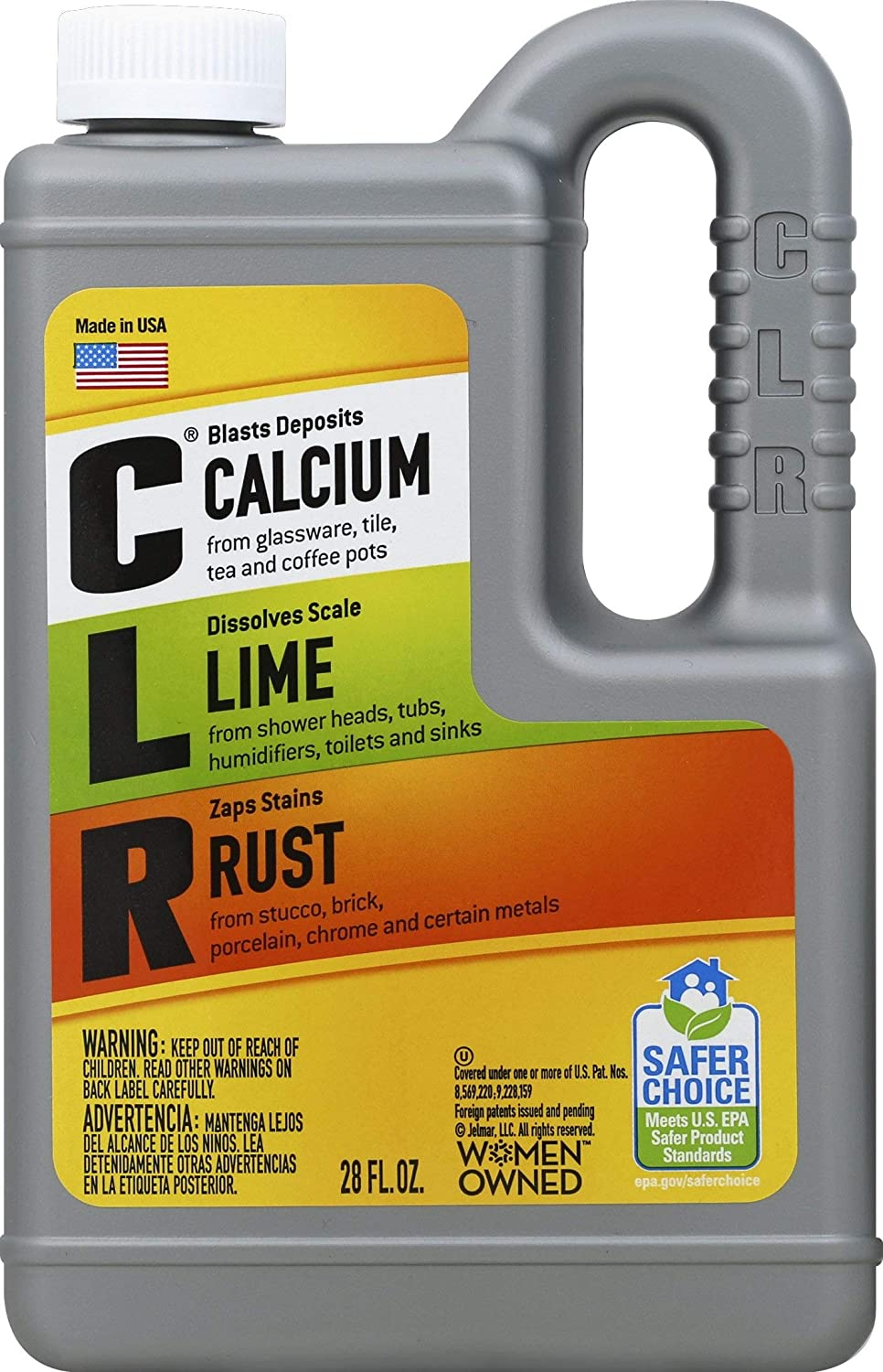

CLR will attack carbon extremely well, but it does mess up nitride finishes if you leave it very long at all.
