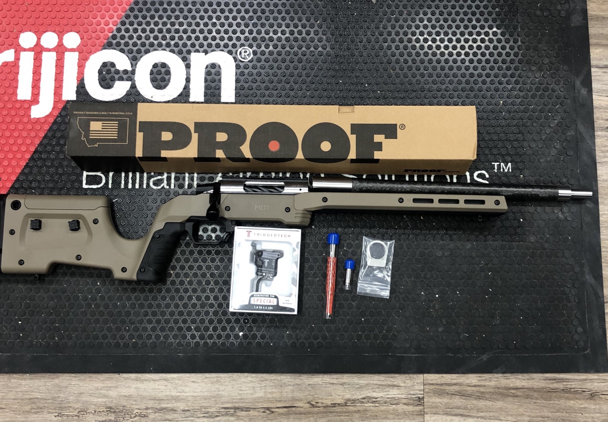

I’m not sure where to put this, but here you go.
Has anyone or does anyone Cerakote the Carbon Fiber part of their barrel? How did it hold up if you did? Some say it won’t stick, but I’ve never heard of someone trying it either to verify that?
