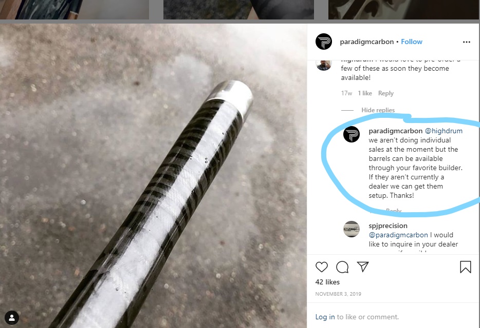

Hi,
So per Paradigm social media....FWIW they are not selling to individual consumers; only to "dealers" which is kind of odd being the industry as a whole is swinging to direct to consumer as possible.
I am interested to talk with Matt at Paradigm though if he is a member here by chance....
Sincerely,
Theis

More profit in the direct to consumer model as well, seems funny to not want to go that route.
Idk if that's true. Their msrp to consumer vs dealer cost is vastly different.
Hi,
I wasn't "guessing" in regards to direct to consumer, lol...I was quoting their social media.
So are you saying they ARE selling direct to consumer?
