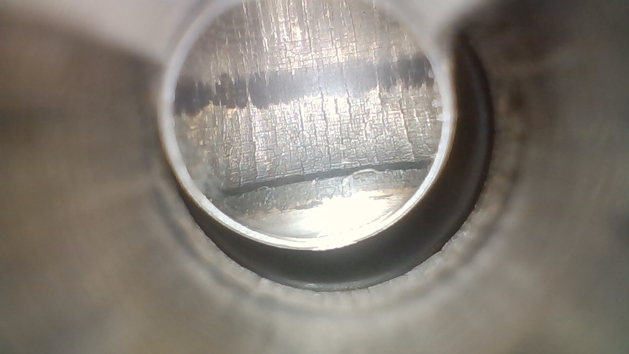

I just found this in my old 22-250:
At the moment, I have an oversized q-tip soaked in BoreTech Eliminator sitting in there. I'll check it when I get home today. If that doesn't do it, I'll switch to CLR, which has worked great on carbon in the past. I think with most steels, there's no problem letting it sit in there for a few minutes. However, once I get the ring out, I'm going to do some passes with acetone, and then follow with some kind of gun oil.

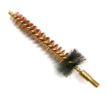

Copper/bronze brush and battery drill.
You’ll probably need a copper remover after, as there will be pieces of the brush you’ll need to remove.
The drill makes quick work. Faster that running the brush 100x with your hand.
