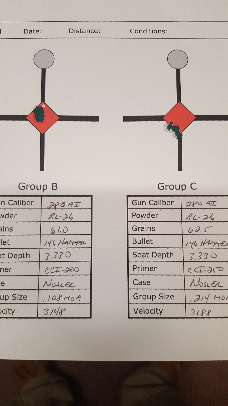

I also got one recently for my Tikka. It looked good, and it screwed on and headspaced right, but like others here - it will be a few weeks before I get to shoot it.
I did the 280 Ackley Tikka pre-fit. 24" Magnum contour, 1:9 twist. Headspace was perfect. Chamber machining was excellent and the barrel lands and grooves were very smooth. Only thing out of tolerance was the barrel end was supposed to be .900 and came in at .860. Not a big deal, but had to turn the brake down as I had ordered it at .900. Working up loads with a new bullet (Hammer Hunter) and found the two loads below to be the most consistent. Overall pleased with the barrel.
