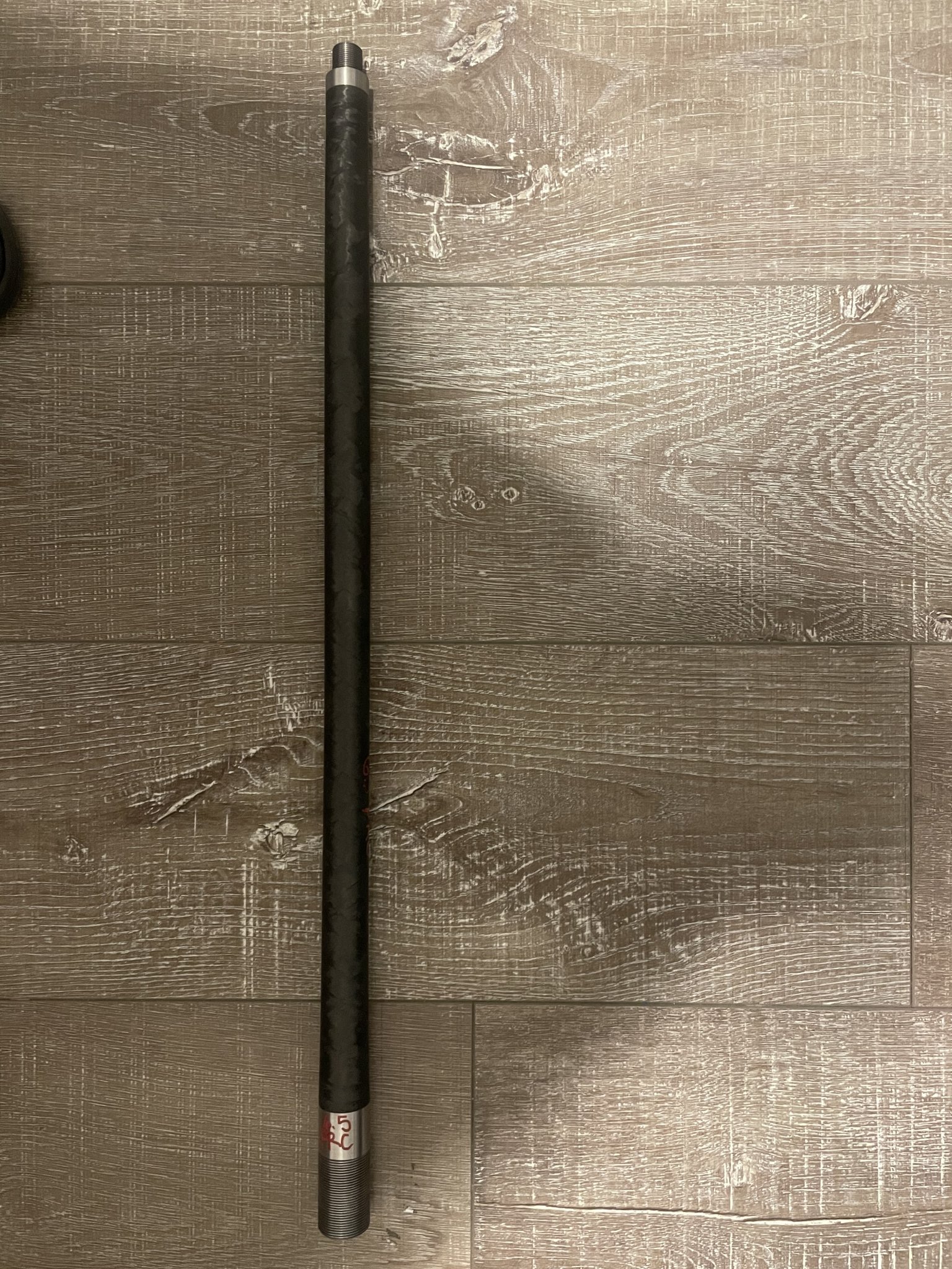

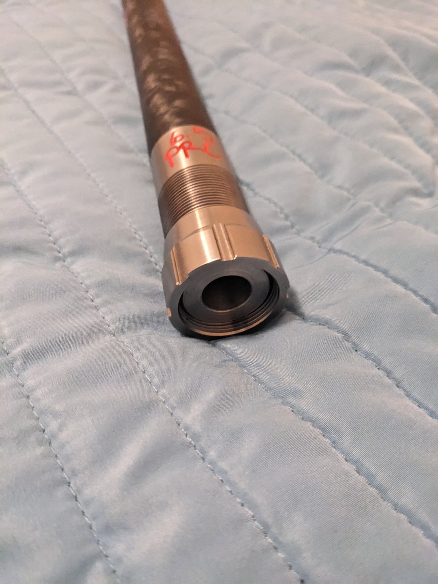

NEW. Never used or mounted. 0 rounds.
CarbonSix barrel:
Savage small shank
6.5PRC
24”
7 twist
5/8-24” muzzle thread
Magnum carbon contour
Helical pattern
Asking $600.00 shipped.

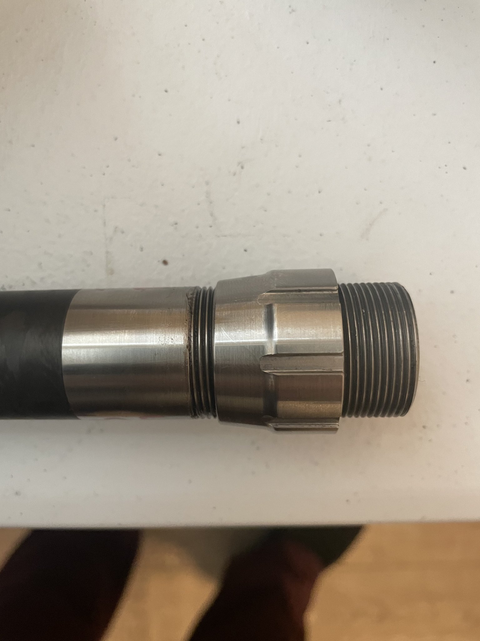

Got a question. got the barrel and nut. The nut does not fit this barrel.. Too small to go all the way down the barrel shaft and only screws on about 1/2" from the threaded end. Does it go to another barrel? First time dealing with savages so not sure what is wrong. My action came with a slightly larger nut but it does same thing only little better.
Can you post a picture because that does not make sense. I have the same exact barrel and nut below.
This makes zero sense. That barrel has been installed on a TL3 action. Did you inspect the threads before screwing the nut on the barrel?
I guess send the barrel back and I’ll refund you. I have no clue why that is happening to you but not for me. My address is on the box.

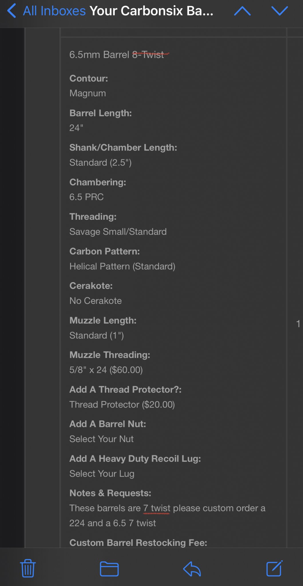

I emailed carbon six. Lets see what they say. I see no nicks or damaged threads and it screws into the action
Did you use the same barrel nut? it goes easily to that point and then just locks tight and cannot be moved forward.
The second nut just barely engages and locks tight
I am not sure about that exact barrel nut. I have four different barrel nuts. The one I sent you might have been a new/unused barrel nut. I really didn’t think to check when I was putting the barrel nut in the box.
Let me know what they say in case I need to call them up.
