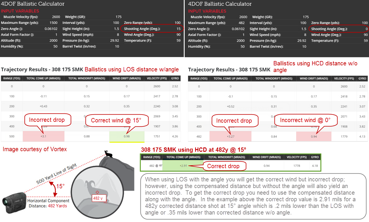

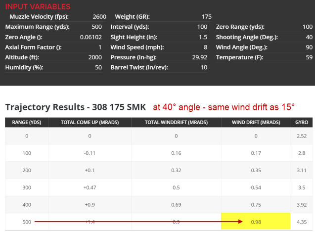

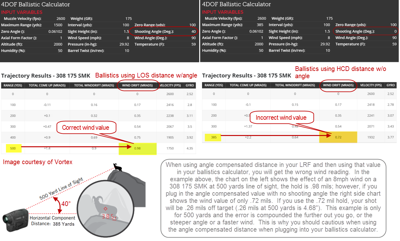

    I posted this in another thread on rangefinders, but thought I should post this as it's own thread. While most manufacturers offer some kind of angle compensated distance mode for their rangefinder, you should use that mode with caution because the one thing the rangefinder cannot compensate for is wind and if you use the compensated value which will be shorter than the line of sight (LOS) value and you punch that into your ballistics calculator you could end up with an incorrect wind hold value. I put this below chart together because I am a visual learner and thought this might help better explain why the wind value is different between the two measurements.
    EDIT: @TacticalDillhole has pointed out this is NOT an issue if you have an LRF with Bluetooth that is connecting to the Kestrel and providing the solution for both drop AND wind, which is something to keep in mind. This is ONLY for LRF units that are stand alone, or LRF units that have built in ballistics (for drop) but no connectivity to identify wind holds.
    It has also been pointed out that rarely will we shoot at such extreme angles, even when hunting in the mountains, so if we reduce the angle in the above example from 40° to 15° then the variance for the wind is even less, and one could argue whether the ability to guesstimate wind at distance (especially in mountain terrain with hills, valleys, cliff faces, etc.) is of greater concern than the error introduced by the angle adjusted distance. The below chart maps out what this difference could mean:

    So..... Is the wind shift in your proposed shot .72? No, it is some value greater than that. The example you gave above may factor these items in where the .98 value is correct but I do not know without know what formulas they are using and I dont want to do the calls at the moment.
    The metric that matters for wind drift is time of flight, not really velocity of the projective or distance it travels (But you can compute time of flight using distance and velocity).

    That is correct, but you are correct in that the longer distance and wind deflection is based on time of flight, ballistic coefficient, etc. and how much all that is affected by wind over a given distance and period of time. My example uses a 308 with 175 grain projectile, but plug in numbers for the same 175 grain projectile but from a 300 Win Mag moving say 300fps faster and you'll notice the difference between the 500 yards LOS and 385 yards angle adjusted is less; however, there will still be a difference because the wind still has the opportunity to affect the flight of the bullet for 115 yards further even though time of flight may be shorter. Ultimately, the value that needs to be plugged into the ballistic calculator is the LOS distance with the angle inputted as well and not the angle adjusted distance that is provided by many LRF's.
    Why can’t you use the angle compensated distance? All it takes is a simple understanding of trig and a simple mathematical calculation to get the horizontal distance to the target. Most LRF’s tell you the angle as well.

    Read my first post, I explain why you should not use the angle compensated distance for inputting into your ballistics calculator, I then provide a graph that also explains this???

    But the reason the BC asks for the angle is it assumes you are inputting the distance read from the LRF which is line of sight. That’s how it gives you your elevation number. Then it does the trig and gives you the wind number.
    The key is you have to input the angle as well, if you don’t then the original post is accurate. You will mis.

    That is correct sean, that is what I'm saying, if you are using HCD or AMR or whatever your manufacturer is calling their angle adjusted/corrected distance, and you use that distance to plug into your ballistics calculator, your wind is going to be wrong. Instead, you should be using the LOS distance and ALSO inputting the angle in order to get correct drop AND wind values from your ballistics calculator.

    Although what you've put forward here (use LOS distance+angle instead of AMR distance) is correct, it isn't as much of a difference as your example illustrates. A 15 degree angle doesn't turn 500 yards into 385, it turns it into 482 and I'd posit that for the vast majority of calibers, that difference wouldn't change the wind call. It'd have to be a 40 degree angle to turn 500 into 385. It's pretty simple trig, you multiply the cosine of the angle by the distance. The cosine of 15 is roughly 0.96. The difference is important for the elevation component but not really for the wind call until you get higher than 20-25 degrees. I don't know where Hornady (or whoever) got the numbers in that chart but that isn't right.
    The chart was an "example" and the picture used was from Vortex, they didn't list the angle so I just plugged in an angle at random to "provide an example"; however, I'm glad you brought this up because the angle does not change the wind value, if I plug in the same information into the ballistics calculator but use a 40° angle instead of 15° the wind value is still the same which means the "hold" value is still going to be wrong when using angle adjusted distances from your LRF:
    If you don't feel the difference is going to matter that's fine, but the fact still remains that if you use an angle adjusted value from an LRF that is not already connected to a Kestrel or the like that is providing wind feedback, then your wind hold is going to be incorrect. Now, if you feel other wind conditions are going to impact your bullet more than the incorrect ballistics hold that's okay, but I'd rather rule out all possible errors so that my estimate of the wind in those conditions is reduced as much as possible.

    The kind of angle where you would see the AMR wind issue become a real problem is STEEP, like no joke standing at the top of a black diamond ski run kind of steep. And when you deal with wind interacting with big terrain like that, it's no longer a simple left to right do the angle math problem, it's more wholistic where you look at where is the wind coming from and what is it going to do when it runs over that cliff face or up this valley. And the degree of uncertainty for a first round hit is much, much higher than on flat ground.

    I have added another chart to the original post which I think helps clarify the drop error. In the end having technology that can account for both drop, angle and wind (among other atmospherics) can really help to eliminate errors; however, if you are using something like a Kestrel to measure wind you must keep in mind this is wind "at the shooter" which does not always represent the wind that will impact the flight of the bullet as it travels above various terrain and conditions on its way to the target.
