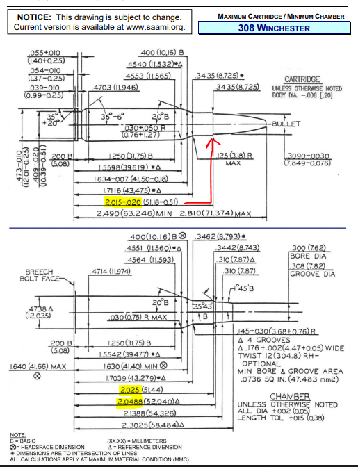

Here is where your speer manual got their numbers
The case max length per saami is 2.015-.020 meaning anywhere from 1.995-2.015 are within the min-max spec.
But also notice that the chamber neck ends and begins its sloped transition to the bore at 2.025-2.0488 and thats where it pinches. So you can go a bit longer.
But I dont and dont suggest you do. Its so easy to trim to spec and never have to worry about any danger resulting from the practice. After you size them I would trim them all uniform to middle of the spec at 2.005 +/- .002 or so depending on how accurate and repeatable your trimming and case prep is. Then chamfer and deburr the mouths.
