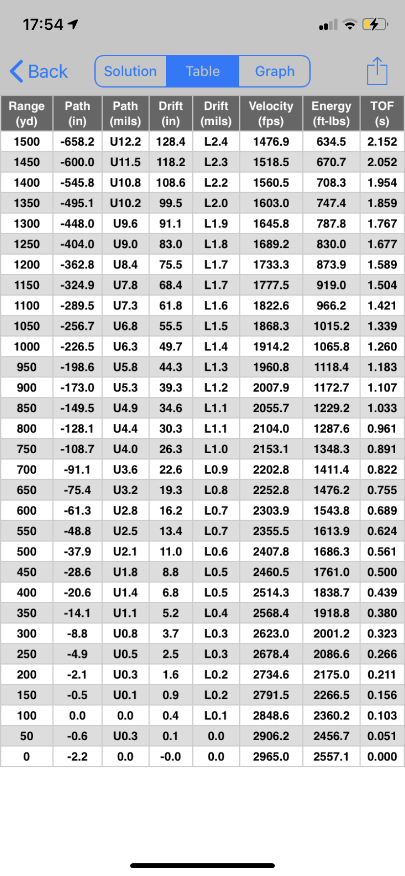

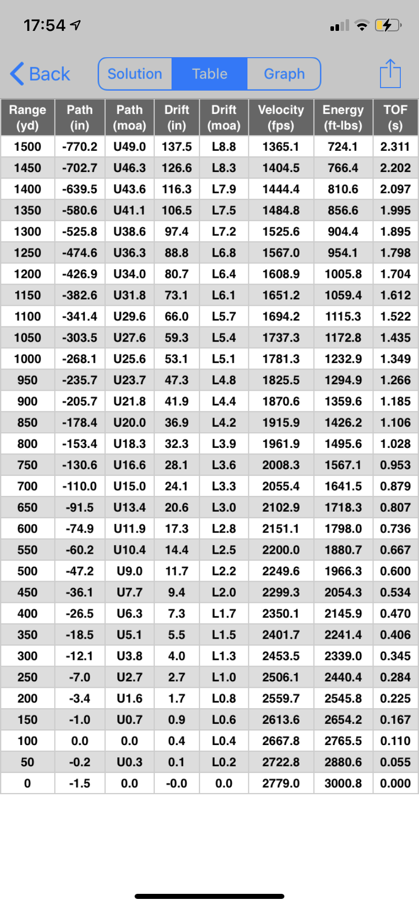

For the sake of conversation why would you choose the 25 over say a 180ish 7mm?
Nothing wrong with the 7’s. My son runs a 280 REM and his dope is almost as good as mine (drift) but he is pushing it hard and out of a long action. To match his velocity and stay on your short action you’d have to open up the bolt face for a magnum. If your mostly gonna bang steel long range the 131 grain blackjack is magic. Especially past 1000. The BC is .335 G7 in my guns. You were also looking for good brass plenty for the Creedmoor (I used necked down lapua 6.5 CM)
If your more hunting oriented the 7-08 might be good too. But I have no experience with it maybe someone else can chime in.
I attached my sons 280 drop chart and my 25CM so you can compare them. Keep in mind his drop and drift is MOA and mine is mils. Look for inches to compare. These are at our home range DA 7500
280 Remington
25 CM
We may have led you down a rabbit hole suggesting the 25 but the 131 Ace is too good not to mention it. But since you did say you were looking for something bigger than 6.5 for hunting I think a 7SAW or 7-08(if you don’t reload) may be more what you are looking for. Both still have low recoil with a good brake which makes it pleasant for banging steel and trying to spot impacts.

If I do go .25 I would definitely pick up your solids. I do like the fact 6.5 can be bought if need be, the only thing Iam concerned about with .25 is the lack of bullets available. What is the barrel life of a .25? And how does your solids compare in BC to something like the 143-147 ELDX? The more I think about it I may just build this rifle as a 90 percent target and 10 percent hunting and build another hunting based rifle. Thanks again bud for your help.
Reactions: bohem
Go with the one you can get a barrels worth of ammo or dies and components for, in hand, first. No sense building up something that you cant feed.
Reactions: bohem and Steve_O
I have to agree. IMO, the advantage of a .284 180 vld for hunting long range is significant.
You can do it with less, but I like a 180 vld out of a short mag, especially at distances over 500. If you are getting a gun to do more than a 6.5 cm, then make the next step up. Sure, you can go to a faster 6.5, but it still won't hit as hard as a .284 at the same velocity.
I agree the 7mm will hit harder. But if we go down that road why not a 338 Lapua. I was just giving my opinion that the 6.5 Creed would work quite well for what he is trying to accomplish. If he wants something different and wants to try some solid type bullets that’s great.
Reactions: hereinaz
Bc is only half the equation
Read the paper i published about Trajectory Normalizing Factor, it is on my website.
BC*MV is a simple way of comparing
I am shooting a 122 hunting bullet at 3,050fps with a well validated .283g7 and there have been a few elk clobbered with it. Every week we get more pictures from guys who shot some kind if big game with them and they hit like lightning.
Reactions: 260284
What many of the folks tend to dismiss is sectional density as well.
Nothing wrong with a heavy for caliber .25, though it is a bit of a boutique bullet, with limited availability ( I have many times wondered why there isn't a SAAMI .25 on a .308 case).
A 140 class 6.5 bullet has a very high sectional density, they will penetrate.
berger is releasing their fast twist .257 bullet sometime or another. my guess it will be around shot show time frame. Word on the street is there are at least 2 other manufacturers with plans on releasing a fast twist .257 in the future too. Blackjack were the trail blazers in the .257 game. PVA was the first to enter the solid game with one, and all the rest will be following suit in the near future.
Very true, he can do it with the 6.5 creed, especially inside 500. Bullet placement is everything and the heavier 6mm and .25 will also easily handle deer at that distance.
I was just adding that the 7mm has something a little more but not too much, if he wanted to consider it. My reason is that the 7mm 180 gr bullet has sufficient oomph, which is not inconsequential, and the recoil is still manageable. A bump to a 300 magnum delivers more, and a 338 as well. But, it comes at a cost of recoil and management of the same.
If the Berger is close, it may push me over the edge and I would pick up a .25. I hear the same thing, but my Berger insider is tight lipped...
