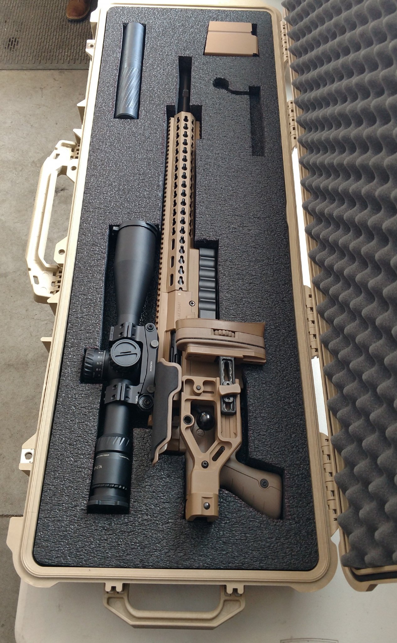

Get a sheet of closed cell foam from amazon for $40 or grab the entire insert kit (2x large pieces and 2x thin liners) from Patriot Cases for $85 and cut it yourself. If you use a silver marker, you can wipe it off with an alcohol wipe so you don’t have to flip the foam or worry about the offset (too much) as you go. I used a long blade utility knife and a straight edge but I have used the electric knife method in the past with great results.
Best method I found was to do a rough trace with a black marker and then get a straight edge and clean it up with a silver or white marker. You don’t have to go crazy on the small angle details and by being less form fitting angles, it ends up looking a lot cleaner.
When it comes to foam, the dense closed cell foam is the only way to go and you won’t be disappointed.

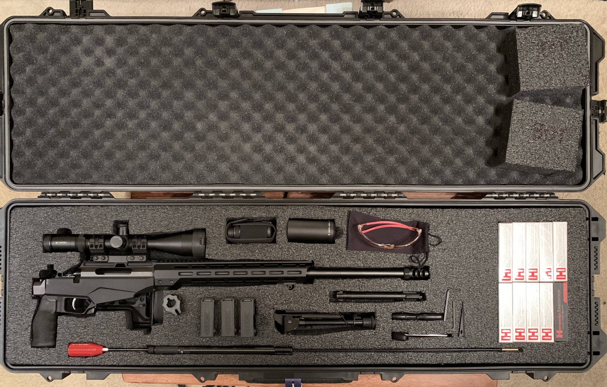

Yes. Like this. Just finished mine tonite. Left space for a can and a Kestrel. Cut the top layer with a sharp filet knife.

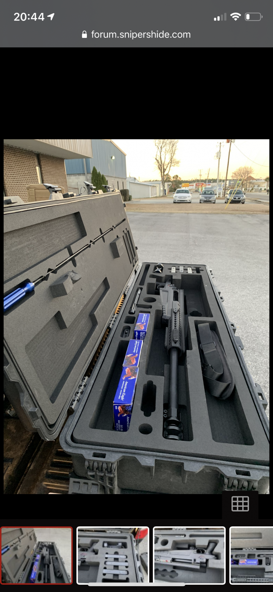

Dont forget the quarter sized or so half rounds on each side of items so your fingers can easily grab items.
lol that was a learning moment after I cut the closed cell foam for the bolt. Having only worked with the soft standard case for, I was like “shit, I can’t actually grab my bolt out of the foam now” lol.
