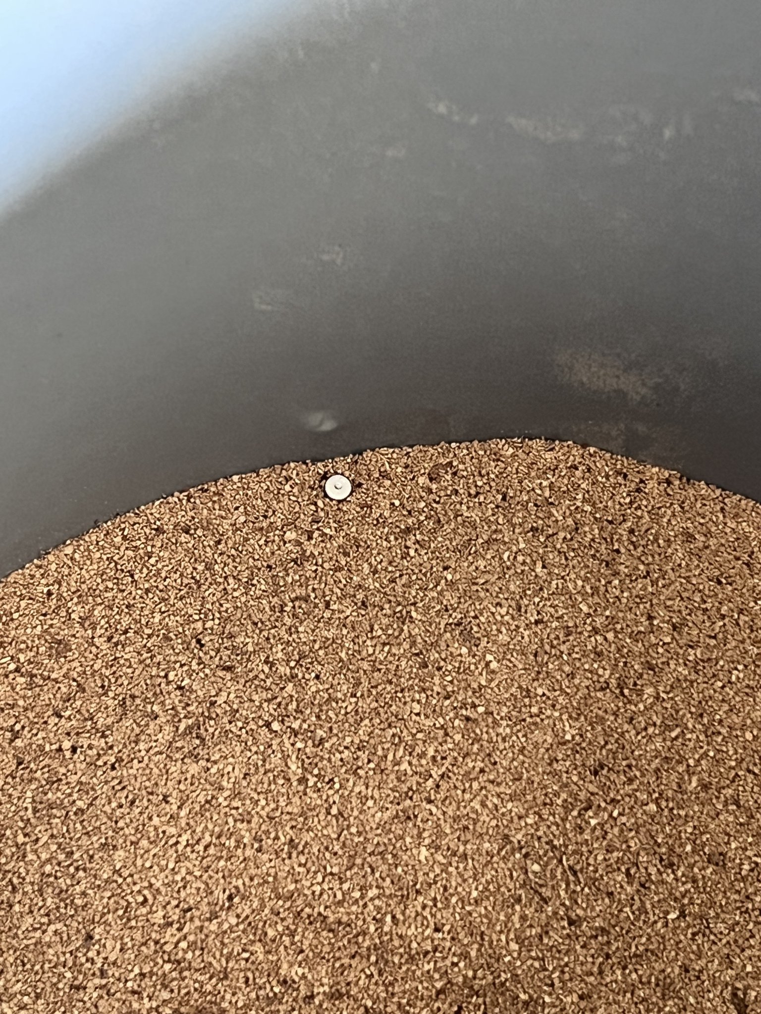

Just had a LRP fall out of annealed Norma during media tumbling after the 3rd firing 😆
