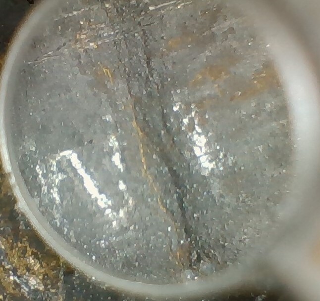

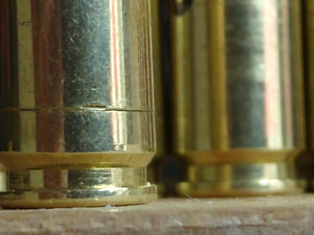

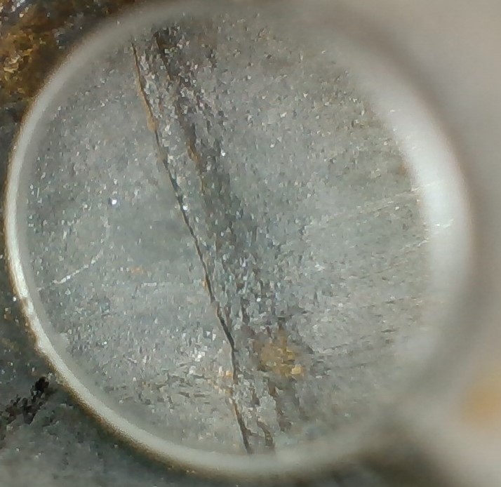

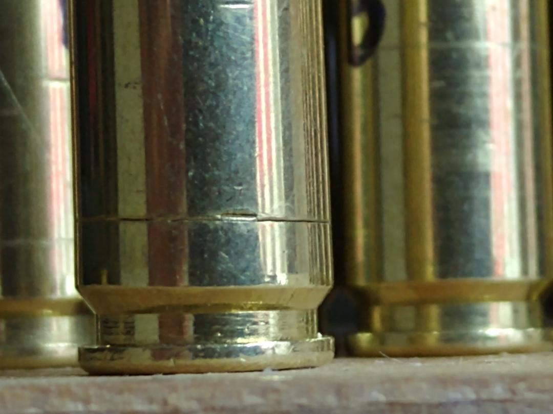

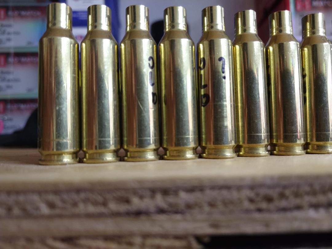

I noticed that out of 250 pieces of 6.5x47 brass about 10 look like the pic below, which look to be case head separation issue. Only time I've ever had case head separation was with a 1xLC brass shot out of an AR-14 where the case actually separated. Primer pockets have always went out 1st before there was a case head issue I guess for 308/260.6.5CM and 223. With the 6.5x47 the primer pockets just do not get loose. I've stop counting how many firings I had on these cases but it has to be over 25 so I'm not complaining and i will be retiring all 250. Shoulders have been bumped 0.002 every other firing and the cases have been SB annealed few times. On 9 of the cases you can barely feel anything with fingernail but one almost feels like it has been cut with a saw from the outside lol. I shined some light in the case and filled it with water and it does not look like case head has been actually separated. Just looks weird form the outside. This is probably a dumb question but doesn't the case head separate from the inside? How can the outside of the case look like pic 2 and 3 but not be separated?
I had something similar on a set of brass. The only way to truly tell is cut one, cross section. See how much of the web is left. Mine actually turned out to be fine and the line was from some other repetitive force on the case.
25 firings, you've got your money's worth
No, not exactly.
Think of it as a piece of clay being held by your two hands and being slowly pulled apart. The middle get thinner and thinner until it so thin it breaks apart. This is kinda what's happening to the brass, however, the pressure from firing pushes material to the outside surface against the chamber. So as the brass case is being pulled apart, where the thin part is observable in on the inside. rather than the outside.
This is why it's a good idea to inspect the inside of brass with some kind of feeler tool. I use a large paperclip that I've straightened out and put a little 90° bend on the tip and run in over the inside to feel for any depression forming in that area above the case head. This way I can detect a problem before any visible cracks or that telltale separation line you see on the outside of your cases.
As the brass is pulling apart, it's not pulling apart uniformly. So, around the diameter where it's coming apart there are places where is completely separated (and often will allow gases to come through), but stays together in sections of that diameter to keep in from being a complete separation. Take one of those and fire it again and it WILL totally separate.

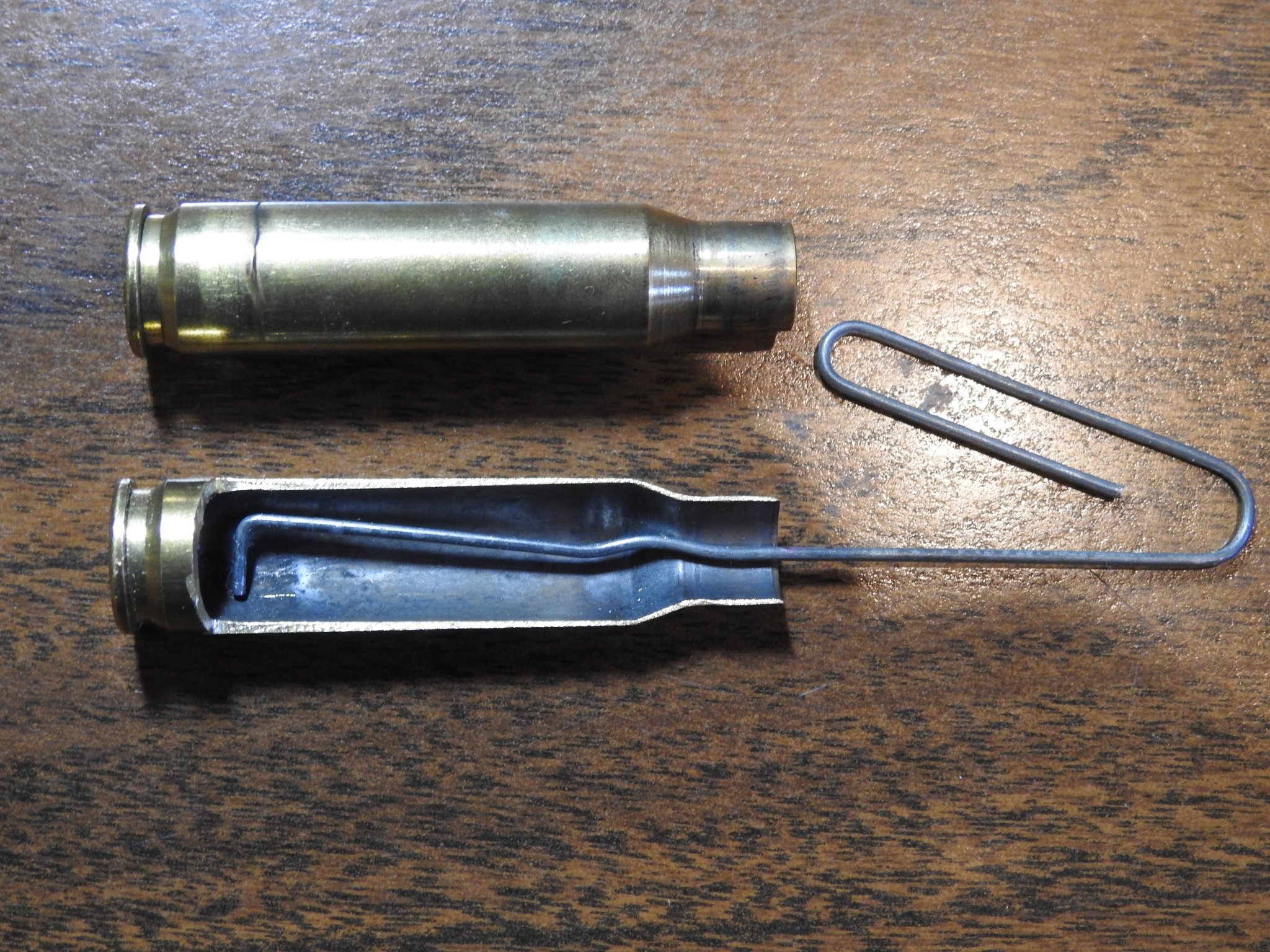

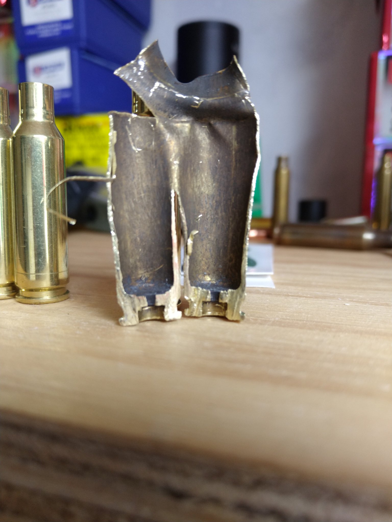

Here's some pics you might find of interest:
This first one is a case I found laying around for a long time where it's separating and you can see where some gasses have leaked (I guess just kept this as a reminder) and the one I cut out doesn't have any separration, but is just to show my little paperclip tool and how it relates.
The next two pics are the inside of that same case as the one at the top of the previous picture.
Reactions: LA260

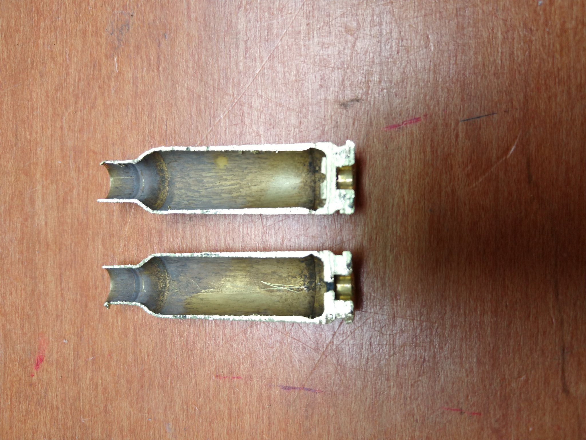

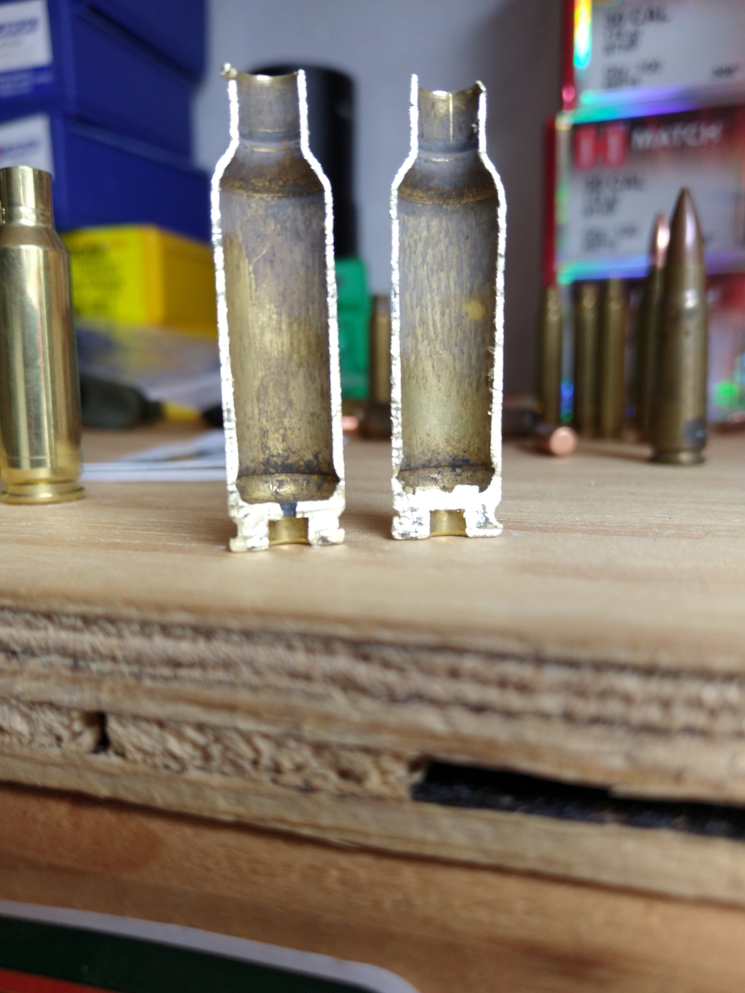

Thanks everyone for your thoughts. I went ahead and cut the worst baffected brass see what the inside looks like and it's not pretty. On a positive note there is no donut that I can't see so at least I don't have to worry about that.
