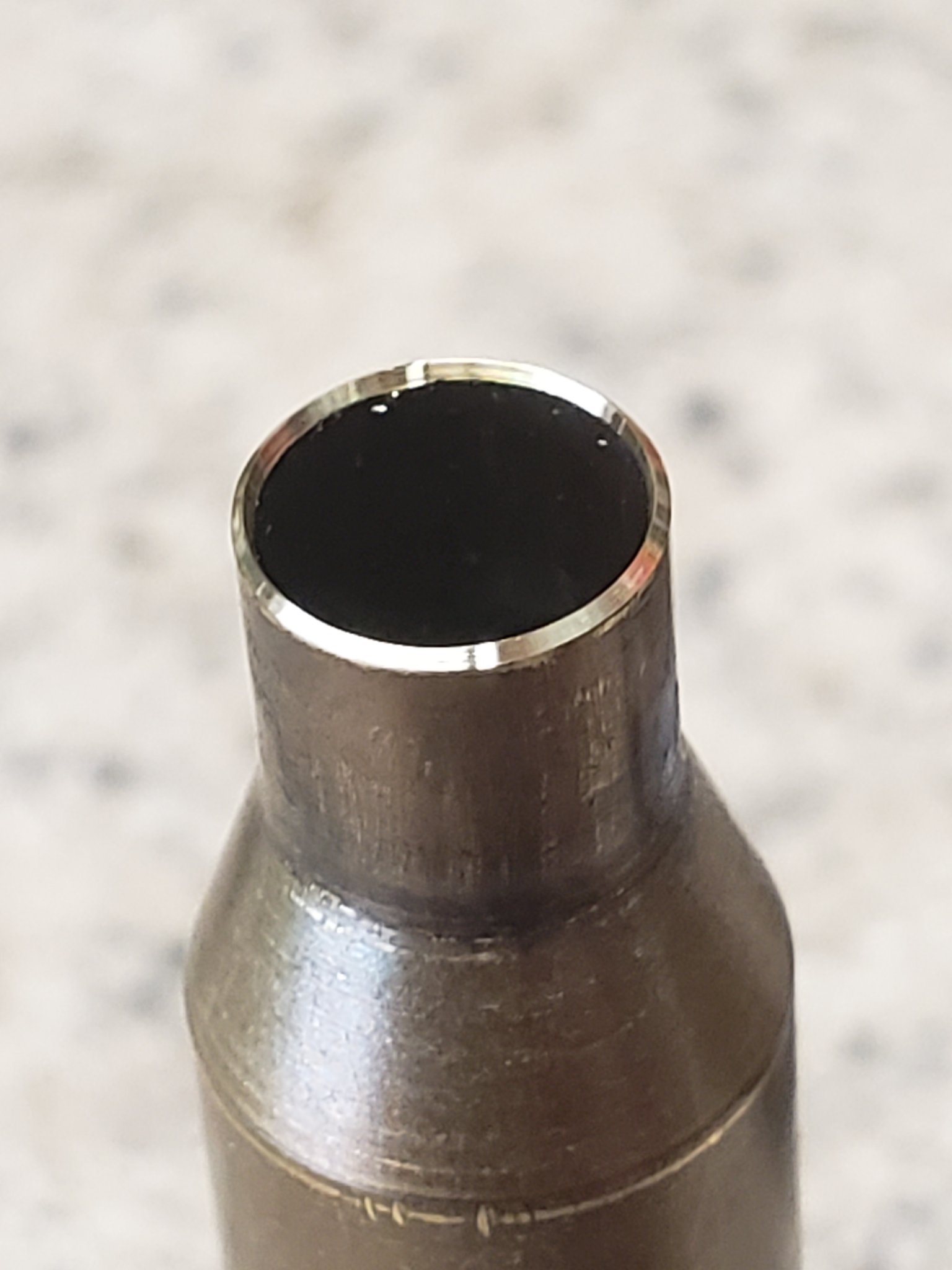

Make sure your seating die isn’t screwed down too far. You’ll get something like this happening:

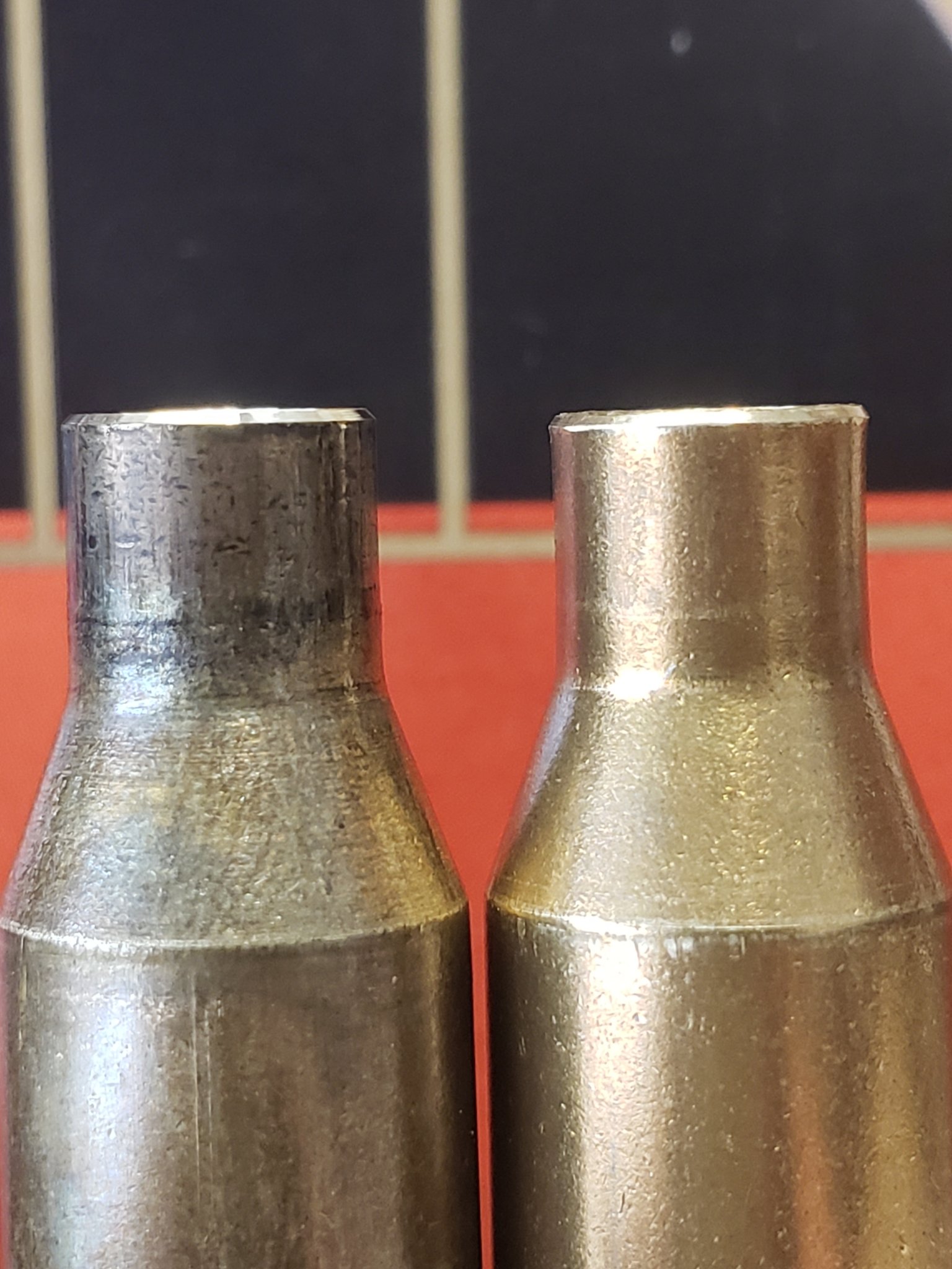

Old sized brass on left, newer recently size brass on right (6 firings) with flared mouth.

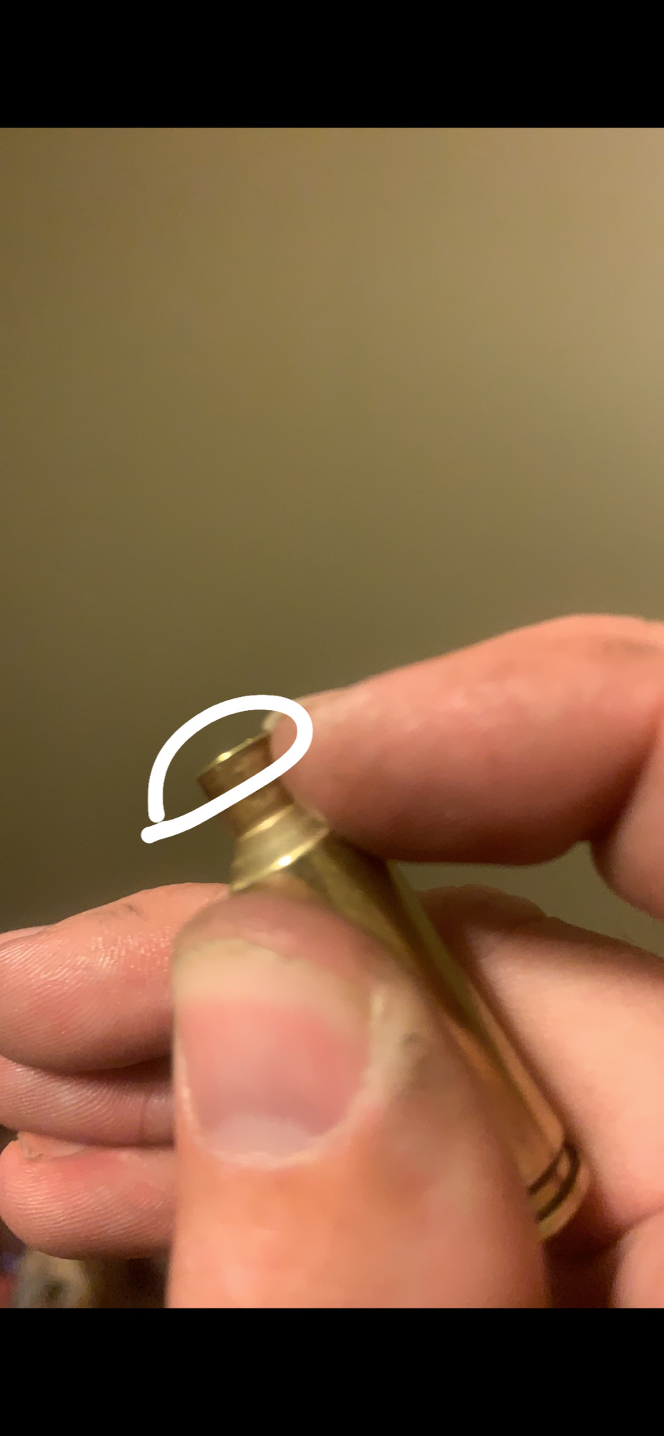

I know this is an older thread but I dealt with this issue before. I full length size without the expander & then use mandrel. It seems to be worse when I used vld chamfers like my giraud or Wilson that had a deeper chamfer. It still did it with the rcbs trim mate but not quite as bad. On the 308 it only did it when I used Redding die & lapua brass or thick neck brass. Winchester 308 brass had no flare with any die. My 308 Forster die did not flare any brass. Then using alpha ocd dasher brass & Forster full length die it happened. I thought maybe it was initially pushing the necks in too far. I checked & it was pushing in too far. I got my dasher die honed & no more flare. Also honed my Redding die & problem solved. It has to be something to do with spring back tension from overworking & deep vld chamfer combo
