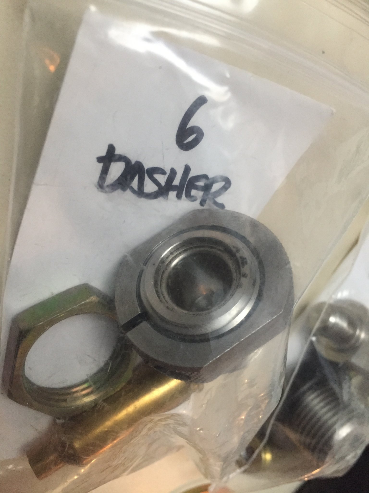

I chose the giraud benchtop myself but I have 6 different case holders of which several you can use for multiple chamberings (such as using my 3006 holder to fit dads necked down 270), and 5 cutters for different calibers so there is less of a delta between all of that and individual triways/trimit2s.
I mainly went with the benchtop though because they make a dasher and 6xc case holder which you would have to have custom reamed by someone else using a blank case holder for the trimit2. It was the easy button in my situation.

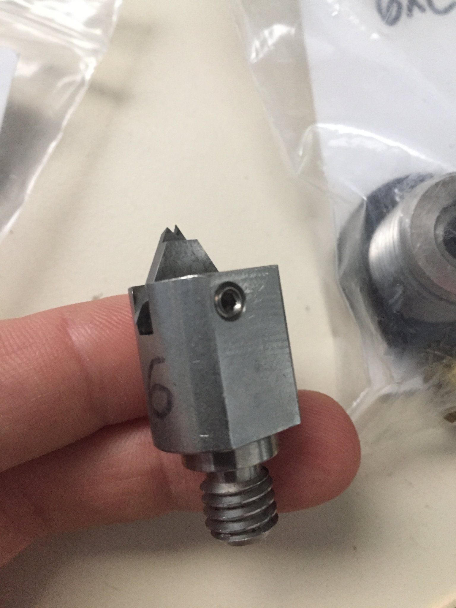

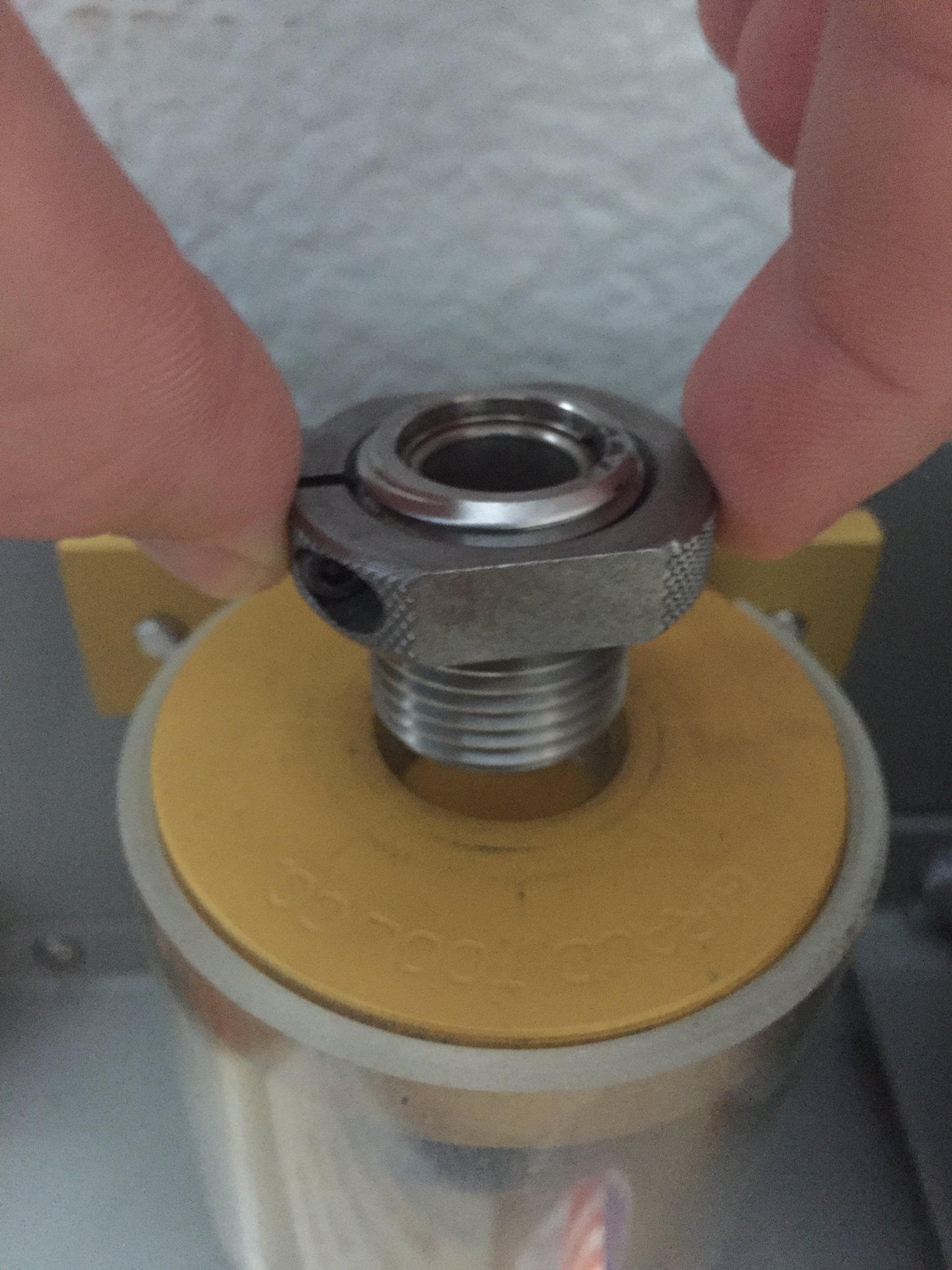

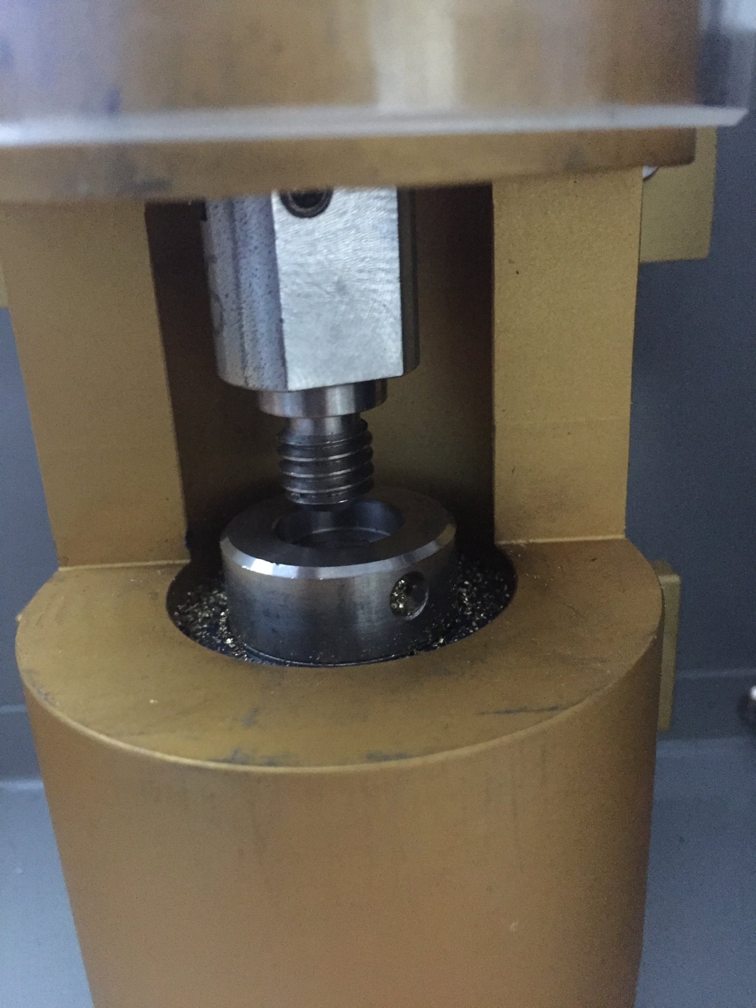

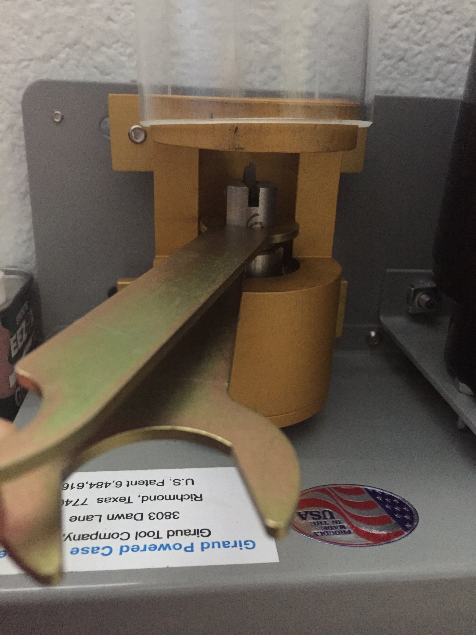

The cutter is adjustable for diameter but it’s a pain so I set once and forget it. That’s ideally how you would do all three way cutters though.
Threads down into the drive shaft.
Tighten
Then the case holder threads down on in until it bottoms out on the lock ring.
And that’s essentially how the triway and trimit work as well, just different ways to skin the cat. All have a semi die cut into the case holder end to hold and index the case properly along the shoulder to the cutter blade.
