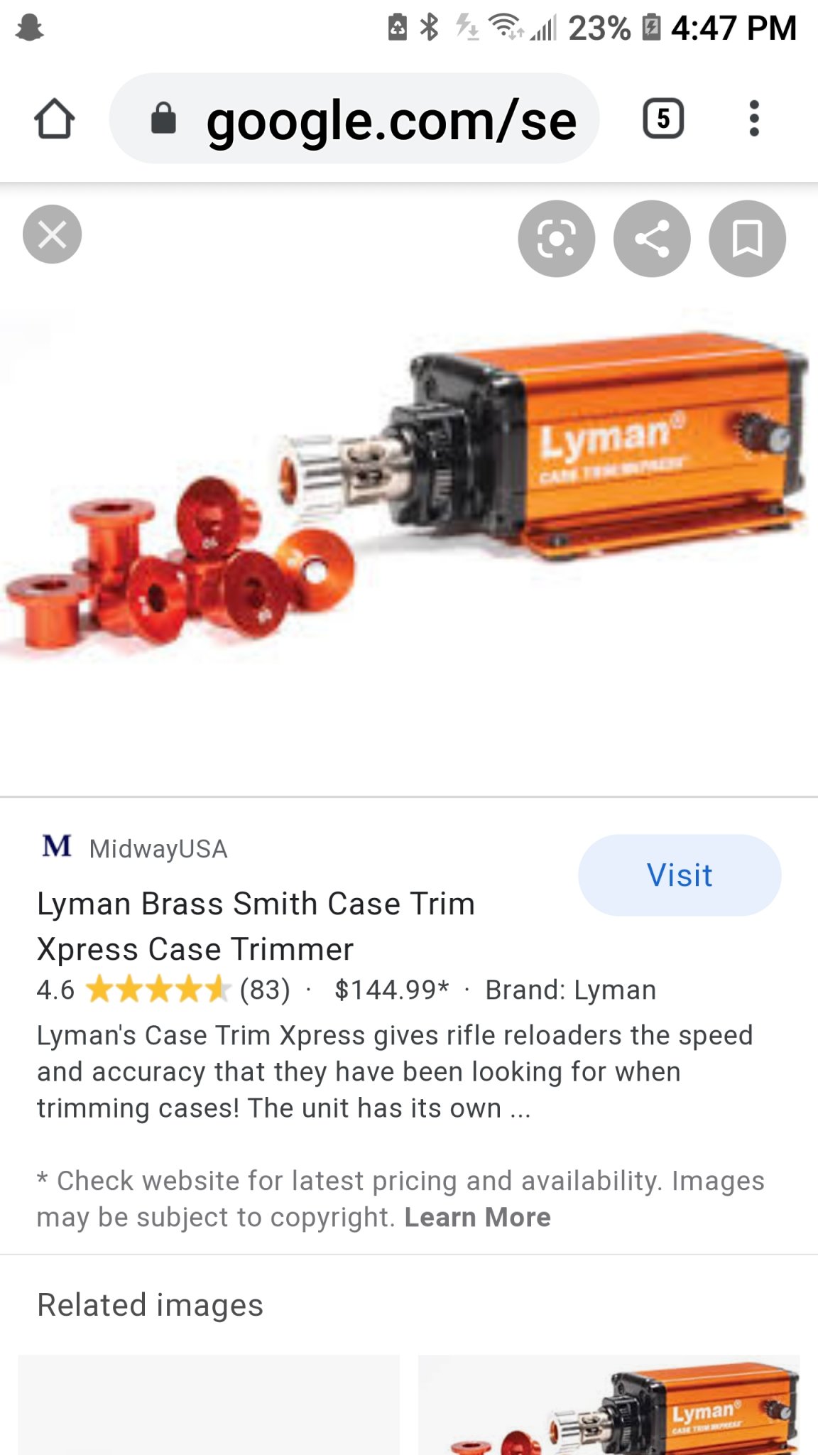

Nice thing about the lyman is it comes with a set of the shoulder bushings that accomodates a pretty large swath of cartridges on the market. You don’t have to buy individual collets or mandrels. I broke down the cost difference between the forster classic, 4 mandrels, and 3 collets, and the lyman unit can trim more different cartridges for half the price.

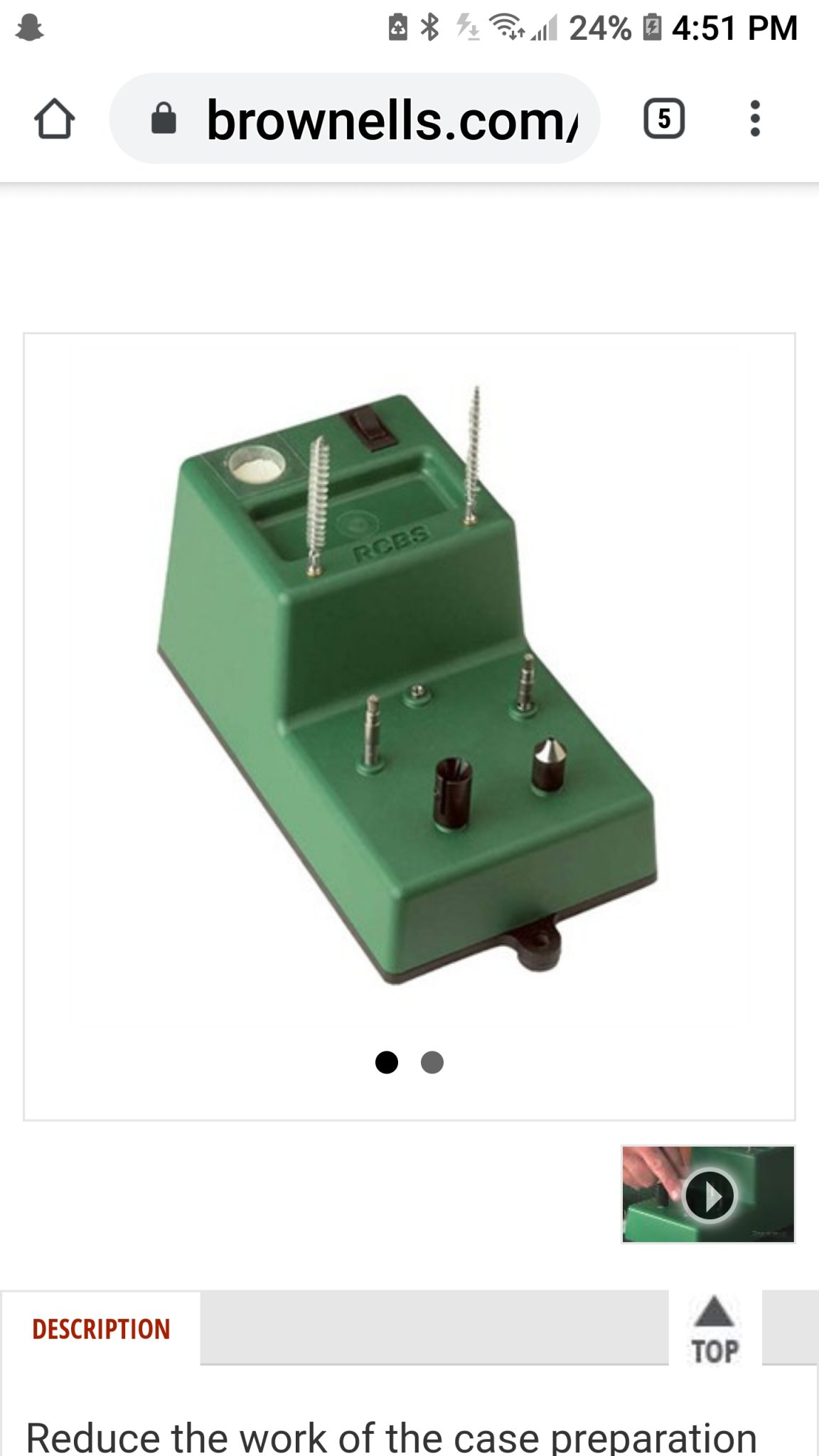

The new rcbs brass boss has 6 stations versus the 4 on the case prep center. 2 of the stations run at higher rpm’s and you can adjust the speed of the motor on the rcbs brass boss and the lyman case trim express.
Just trimmed and chamfer/deburred 200 pieces of .308 in less than 45 minutes with those two units.
