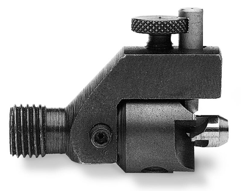

Is this what your referring too?
That’s just part of it, that’s the pilot only for the 3 way cutter. You need either the normal pilot for the normal cutter like you’ve got now, or you need the full 3 way cutter with that linked pilot.
You can swap pilots in the 3way but I would by one 3 way per caliber so that you don’t have to adjust em each time you swap to a different cal.
