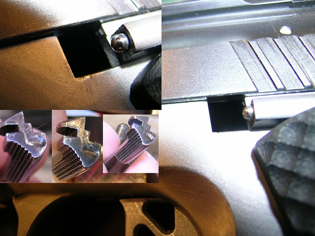

I just built up this dedicated frame for my 2211 .22lr conversion kit. It was an interesting experience. First 1911 I've built. (Well lower end at least.) Everything needed to be fit. Even the magwell was too tight for the mags to fit. (Not mainspring guide, but the actual frame's magwell.) Did a lot of contouring that most people might not notice.

Everything was new parts except the hammer, sear and disconnect. I had those laying around from my MC operator. Put them on the side with the pins and the sear engagement looked good. They gave me consistent ignition so I decided what the heck. I was thinking of getting a Blue force Gear Vickers FCG at some point. Of course that might be a bummer since it took so much to get the thumb safety to fit and contoured. At least I have a buddy with Tig so I could fix it if I don't have enough material.
Oh yeah and I bought an old slide stop at the gunshow for like umm. 5 or 3 bucks. It was beat to hell, but I revived it. Mainly I wanted to use it to test a method of making the slide stop not have a huge amount of tension on it from the plunger. This was to make it function better with the weak magazine spring and the hold open feature of the magazine.
Here's a link to a pic of my slide stop mod.
http://img.photobucket.com/albums/v328/salmonaxe/2211_Slidestop.jpg
