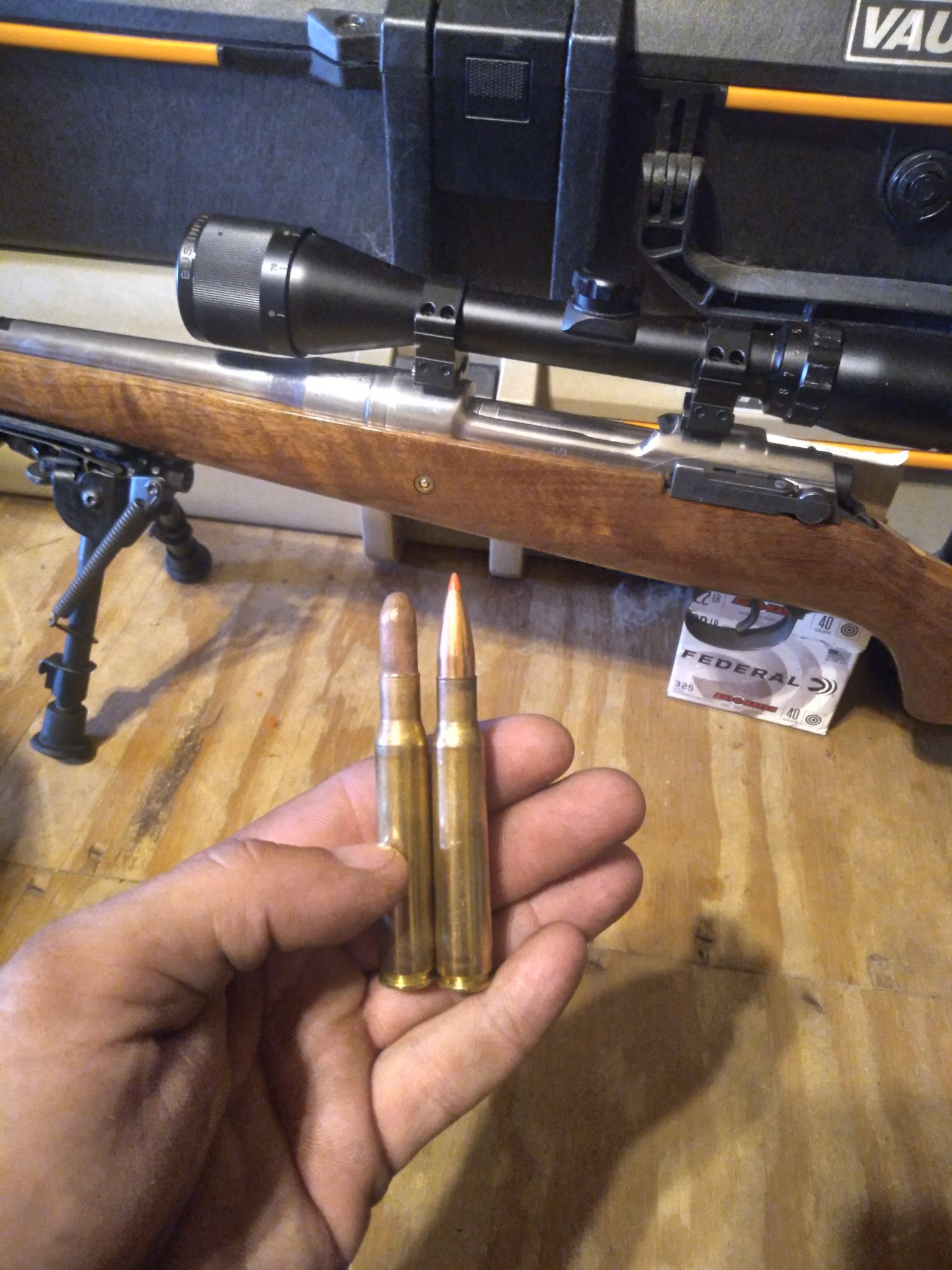

    Doing some testing on some 200 grain lead cast round nose bullets. I made my own copper plater and copper plated them im also running a gas check but eventually may not depending on how testing goes. Shooting in 30-06, i should have some data in the next few days if anyone is interested.

    I just dont like the thought of paint in my barrel... i get it, it works or whatever. I watched alot on it. But the bullets i buy are copper coated, why not cast myself and coat if i get it down. It was more tinkering and wanting to do it, not really looking for the easy way lol, i allready have gas checks if i wanna go the easy quick route.
