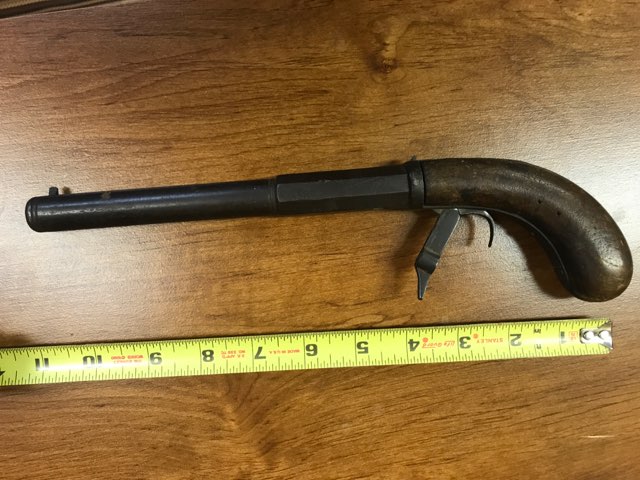

So last night I'm having my beer at social hour and a guy I talk to there, asks me about a pistol some friends of his found in a house they had purchased and were cleaning out to renovate.
Id10t me looked it over and even ran out to the car to get my magnifying glass, but FORGOT to take a picture of it. D'oh! Anyhow, here's what I looked at last night:

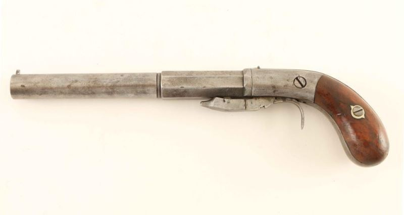

This pic came from an online site that called it an Allen & Thuber, .36 cal.
The thing that really interested me was it had a hexagonal bore like a Whitworth rifle. Which makes me wonder how common it was in the day, and what was the possible reason it went extinct?
Again, being at least half retarded, I didn't take pics. I hope to have those soon as he will look me up this week and we can take more of a peek at it.
Added: Of course if any of you have anything to add to it, I would appreciate that. Sometimes I gotta remember, that question isn't always an "understood". Ya gotta ask it to get any answers. Sorry guys, just me going off on my lack of forethought on this post.
If memory serves me correctly, they were made in various barrel lengths and in calibers from .28-.44 mid 1830s-mid 1840s by Ethan Allen. The pocket rifle appellation is in reference to having a rifled barrel, which was the exception then.
If I recall right you unscrew the barrel and breech load it so it overcame the problem of "pushing" a tight bullet down a rifled barrel.

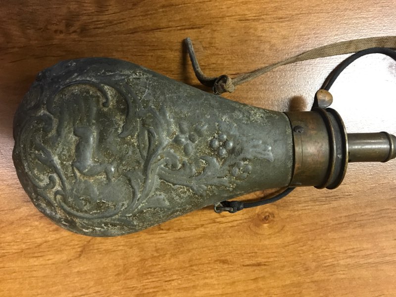

The one I looked at was rusted pretty good, so the barrel didn't budge when I put some force on it. I did not know though that these were loaded from the breech. It also came with a powder flask.
They may not be screw barrels. Im trying to search that down. It appears it may be and it was a means to overcome fitting a tight projectile into a rifled barrel.
